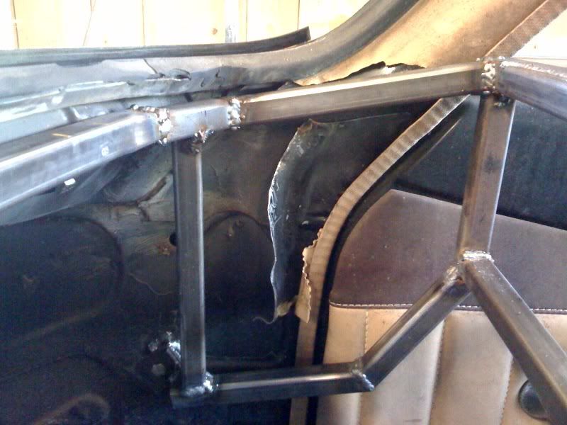

At the rate you're going, you should be through by Tuesday...
 Post subject: Re: LUV II
PostPosted: Sun Jun 14, 2009 5:24 pm
Joined: Sat Jun 13, 2009 5:35 pm
Posts: 97
Cut both off and swap sides. And it looks like a 70 pick up.

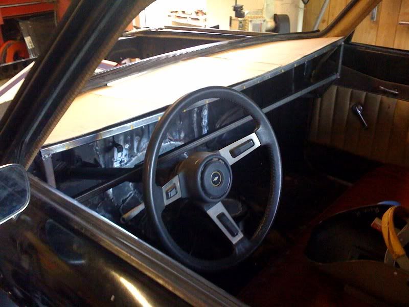

PostPosted: Mon Jun 15, 2009 9:03 pm

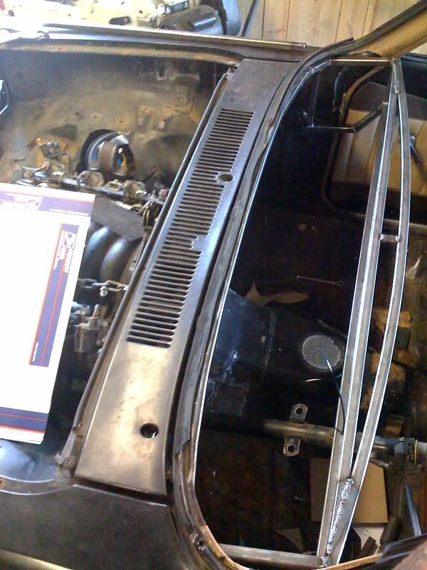

Lookin' good. I did mine sorta the same way with square tubing but didn't have the rounded top and my is just squared off at the bottom.

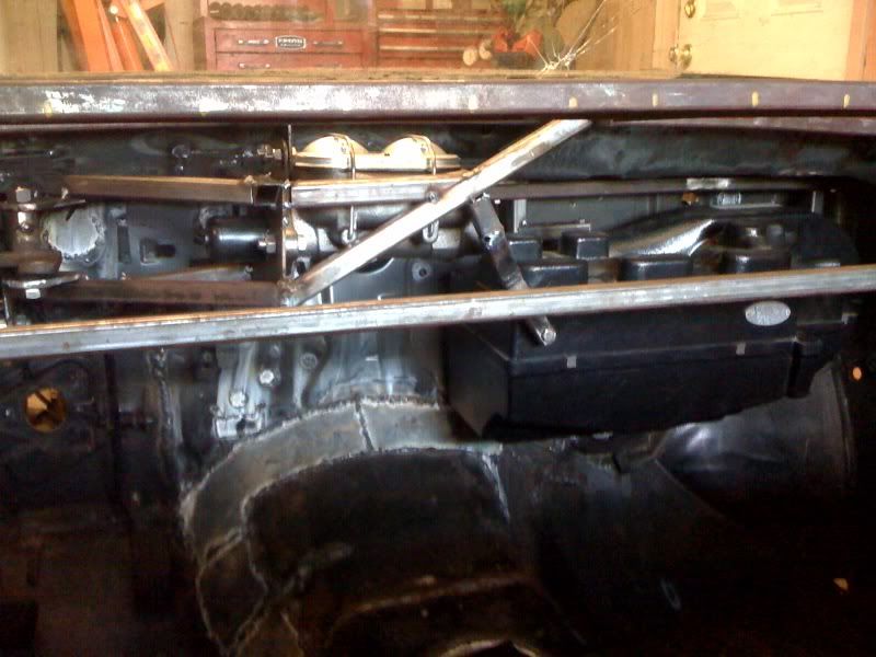

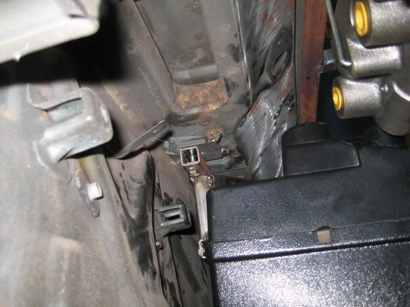

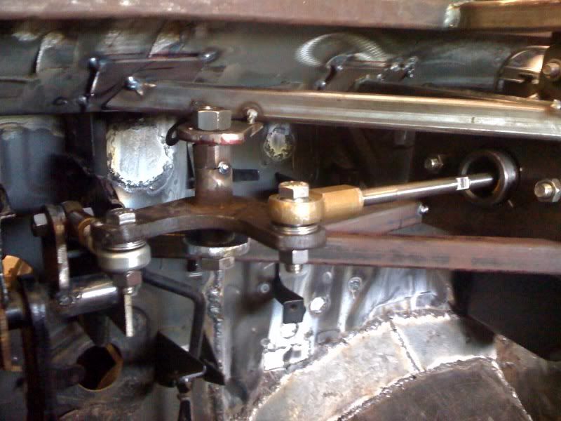

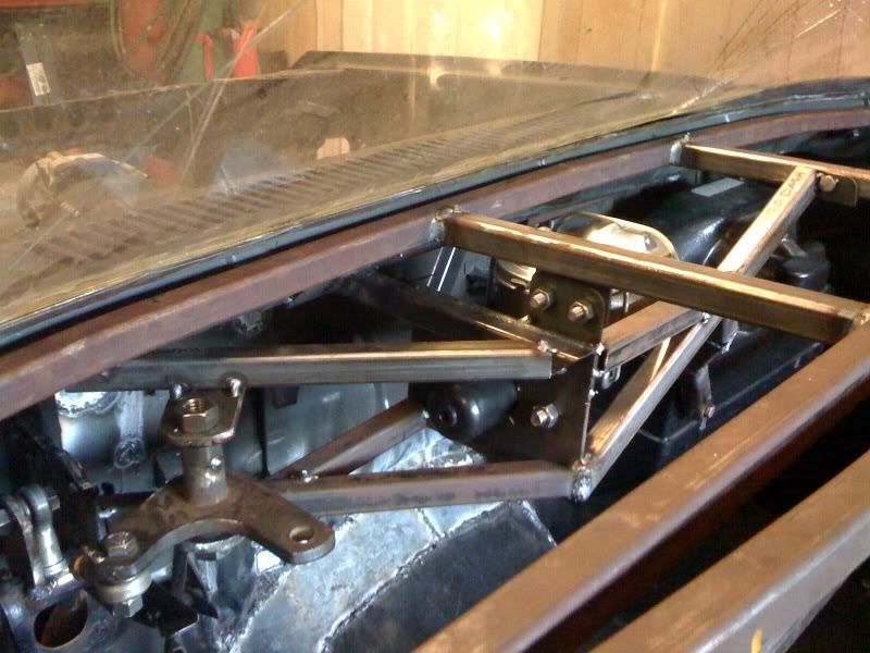

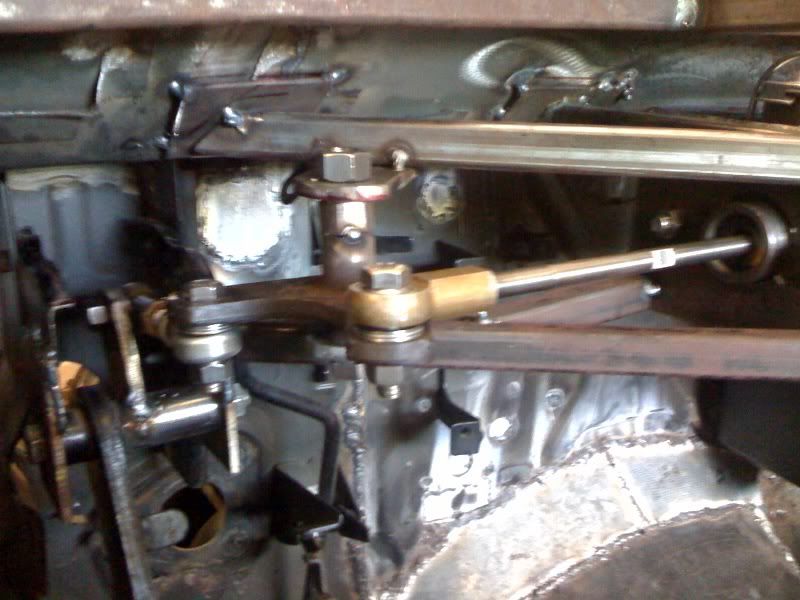

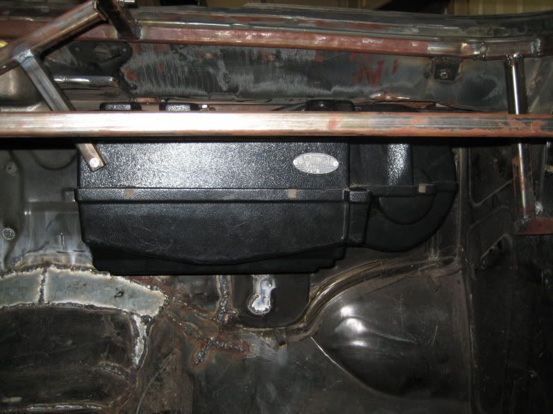

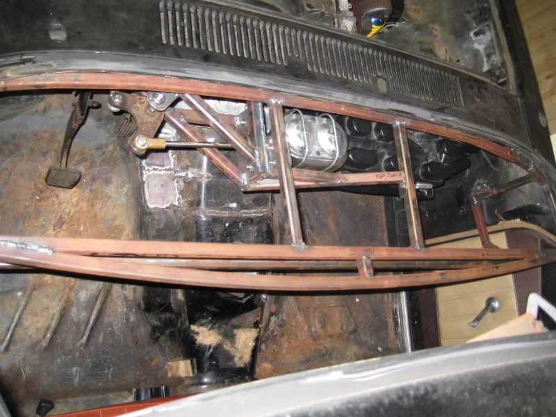

got the brake setup all tacked together.. hopefully it all works out ok... and got ac box mounted

cool setup for the brakes
PostPosted: Thu Jun 18, 2009 3:47 pm
With the master and brake lines in the cab, it sure will make the engine compartment clean. Nice work.
yeah ive seen setups like this for a while, just didn't want to shell out the money for the bracketry..
werd! all i will have coming out of firewall is steering column, heater hoses, ac lines, hood latch cable, throttle cable.. i plan on hiding all brake lines and wiring from firewall.

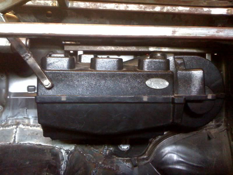

couple more pics.. moved ac box up some, and did some more welding..

Love the idea and the work, but are you going to be able to access the master okay for filling and or bleeding?
PostPosted: Fri Jun 19, 2009 6:30 am
LSX LUV Owner
Posts: 1261
Location: Dickinson, Texas
i positioned it to where its at the center of the dash, and i will have something that looks like a defrost vent that is removable so i can fill the mc..

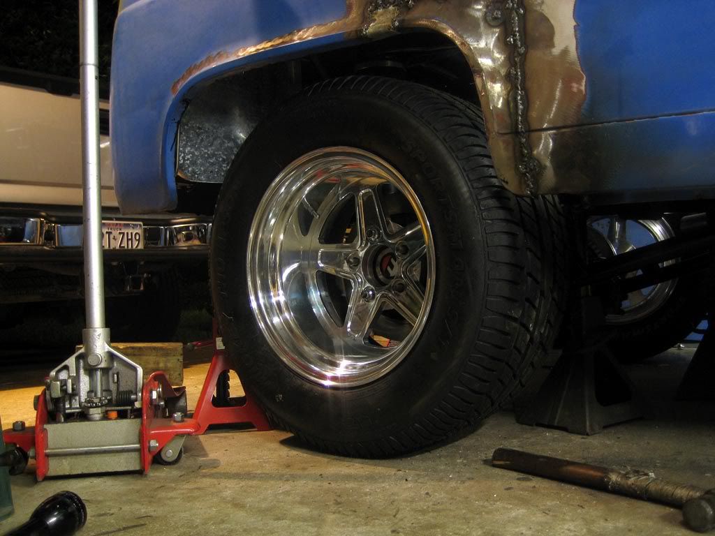

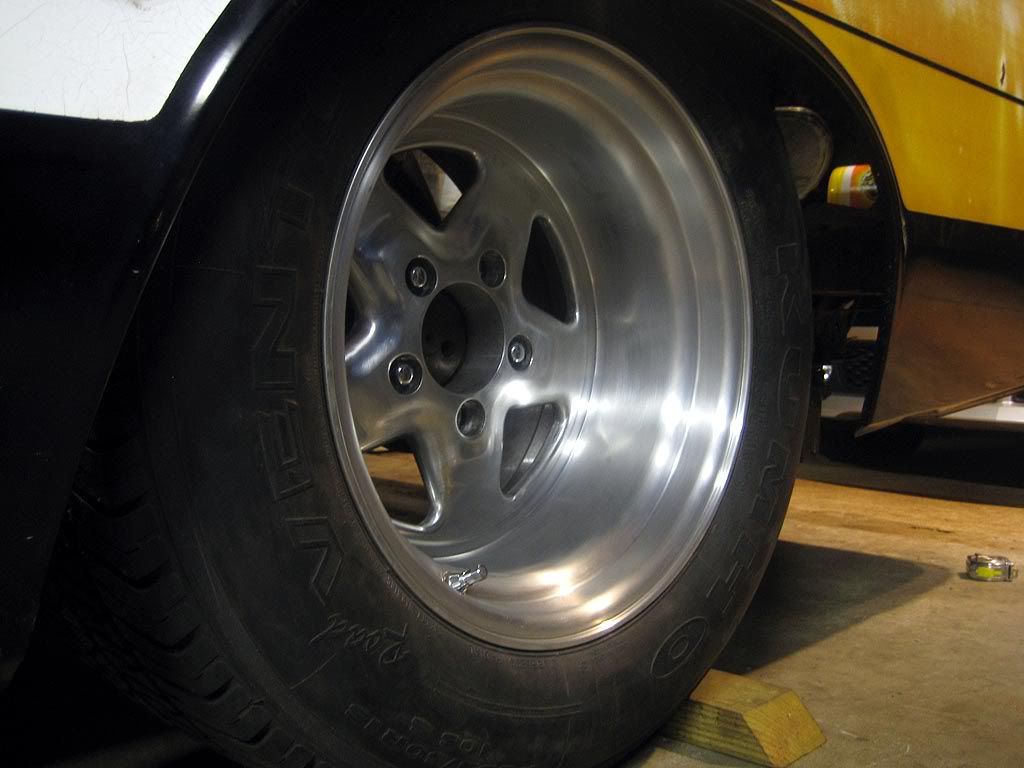

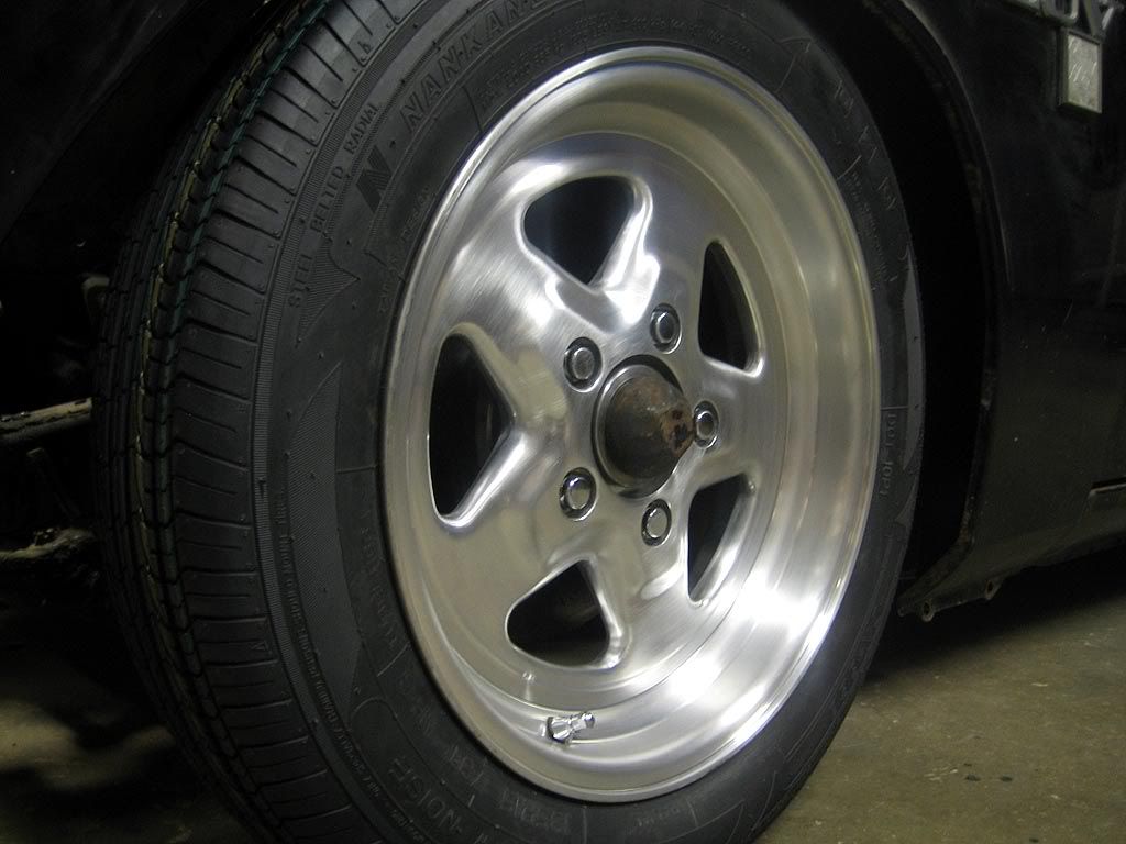

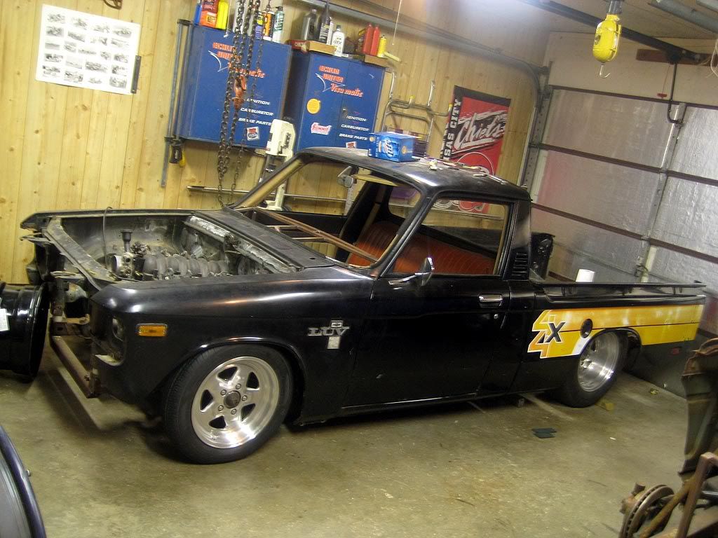

selling/trading bogarts to my dad.. getting his cheapo summit wheels + cash in return.. gonna rock them till truck is running then im buying these..
PostPosted: Thu Jun 25, 2009 8:54 pm
LSX LUV Owner
Posts: 1261

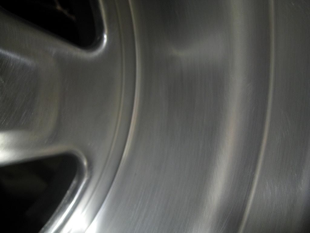

cheapo wheels on.. brushed two of them :haha: . gonna get some rougher scotch brite pads and hit em up some more. i like the look, just think the rougher grit will make it more defined and look better. plus i need to go over them better.. only spent about 10 minutes per wheel..
and bogart on dads car...
if i decide i dont like.. black powder coat, here i come!
