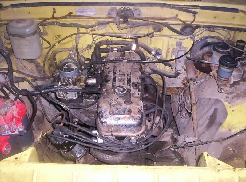

well i got it runnin kinda with the help of lee and some other friends.
the stock carb that came on the truck is a POS. leaks like a sumbitch, so im gonna try lees stock carb from his truck and see if ittl work better. it should, since its was a new re manufactured one.
there is one thing thats bothering me though. when its runnin it has a a pop from the exhaust. what does this mean? im thinkin that the rockers might be a little tight.

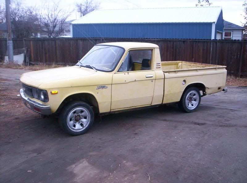

anyways, here a pic of what it looks like as of now...

Most Likely Either Flooding, Vacuum Leaks, The Timming Is A Little Retarded, or Maybe Plugs?
I'd Check The Carb 1st You Said It Leaked Like Crazy

With the leaks you describe in the carb, I'd bet that is where your pop is coming from. You could have excess gas running in the carb, a vac leak around or in the carb, all sorts of crap could be going wrong.

it still has a small pop, but it only when i give it some throttle real fast. this thing runs sooo smooth. even with the stock piece of shit hitachi on it.
there is alot more work to do to this thing though. ive got a feeling that im gonna be dropping the tank to clean it out. theres a fair amount of shit in the tank, i think. i bought a bunch of fuel filters, so i hope that runnin a few tanks of gas though it will clear that up.

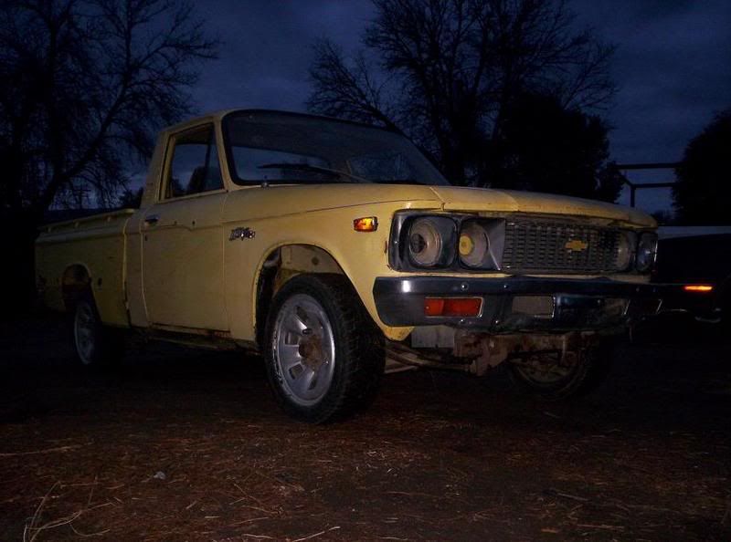

mkay, i got all the lights workin now. im gonna get a new headlight tommorow, and then itll be good to go. im gonna have to get this thing registered and insure this week. the pup is startin to take a crap on me now.
heres some pics of it as of tonite...
i still need to do some small stuff to it like adjusting the clutch and bleeding the brakes. im gonna be parking the pup for the winter. i noticed that it has a small knock, so i dont wanna run it alot more so i can keep the bottom end together. ill prolly rob the weber off it to put of the luv. the hitachi isnt cuttin it.
