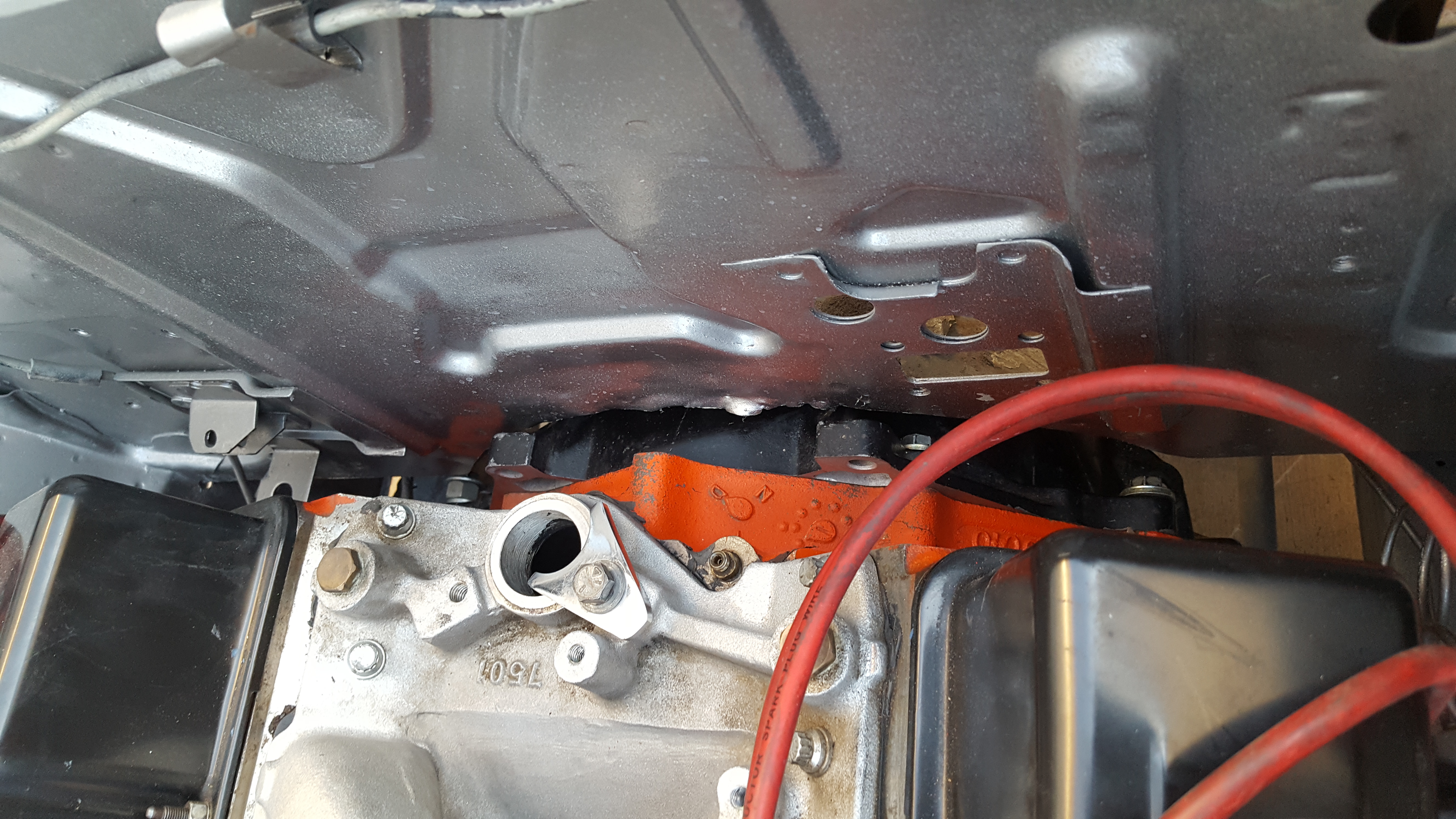

The trans mount on the 2004R landed right on top of the cross member. Fantastic! I did make a small access hole in the floor to see whats going on :lol:

I don't have my engine mount or motor plate yet, but it looks like the bell housing bolts and everything else clears!
