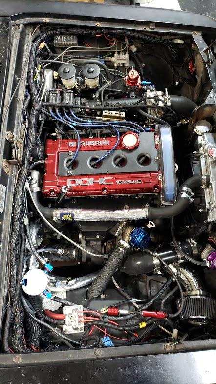

Long over due update.
Well the engine fits with the trans. Just need to add the trans bracket, then I can start peicing the coolant system. LUVLEE is coming together more n more.
Got a Honda radiator with fan and shroud installed. Also a small intercooler for the tiny horsepower 350hp installed. Intake manifold installed. Missing brake master cylinder until I get it bench bled. Working on centering trans mount, thanks Derrick for welding an extension. And working on clocking the turbo to make it work. Thanks Jusmx141 fixed my stripped bolt holes. More to come!

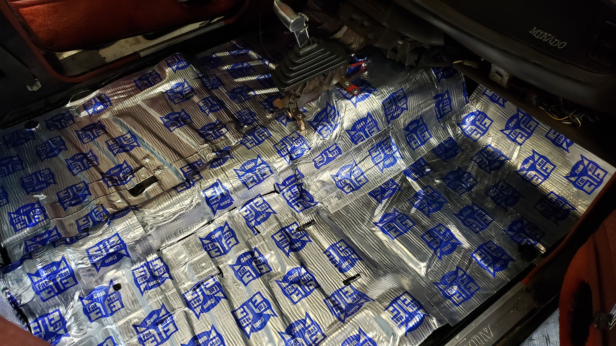

Updates from the last 4 months: long haul to the Dyno, working on the floor pans, painted floor pans, added dynamat.
Kinda disappointed in the HP #s (made 262hp), I wanted 300hp+ to the wheels. Small intercooler stopped it from happening, High Intake temps which caused some small knock, turbo is not very efficient.
New intercooler coming soon... Also picked up a 1984 trooper sway bar to reduce the sway a little bit. Carpet does not look like its going to fit well, I think its made for a later model LUV (ebay carpet), but will make it work.
