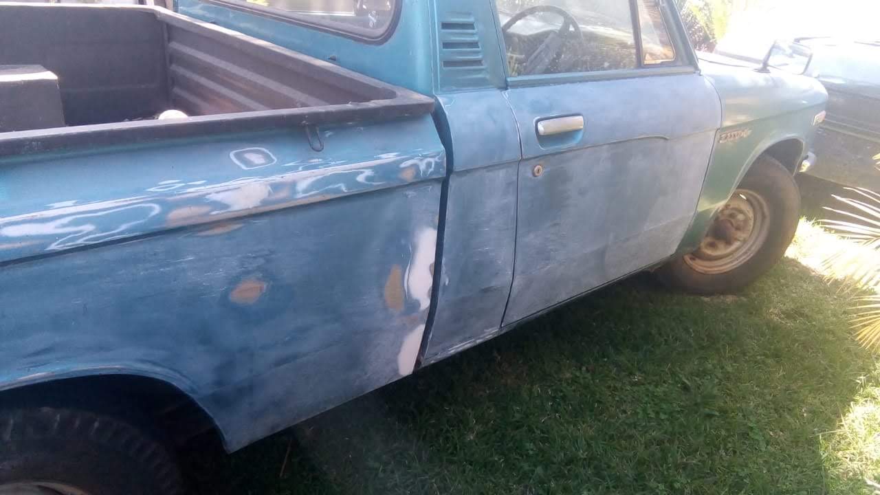

Bought a '75 luv off a farm here in sunny South Africa.
She was in a bit of a state when I received her, but not so bad as not to want to continue with the project.
There was some surface rust, the bed had a few rust rot spots, plenty of dents and a smurf covered interior.
The plan was to fix this truck and use it as a daily driver.

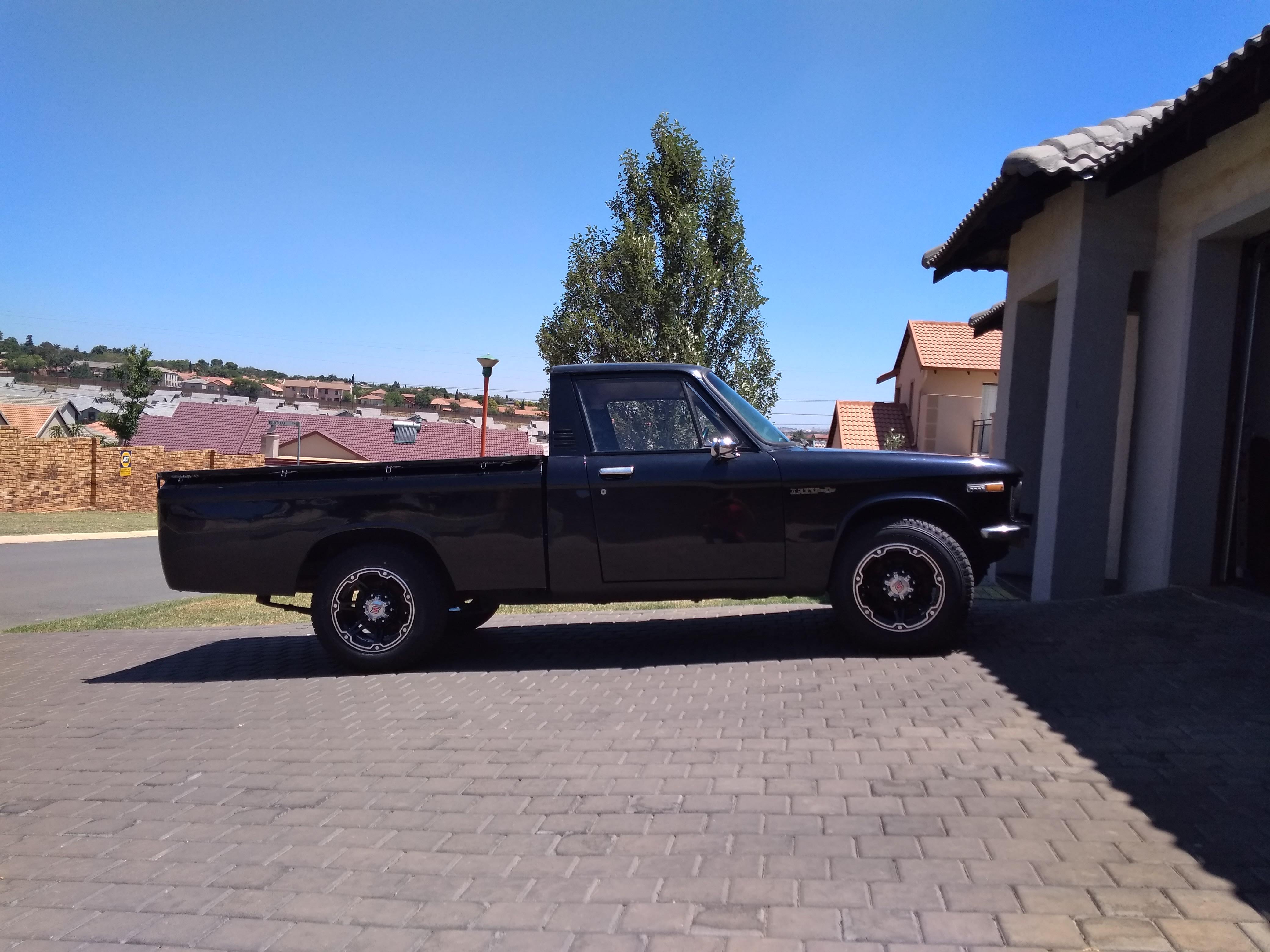

Finally sprayed and new wheels, and fantastic interior also done!

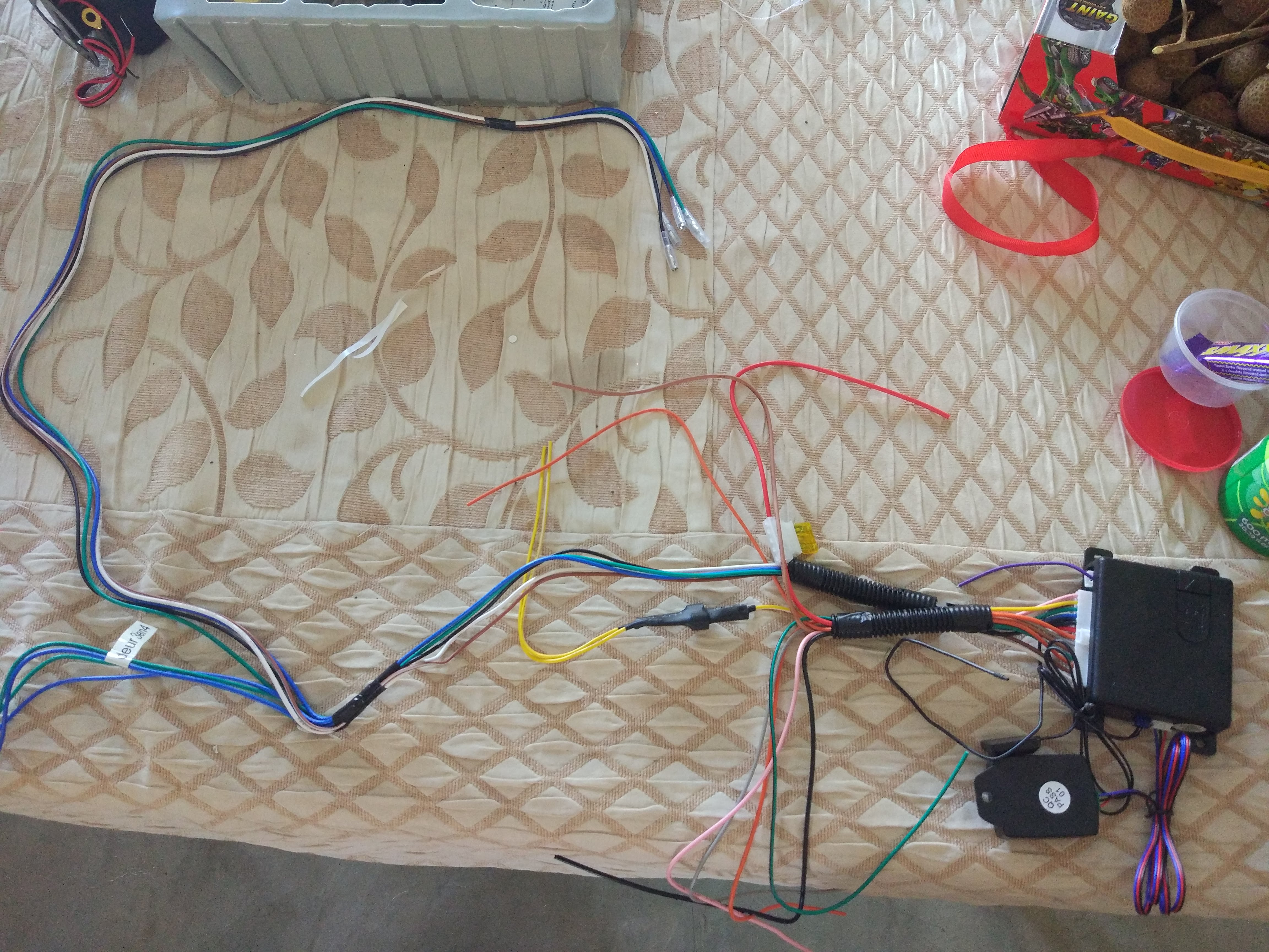

Its been ages since I posted the updates on the truck. Luckily google saves all of our photo's these days. Good or bad, the jury is still out.
So for the more modern niceties I installed an alarm and central locking system into the luv. Cost about $50, can you believe it?
Finding where everything goes was a bit daunting at first, but once you slowly layout every wire, it was actually quite easy.
File comment: Instruction manual saved my bacon!!!
File comment: Initial layout
File comment: Placing the cables where they are supposed to go.
