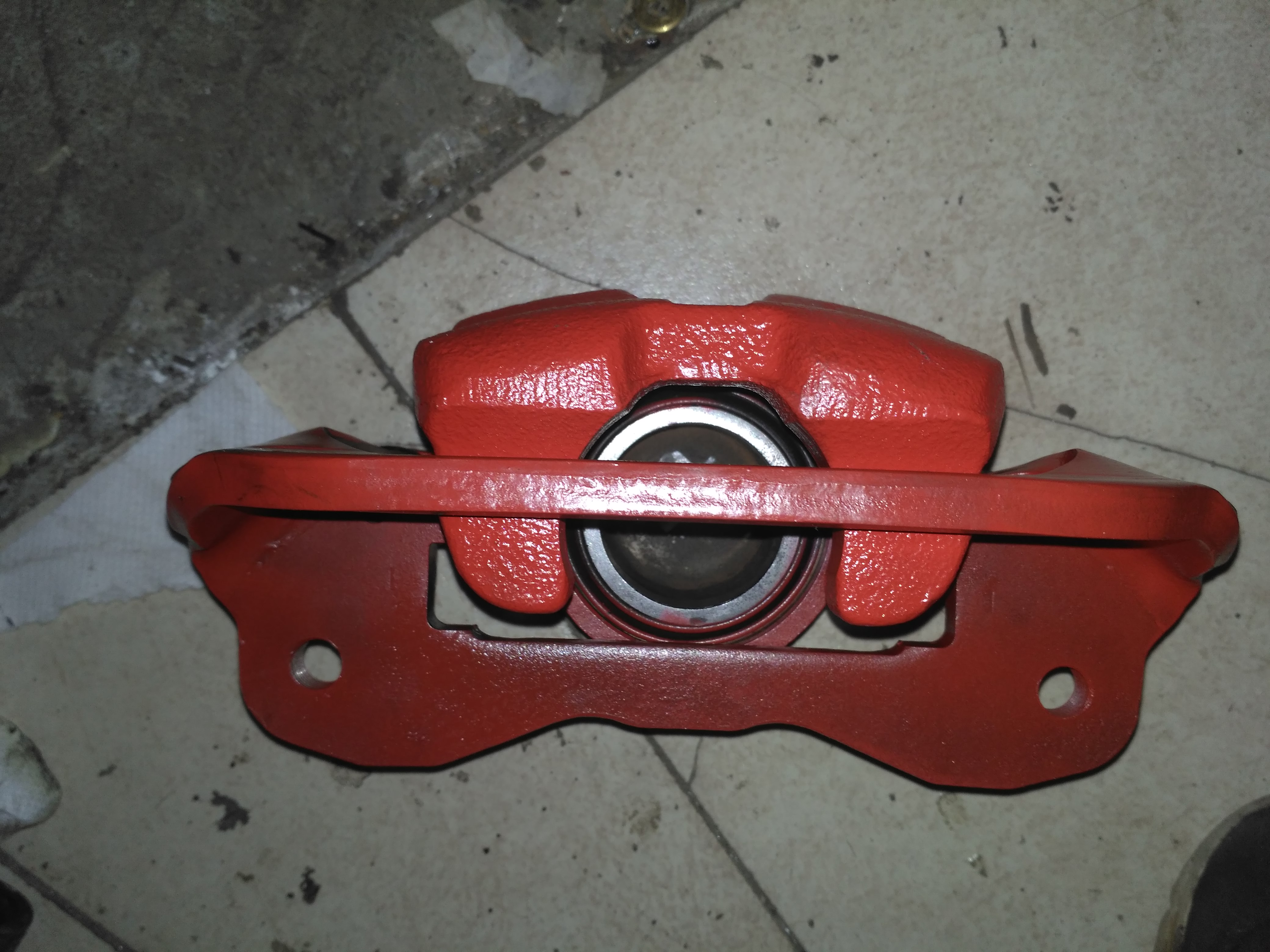

Managed to found a front brake set of a 1981 pup.Cleaned everything from rust and rebuild the calipers.Just got to put them on.
Any ideas how can i get the ball joints from the old arm with hurting them?

So i used i ball joint puller and safely removed the joints from the old arm.
The answer finally is that you can use the pup front brakes with the spindles on the first luv.
