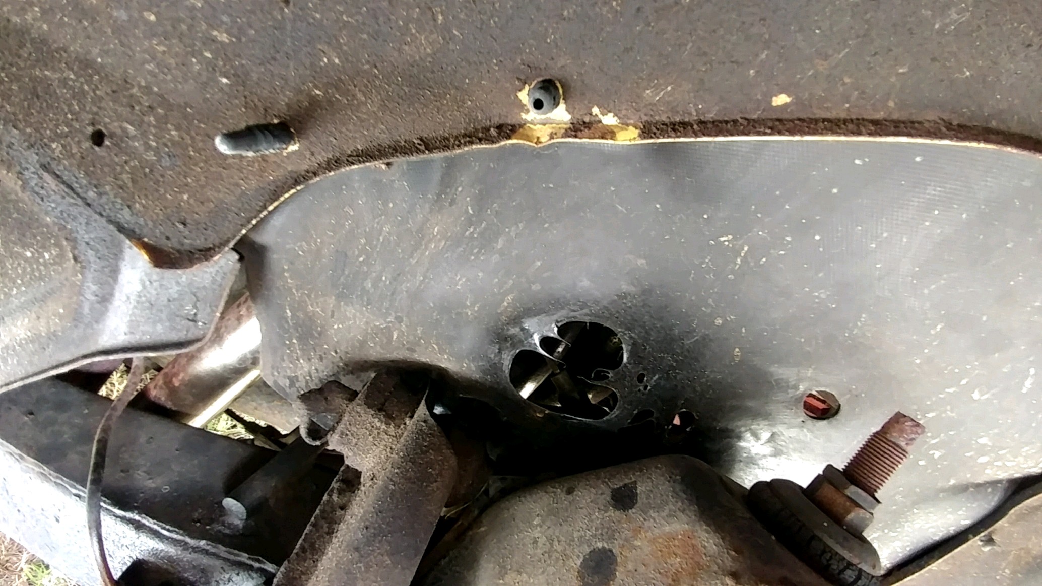

PostPosted: Tue Feb 12, 2019 9:37 pm
Posts: 103
I went to work on the passenger side breaks, and noticed the mud control flap on the inner fender was melted. I am guessing it gets a little hot down there.
