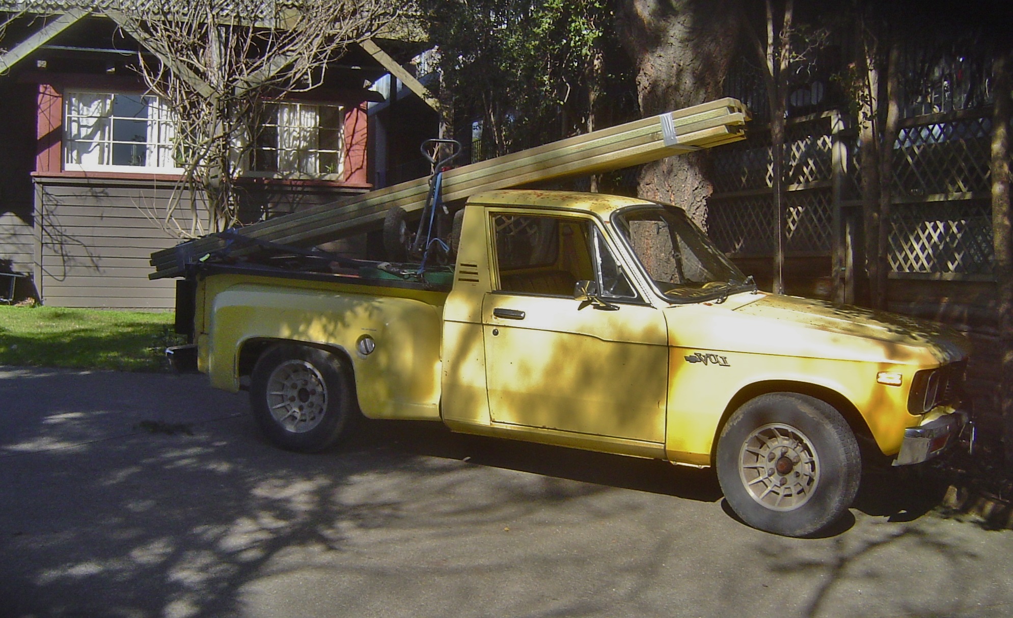

mattp_65 wrote:
Great Job! I am assuming Stock rear diff, but what are your specs on tires and wheels? also 3" suspension drop on blocks?
Thanks its been needing some attention & smog next moth so muffler had to be addressed, & 1 thing lead to another biut most was planned a while back.
Yes, mostly stock parts on this Luv. tire , wheel specks are nothing special picked up these path finders wheels at Pick N Pull for my 75 Luv yrs ago, tires 195 75 R14. I think they are a pretty standard sm tire size .....had some turbine rims on there for a while. tires on them were splitting & bald so was using these as they had good tread left for now & I will be putting turbine rims back on when they get some detailing . They were a little wider tire...& rim ?...working on the heater core & been cleaning up all those rust freckles on the hood & rattle can paint for now

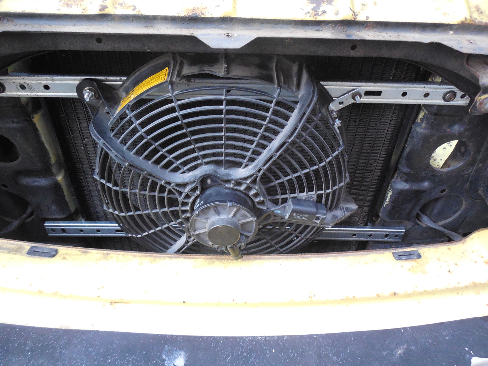

Next up radiator fan and some new head lights and take care of some more rust spots o the under side of the hood

File comment: all new lights and well you can't even see the fan in there now
PostPosted: Sun Oct 29, 2017 1:48 am
Posts: 607
so after all this fun i've been having w/ MS SUNSHINE it was time to take her out & enjoy a trip to TAHOE
to see my son before snow sets in up there & apparently i left in time as that night they got 6" on snow.
I got 19.58 mpg on the way up w/ a load of fire wood & 24.14 on the way back...21.xx average.....Over 375 miles
and that new fan sure came in handy going up that mountain.
