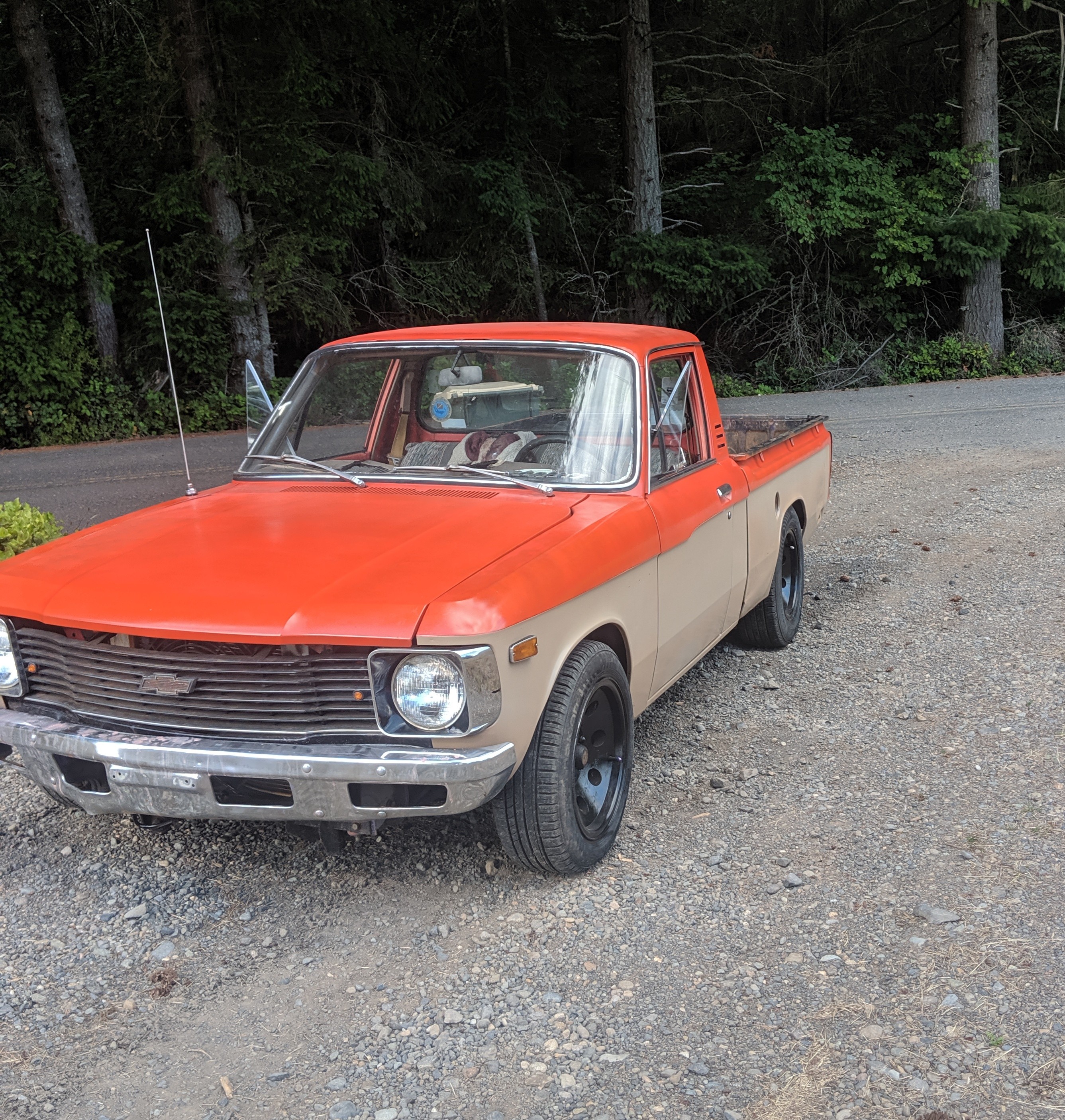

been a minute since this was updated. figured id post a before and after. luv is sitting outside waiting for me to rebuild the carb. been doing small things to it here and there. it has a new fuel system with a 20-gallon fuel cell in the bed and all new lines, wheels and tires, some goodies from Lokar and some other small bs. id like to do a 5-speed swap as id probably drive it more but who knows. college eats up all my time
File comment: 7 years later
File comment: day 1
