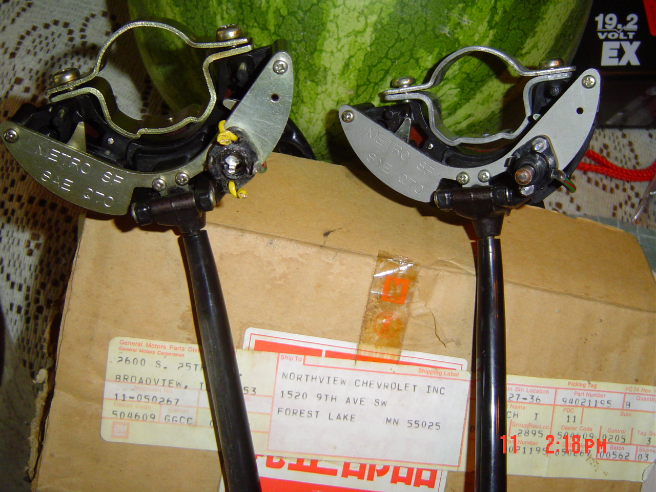

I replaced the spring on the horn button (switch on left) after I installed the switch it started to smoke and the plastic button holder melted. I got a new one and after a month it failed. The same thing happened, the spring collapsed. I replaced the spring on the new one and the spring collapsed again when I tried the horn. The plastic holder got hot, but did not melt. Has anyone had this happen to them.

You have a short somewhere if it's melting buttons like that. I'm amazed that a fuse to protect this hasn't blown. This hasn't happened to me with my LUV yet. I would start tracing wires starting at the steering wheel, to the fuse box, to the horn. I hate electrical issues, my weakest point admittedly. I can look up a procedure for you and copy it tomorrow if I'm not working. It's a good way to chase a short.

To burn like that you have to be shorting 12 volts directly to ground. Either it is misswired at the horn or the horn itself is shorted out internally. If a Mikado it has a horn relay and two horns, if not it has one horn, no relay.

Not a Mikado. I installed an after market horn button under the dash so I can have a horn. That horn button/switch seems to work without any problems. I tied it into the plug from the old switch at the steering column.

I think the horn is a ground side switch. If it is, your problem might be that you have the horn switch hooked up to the wrong side of the horn...

I got it working. I added a relay just like the wiring diagram for the Mikado. The power goes through the relay straight to the horn. The horn switch activates the relay only. Now just minimal power through the horn switch on the steering column.

Cool. That sounds much safer. The horn(s) require a lot of amperage which is why they are almost always behind a relay.
