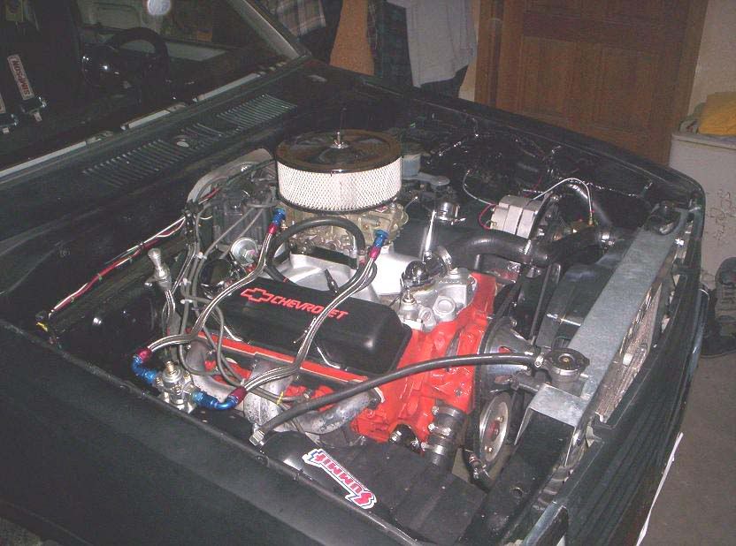

Here's mine I have put on a homemade shroud since then. The temp. on mine stays around 190 it goes up to 210 in really heavy traffic. I got a 400 in front of a super T-10 and a 22x19 griffin radiator.
http://forums.luvtruck.com/viewtopic.php?t=8464

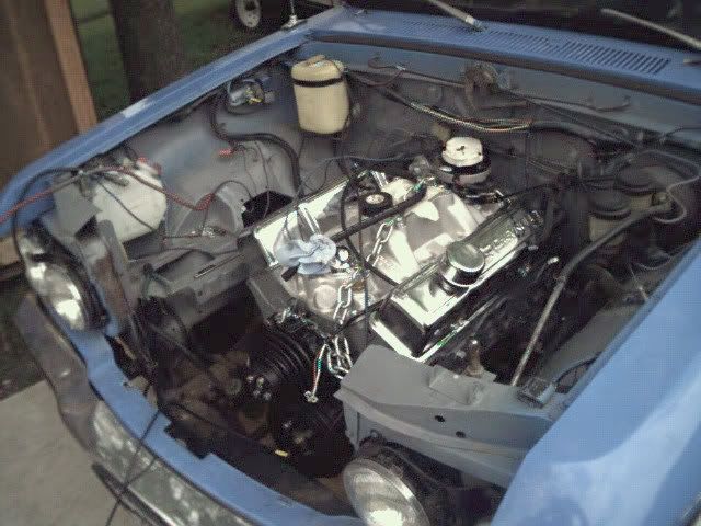

Here's pics of mine. Only difference now is that I have the electric fan on the front of the radiator.
http://forums.luvtruck.com/viewtopic.php?t=10180

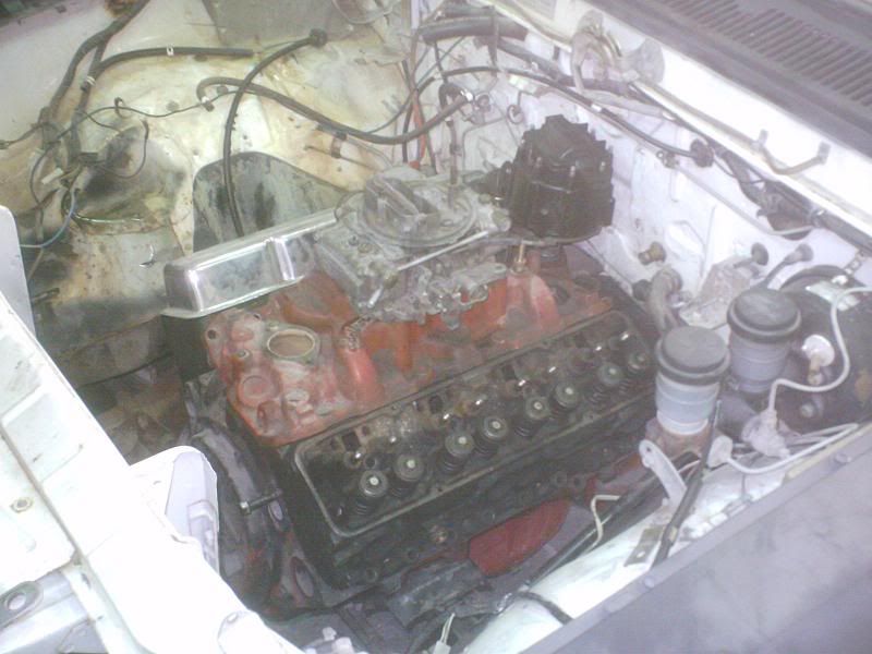

PostPosted: Fri Jun 16, 2006 12:52 pm
Posts: 2013

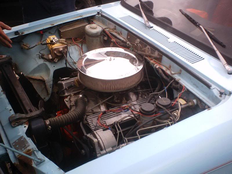

Here's a pic of the motor located in the frame. Hooker mounts and headers were used.

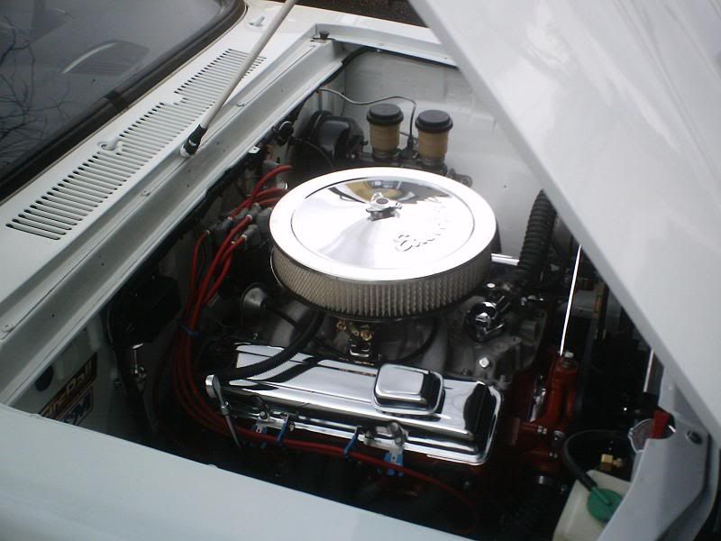

heres a pic of ezekiels truck withthe mock up motor in it.
this is one of peeroys 78.
one of ricks truck
chets truck
and codys truck

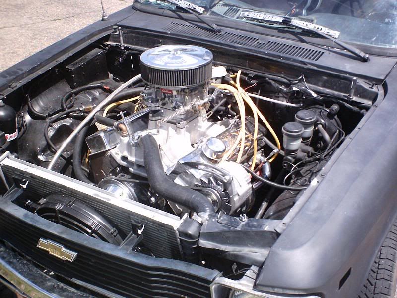

Heres a couple of mine.
PostPosted: Sat Jun 17, 2006 12:25 pm
Mine in mock up.

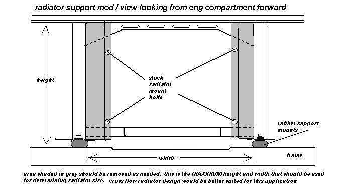

i mean to find out where to cut the radiator support to fit the new aluminum radiator?and what radiator will work good so i can drive it more thin 300yrs with out it geting way up there i have a stock radiator in it naw and if i turn the fan on 1st it will say about 200 or so but i het the gas and it will jump up fast...do i need a tranny cooler too?
PostPosted: Wed Jun 21, 2006 3:29 pm
Posts: 2013
Here's a basic drawing to go by. With a V-8, you'll need to either create some room up underneath the support top. Or fabricate a cutout section that you can remove to make removing the radiator or engine easier. Take a look at LUVINIT's pics. He cut out the support just enough to fit the radiator. I wish i had the top section from my truck still. But it's long gone and i would have reworked it to be made removeable.
The stock radiator cant handle the cooling of a V-8 so forget about using it. Modifying a stock unit to work isn't practical because you'll spend too much money and it wont work as well as an aluminum unit.
A trans cooler is a must if you want your transmission to survive. I had my old trans looped off for a long time and i was lucky it held up like it did. Get a cooler... Pulling the motor to remove a bad trans because you didn't install a trans cooler is a waste of time and money. And once you get the new trans back in and everything else installed, you'll have to install a cooler to save the new trans.
