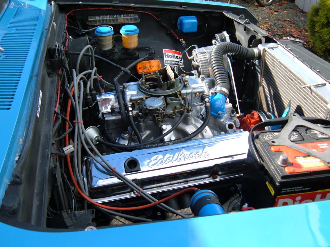

Got the luv ideling today and I must say it's a BEAST :twisted: (it has 3 foot pipes for exhaust)I was suprized how easily all the wiring and other stuff converted over but I have some concerns.My first ? is can the stock harness handle the extra amps from the V8's Alt?I have a 60 amp but Iam worried Im going to burn it up.Another problem I am having is Iam using the stock coil and it gets pretty hot after I turn it off.I think it might not have enough windings but I'm not sure.I also just connected the main fuel line to the carb but I left the others disconnected so what do I do with them?About the engine it is a 400 small block with a holley intake and 750 carb with a weber metering plate.For a trans it is a '62 Borg Warner T-10 with a hydralic throwout bearing and a hurst indy shifter.
Here's a old pic after I got the motor in it.I'll post some new one's very soon...

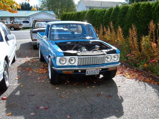

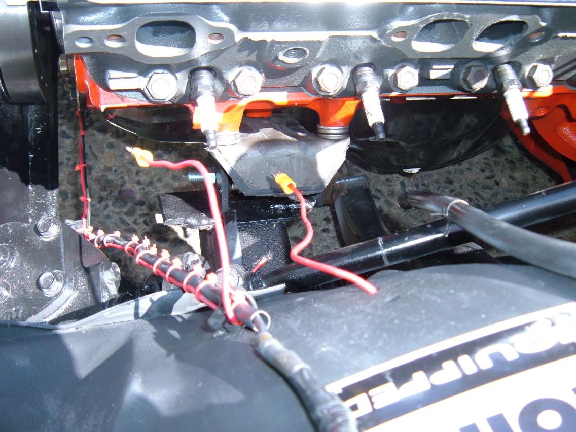

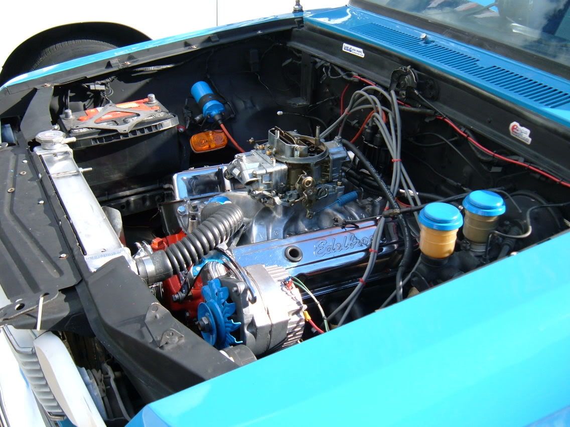

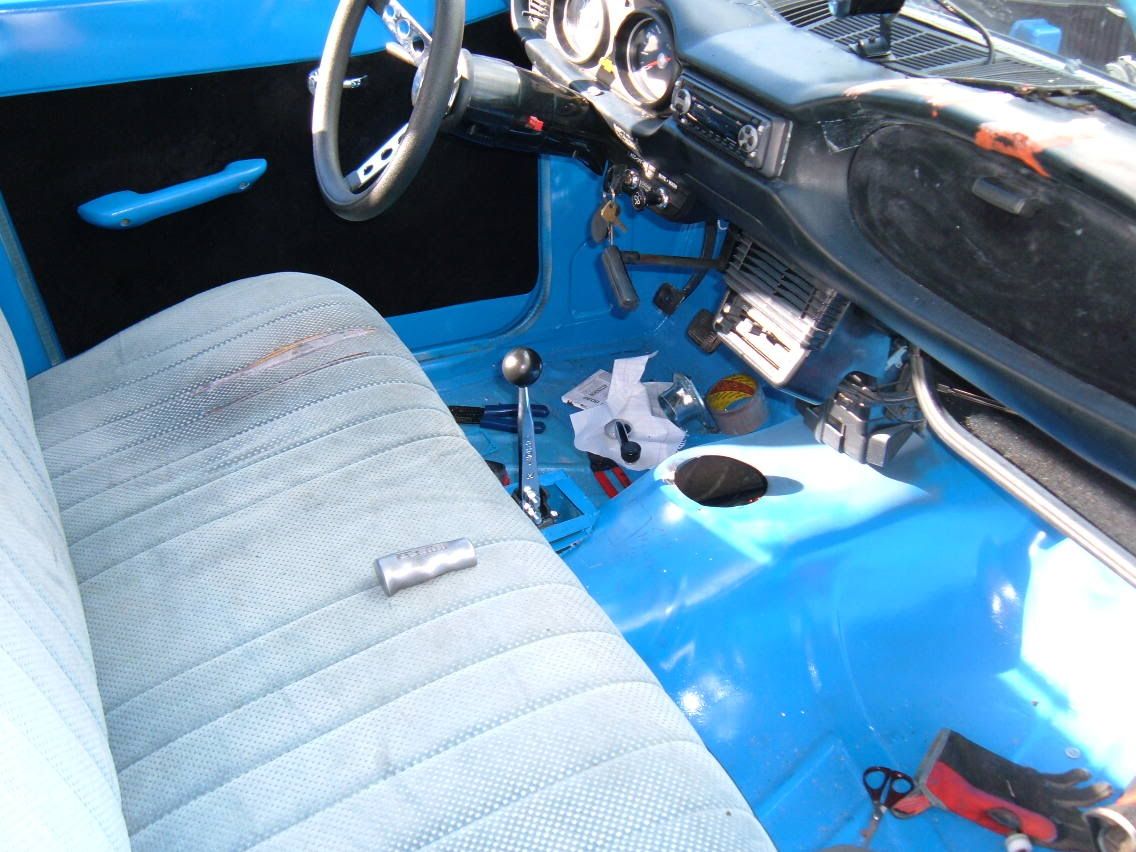

Heres some pics I took today.

looks freakin boss man!! what are you doin for exhaust? blockhuggers?
anyways, looks great man!!

Thanks! For exhaust I m using patriot block huggers with three foot 2.5'' pipes.Pretty soon I going to put those new force mufflers on it.But for right now I just want to rumble some rice with the three footers. :lol:

i like how that shifter is in your truck. right up close and personal!!

Lol.After I got it in I didn't think it would work but it fells perty good.I can lay back in the seat and still pull through all the gears.
