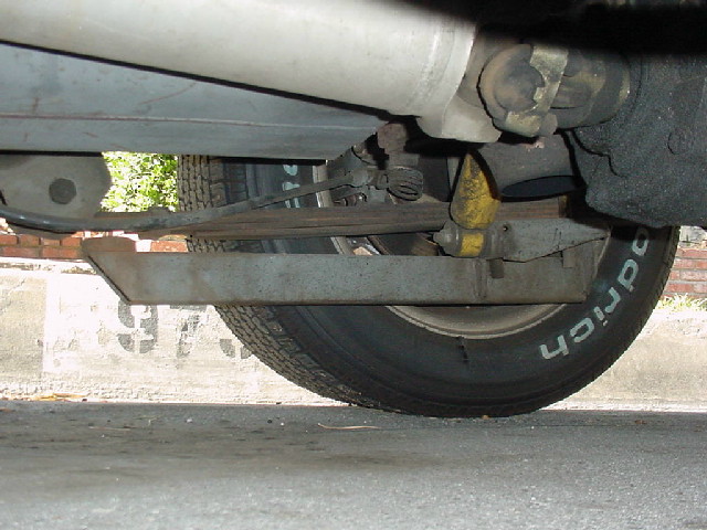

Traction bars.

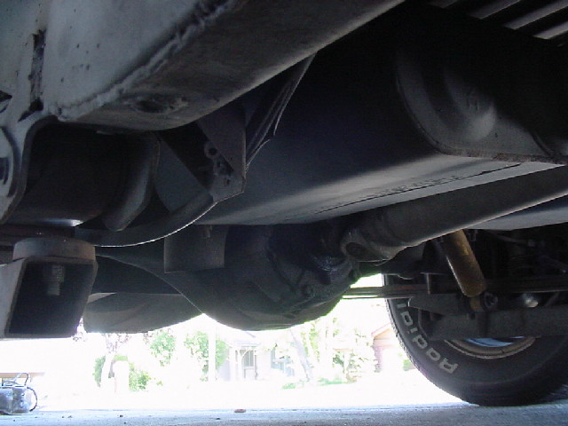

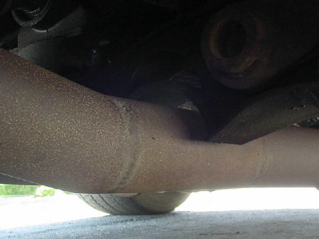

Since I was digging up old pictures, here are some of the notches in the frame for the dual 3" exhaust.

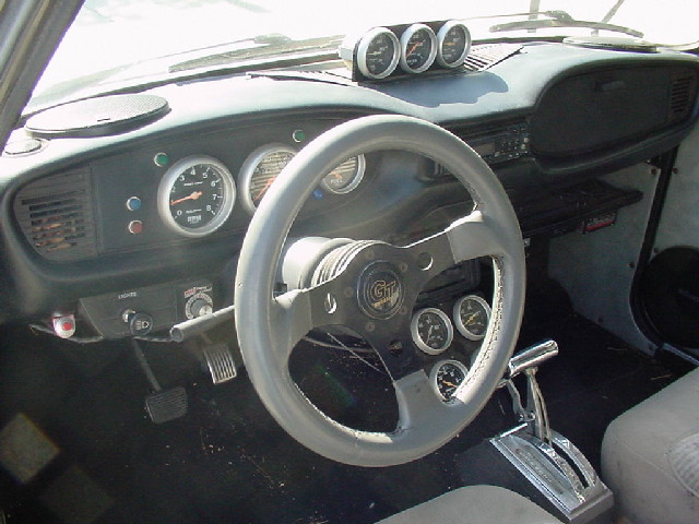

Interior, I was bored at the time.

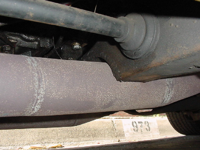

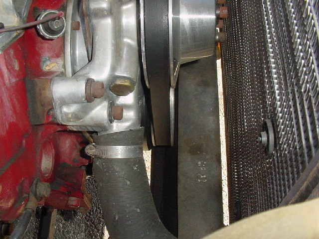

Front pulley clearance (or lack of)

now that's what you call a exhaust 8O . interior looks great :D

i just noticed your dash :onfire: nice!!

Ben, I can't get over how great your interior looks, man.

Ya, I have some TLC in the interior. I happened to get one of the last dash's from Chevy which is why mine isn't all cracked.
I should take a few more shots of the inside. I made lots of panels to cover some of the not-so-good looking areas down by your feet and behind the seats. I also have a lot of work into the stereo install. I'll have to snap a few more shots, maybe it'll give someone a few ideas about how to improve the interior above the stock look.

:snipersmile: :snipersmile: :snipersmile: :snipersmile: i'll kill you for that dash. lol. give us some info about the interior so everybodys elses will look that good

here you go ben i`ll give you something else to fix on your truck. another tech issue .the front of the traction bars is supposed to have a strap or u bolt over the top of the leaf spring to prevent the front of the traction bar from hitting the track. i guess what they are worried about is getting to much wrap up or i guess down would be better way to say it, if you suddenly back off the gas or have to brake hard to prevent the axle from twisting to far the other way. and causing an end over end flip when the bars dig in.since you don`t have anything better to do. he he later terry :twisted:

COOL BARS JUST GLAD I DONT HAVE TO HAVE THEM ON MINE LOL J/K

I have mids and tweets in my kickpanels.
yeah those look too fugly without something covering them or speakers in them.
nice interior by the way.
it is layed out nicely.

hey ben. i just noticed the little red button to the left of your wheel. whats that for?
PostPosted: Fri Jun 06, 2003 11:15 am
Gas tank door opener.

Gas tank door opener... big red button... i dont think they go together vary well, J/K :lol:
If you get a Nitrous set up you should get a military style missle togle switch for it thats labeled burn baby burn. Like in the GT-500 in Gone in 60 Seconds :lol: 8)
