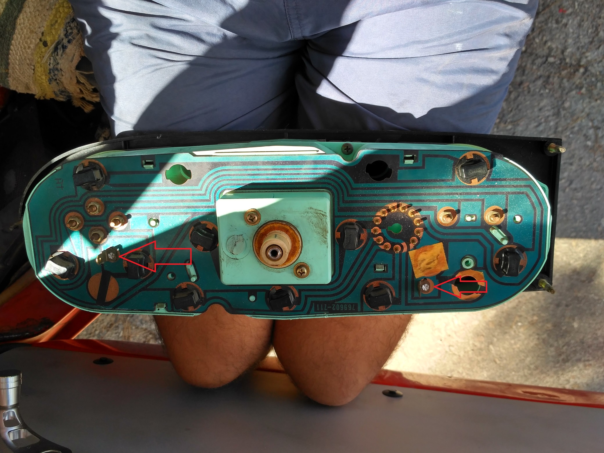

Next thing is the gauges,i ve noticed 2 terminals in the back(check the photo).But there is only one wire that plugs in the one behind the fuel gauge and i think that is for the temperature. :? Anybody knows what is the other for?
The brake light on the dash what is it for?Is it for the e-brake?Is there a switch somewhere?I remeber mine working but now is dead.(checked the bulb and it is ok)

So your blower is always working at low speed? 8O Can t understand why the designed it that way.
The blue wire on mine is also on the air.
At the back of the dash i got 2 wires that don t plug anywhere as at the back of the glove box there is a 4 cable conector on the air.
Maybe someone with the newer gauges can help me.

Take a peek under there.... The switch is in line w/ the handle you pull & release, its very simple set up.
about them 2 terminals on yours .... I haven't looked behind my 80 Luv gauges yet its still all together.
but pop that unit open and look inside it, sure will have some clue to inform you
On my 1979 the one behind the fuel gauge is for the oil light. It's a yellow and white wire, should be able to test it by hooking up the cluster, removing the sensor clip from the oil sender & grounding it out.
That's the one for the temperature, should be a black wire with a yellow stripe & you can test it the same way - remove the clip on from the sensor under the manifold and ground it & heat light should come on.
Yep, for the e-brake. Not required for the truck to run, but nice to have. The switch is held down by a little metal tab on the ebrake handle down by the firewall, when the ebrake is pulled the switch closes. pic attached
