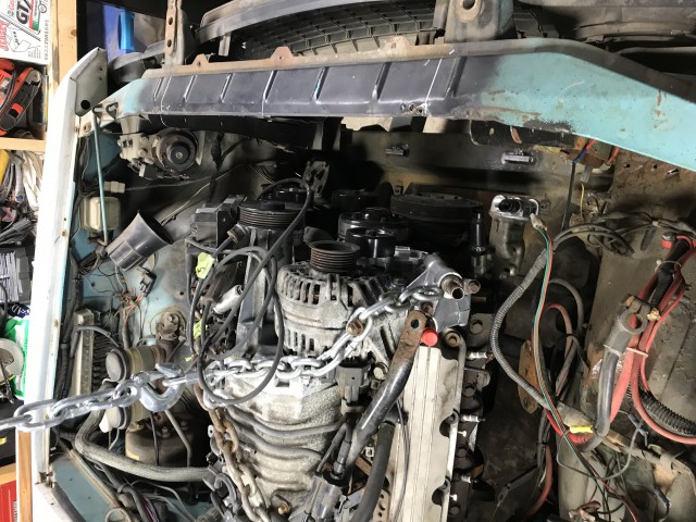

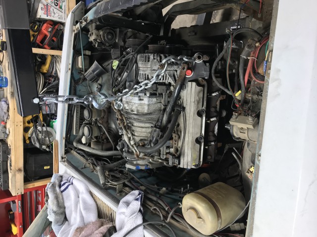

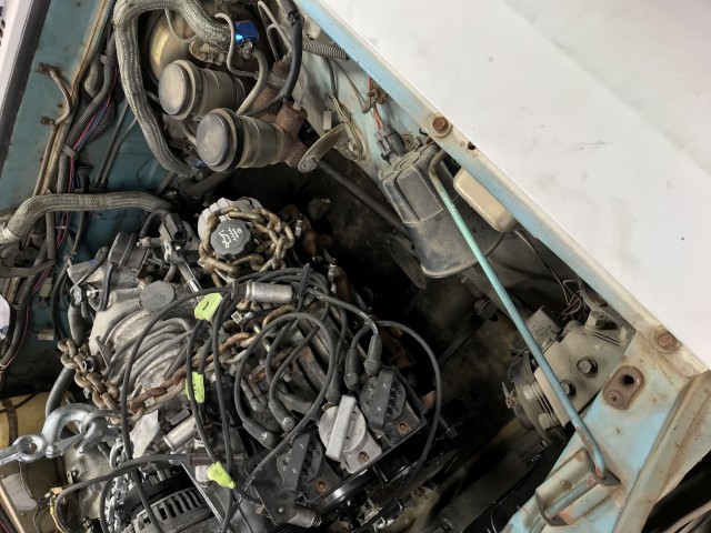

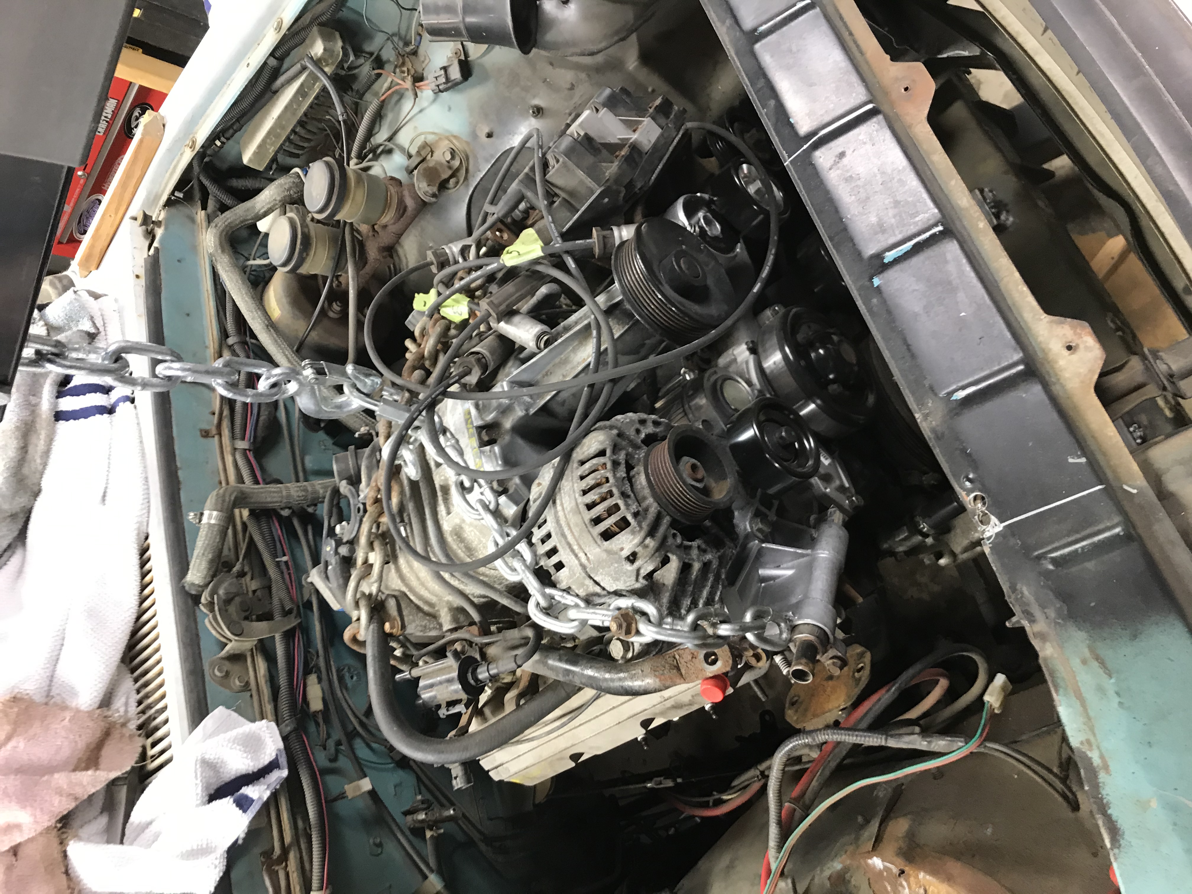

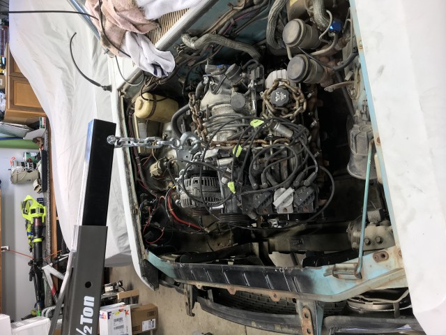

Made some progress tonight. I think I’ll have to modify the lower bolted in crossmember so the engine can sit lower but it’s looking really good so far

How are you planning on dealing with the rear-facing throttle inlet?

Also - that flywheel off the Camaro's 2.8 is balanced differently. Have you considered that?

Last question...lol, how are you dealing with not having a need for a power steering pump? I'm not sure there's a PS delete pulley available for that particular accessory drive. I think if it were me I'd just gut the original pump, grease the bearings and put it in place and use it as an idler.

Rear facing throttle body will be relocated with some fab work. The fly wheel from a 3.8 is the same p/n for all 3.8l super charged or NA. Power steering is delete-able had to use the belts with out AC and PS. Waiting on the V6 motor mounts as they are on back order. Should be here in a few weeks and should have it sitting in place in a month or so.
