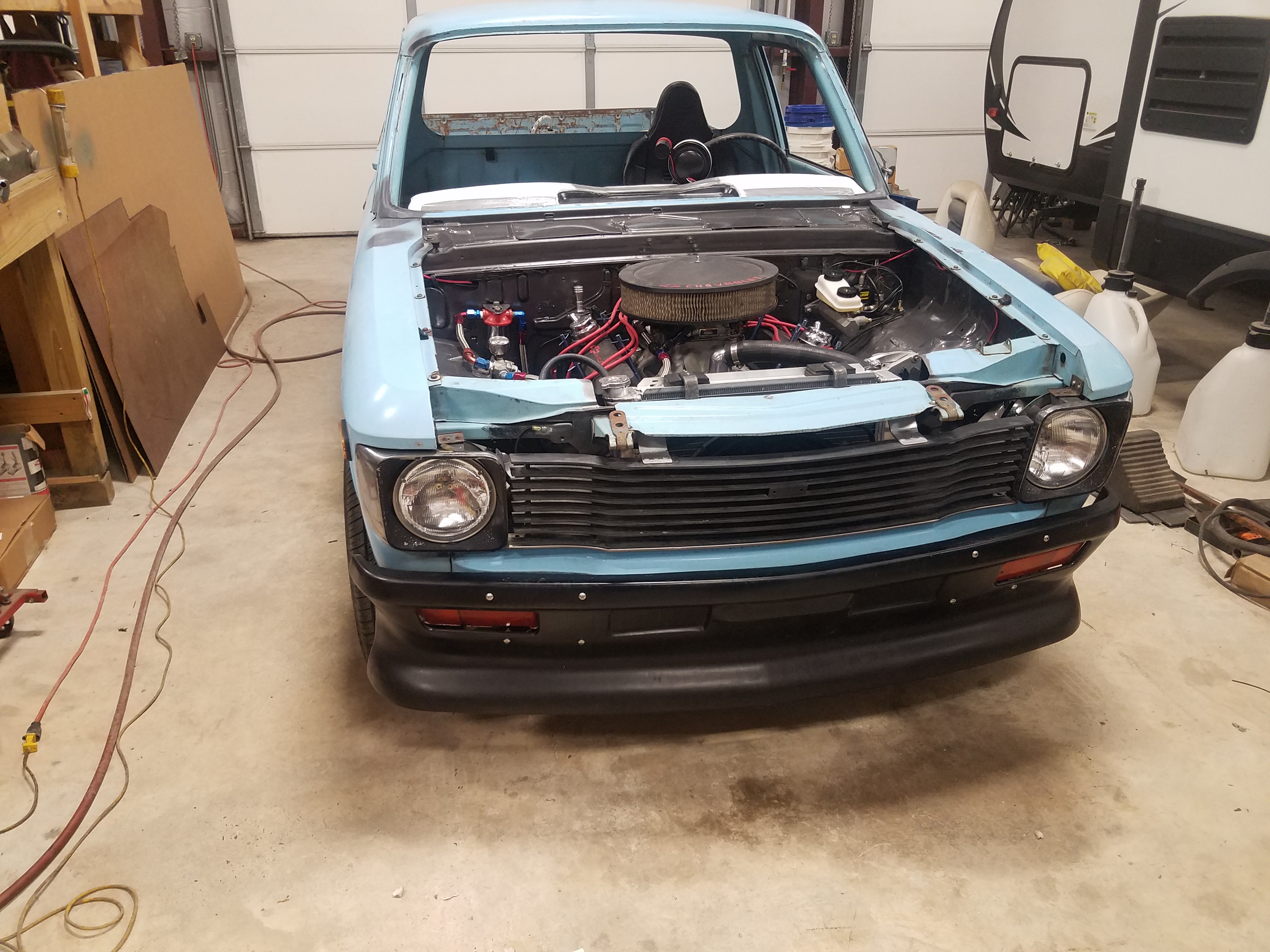

I have driven this truck twice. Just down the road and back Found a problem or two and corrected them. The biggest one involved firing order (as I didn't build this motor) it had a 4/7 swap cam. Swapped wires and BAM this thing will fly. Scrubbed it down to clean it up and got it ready to install the roll cage and glass then testing will begin!

That’s a clean looking luv.
Where did you get that front bumper from??
