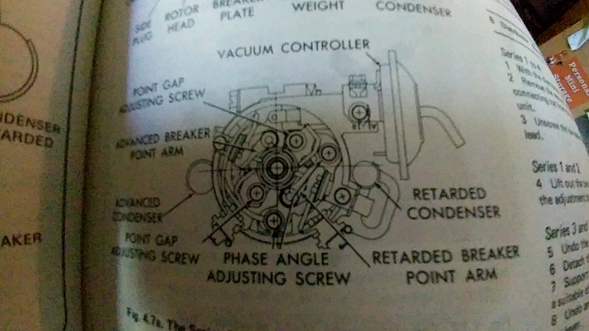

some distributor pictures.

points gap for dual points .018 to .022
series 3 and 4 .018 to .022
series 5 and 6 .016 to .020

have the single points situation here. will attempt efforts you've suggested. by the way, points should be gapped at the 'high point', correct?
thanks again
PostPosted: Thu Mar 28, 2019 9:58 am
Correct
