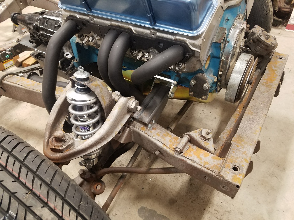

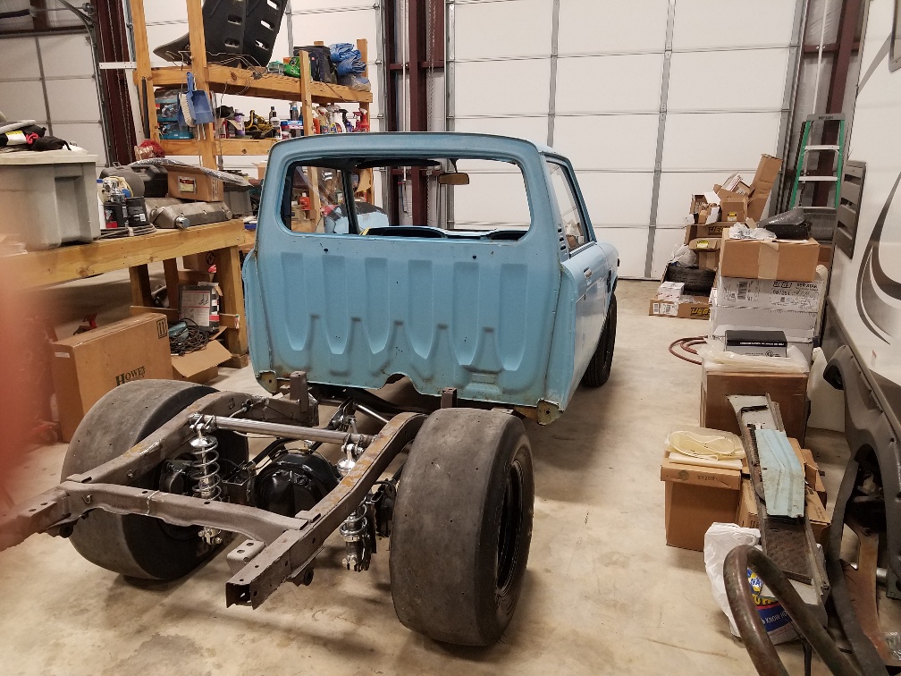

PostPosted: Mon Dec 10, 2018 11:41 am
Posts: 114
Location: Magnolia, AR.

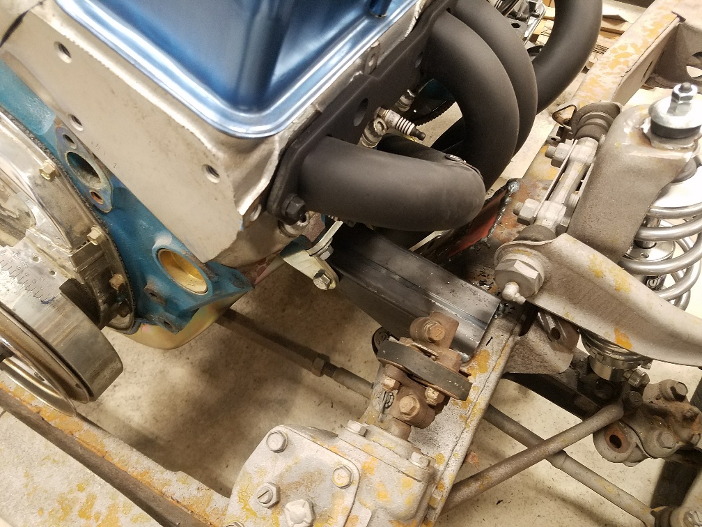

I am real close to getting the cab back on. Just need to make sure that it all fits right then trim as needed, if needed. As they say nothing left to do but finish!

PostPosted: Mon Dec 10, 2018 3:17 pm
Posts: 79
Location: Norfolk, NE
Great job! Looks like you picked up the header to frame clearance you were wanting. Great photos, it helps me have a better idea what needs to transpire for my project, just no where close to your progress! Please keep us posted as you move forward....

PostPosted: Mon Dec 10, 2018 5:30 pm
Posts: 114
Thanks for the pics and the compliments on this build! I have built some Hot Rods/Street Cars/Rods in my life and this little truck has tested my ability and sanity! Any help from anyone is always welcome and appreciated!

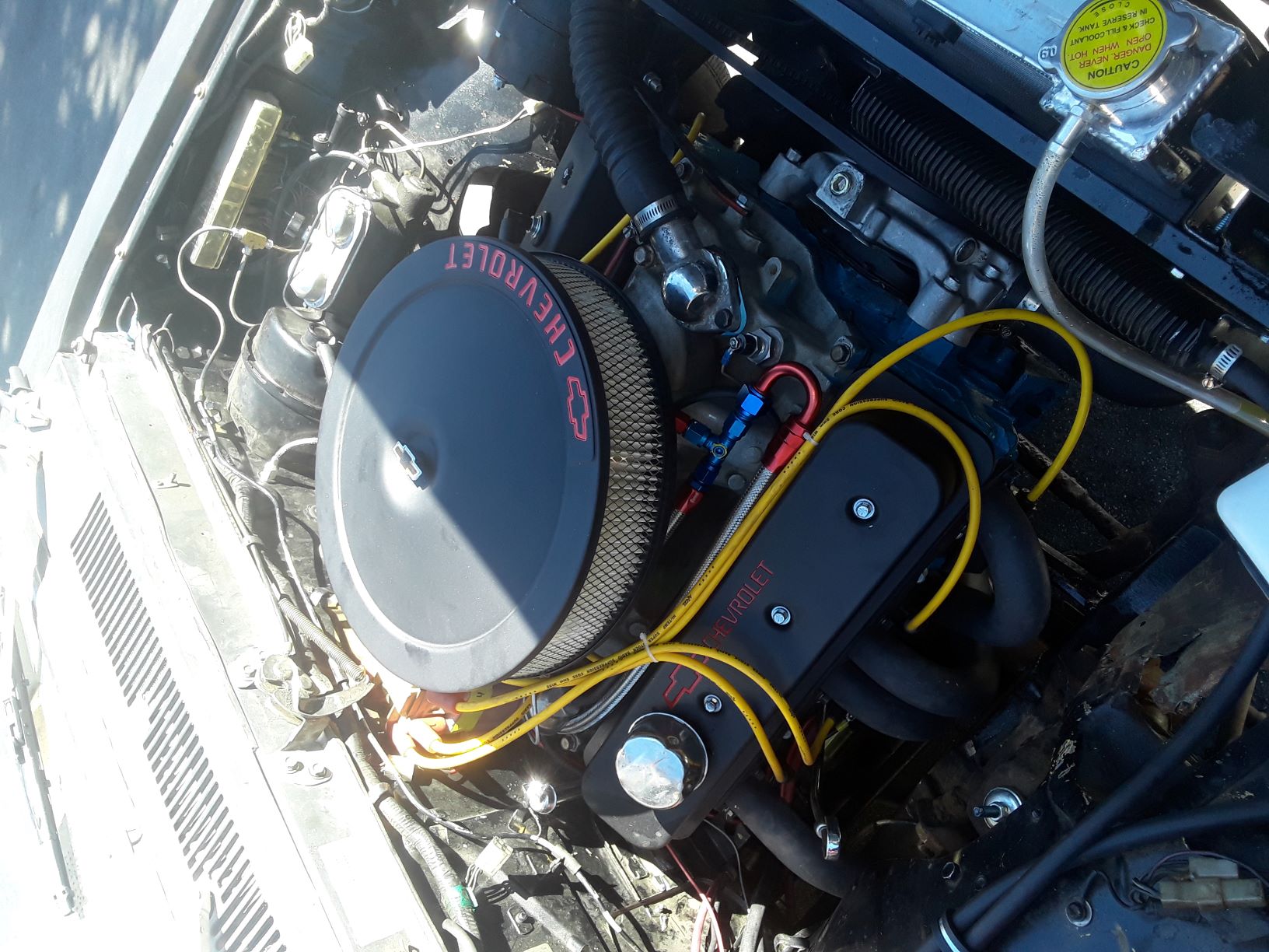

[attachment=0]20180915_140837.jpg. That's about as good as I can get right now. I will try to post tranny mounts later.

Can you take a measurement from the front cross member lip to the balancer front? The lip is closest to the motor. And one from the cross member under oil pan to bottom of pan to top of cross member?

Good morning. At least it is here in San Jose. :esmile Requested measurements: top lip of front crossmember to harmonic balancer (8" balancer) is 1&3/4"; bottom of oil pan to top of crossmember is 1&5/8"; and, from bottom of front crossmember to bottom of balancer is 3/4". There's plenty of room if one uses a single belt pulley, which I do.
I hope this helps. I have always found it best, if one can, to fabricate your own motor mounts rather than kits. I used factory motor mounts off the block so I get no vibration through the chases.
PostPosted: Thu Dec 27, 2018 3:07 pm
Posts: 114

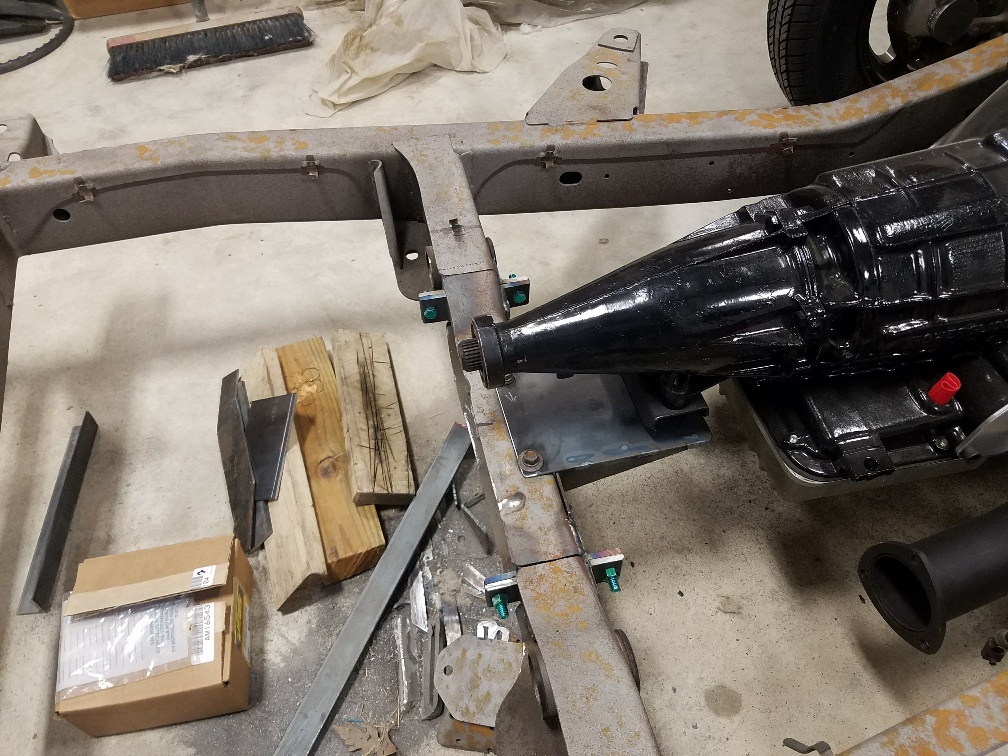

I built my mounts for this build. Pic added for reference to mount. I used ACE mounts for some location help. Now I will get some pics and measurements for reference. Thanks for taking your time on this.

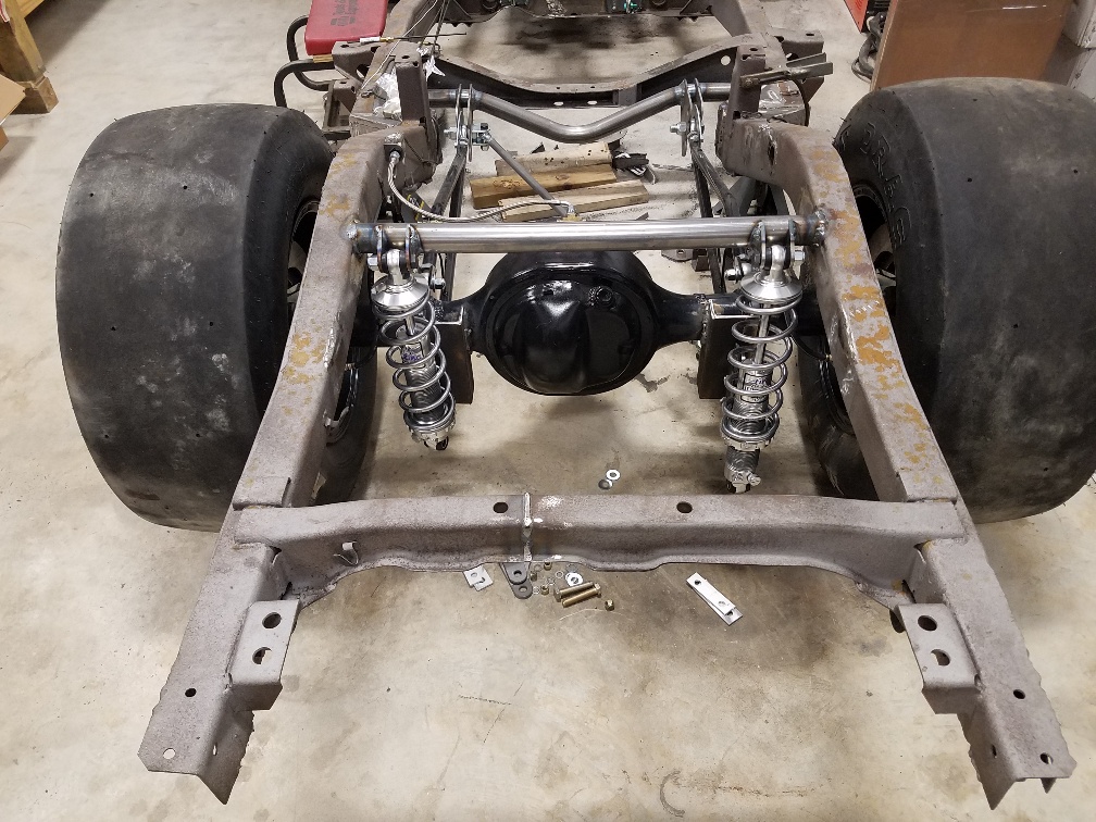

PostPosted: Wed Jan 02, 2019 11:26 am
Posts: 114

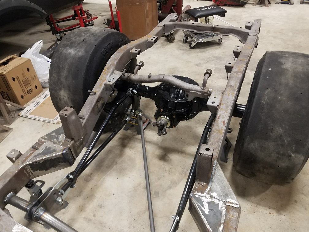

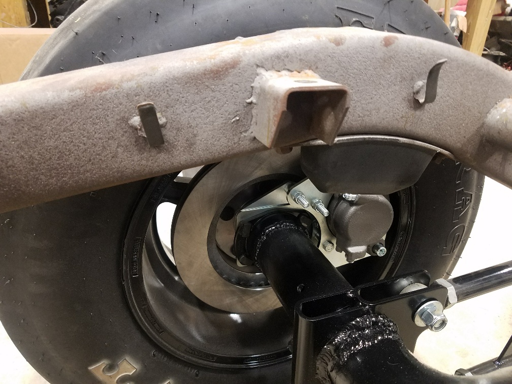

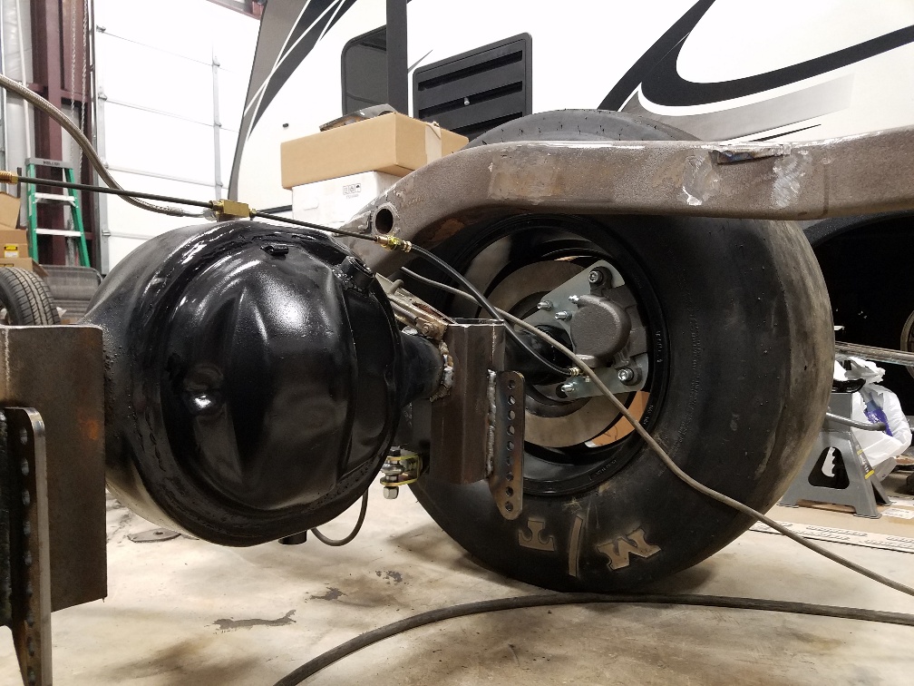

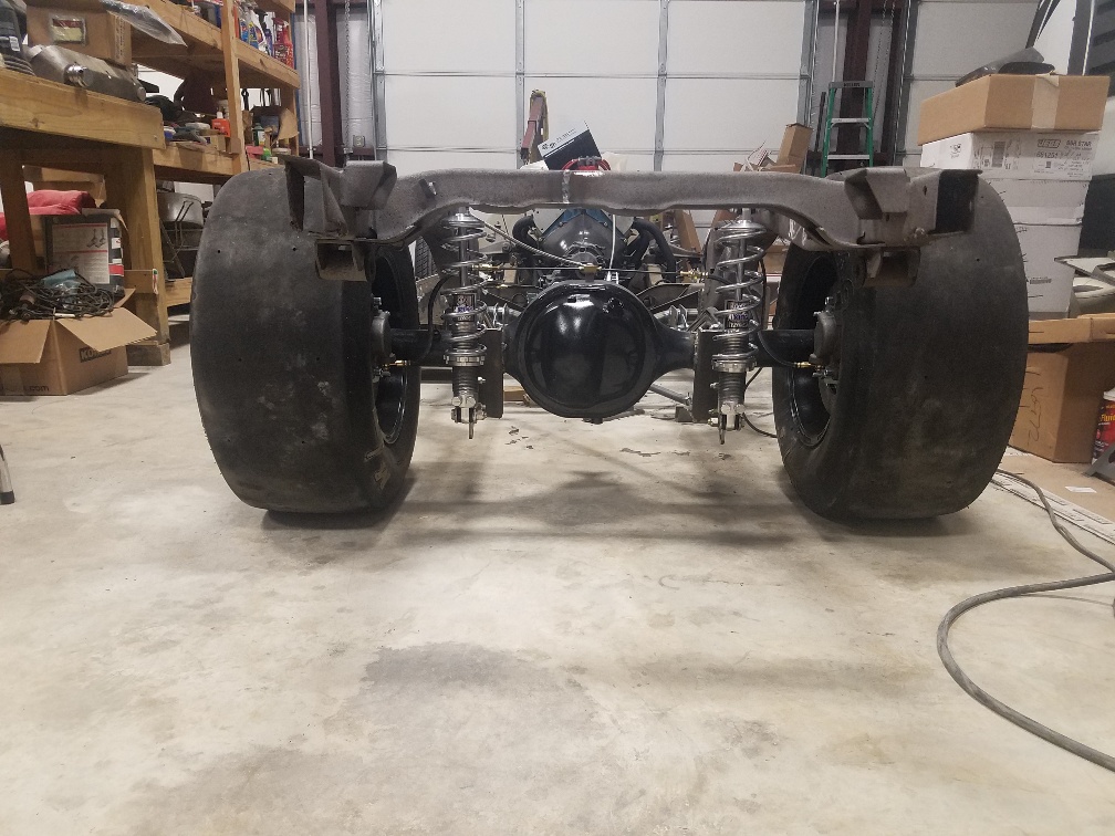

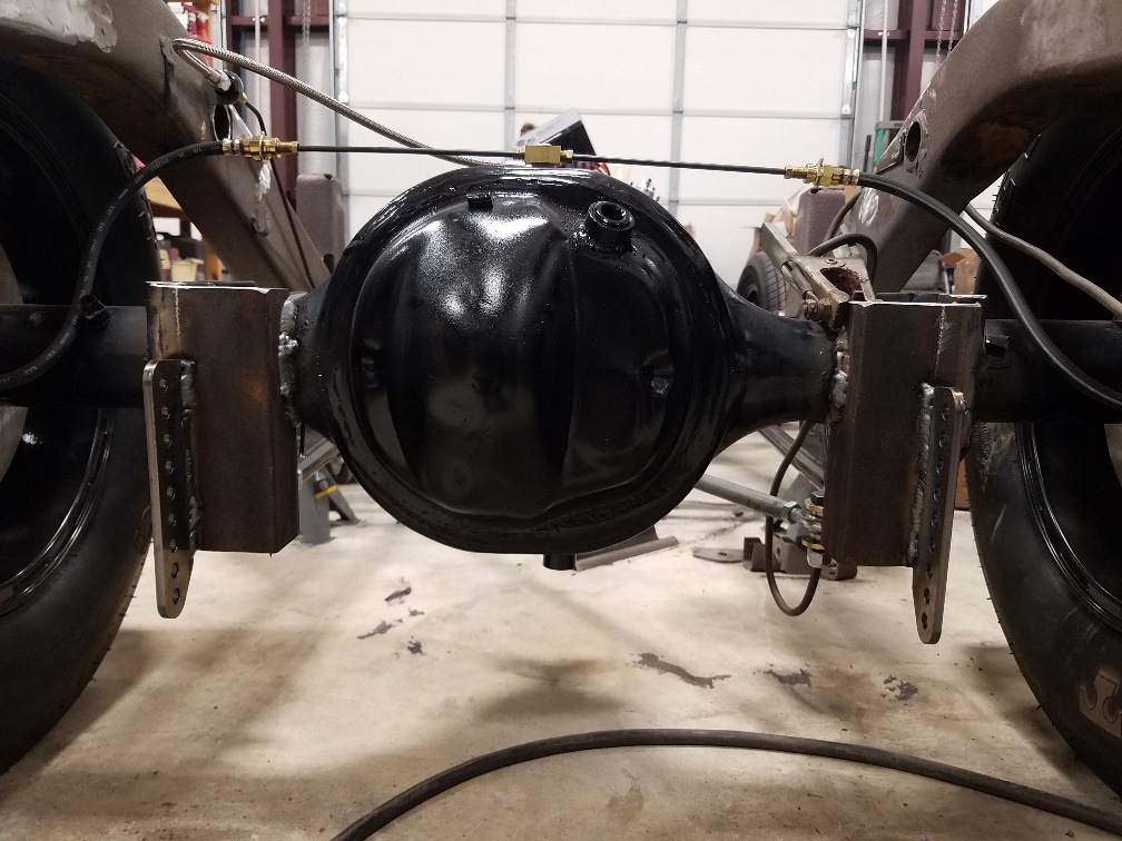

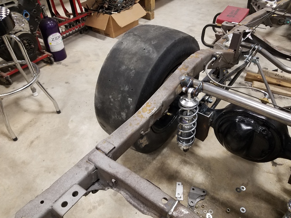

I moved to the rear to let my head rest for awhile! Got the shocks mounted just have to pick up some longer bolts to finish! Then finish up the brake lines. Just about a roller again! :D :D

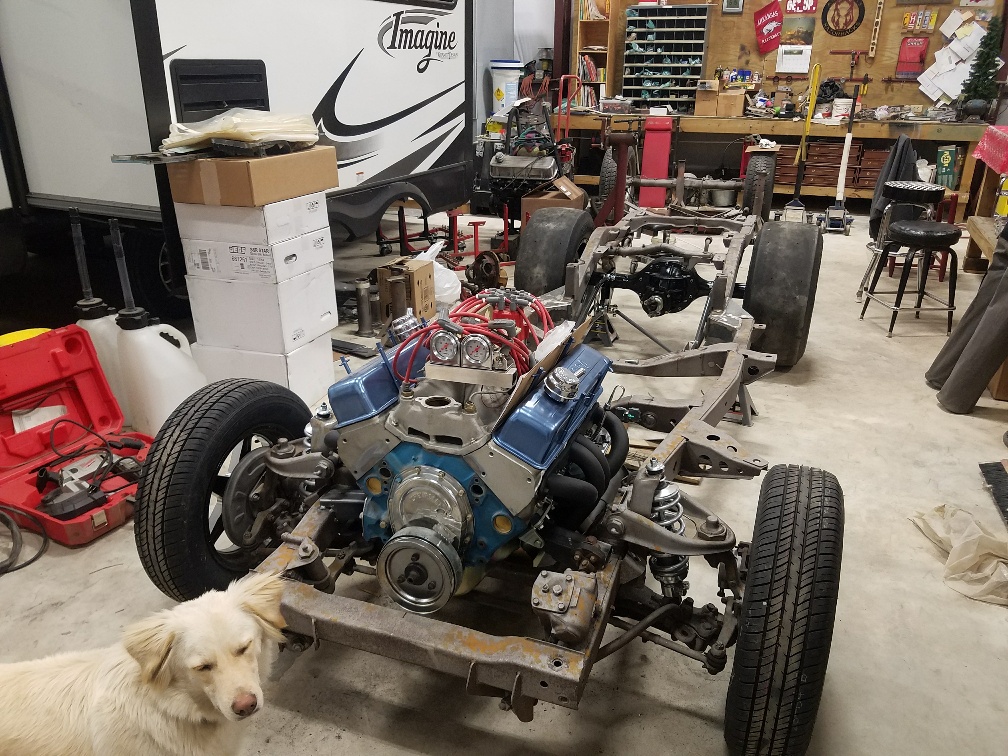

PostPosted: Wed Jan 02, 2019 7:44 pm
Posts: 114

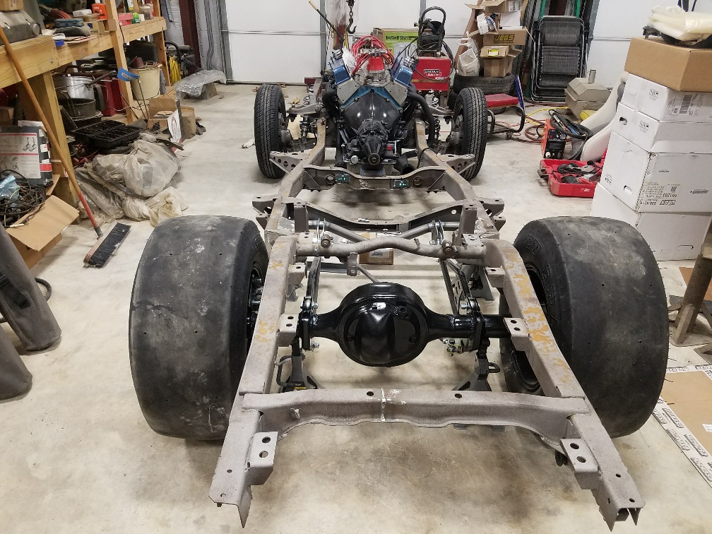

Got it on all fours! Have to finish the brake and fuel lines then fit cab and bed. Liking the way it's turning out!

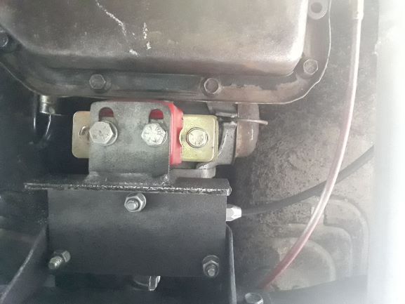

PostPosted: Mon Jan 07, 2019 1:07 am
Posts: 34

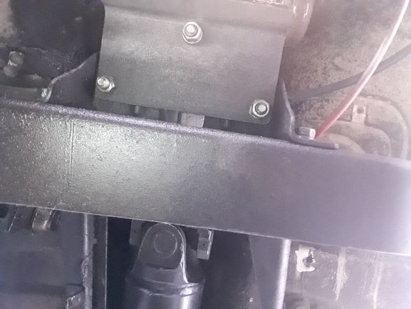

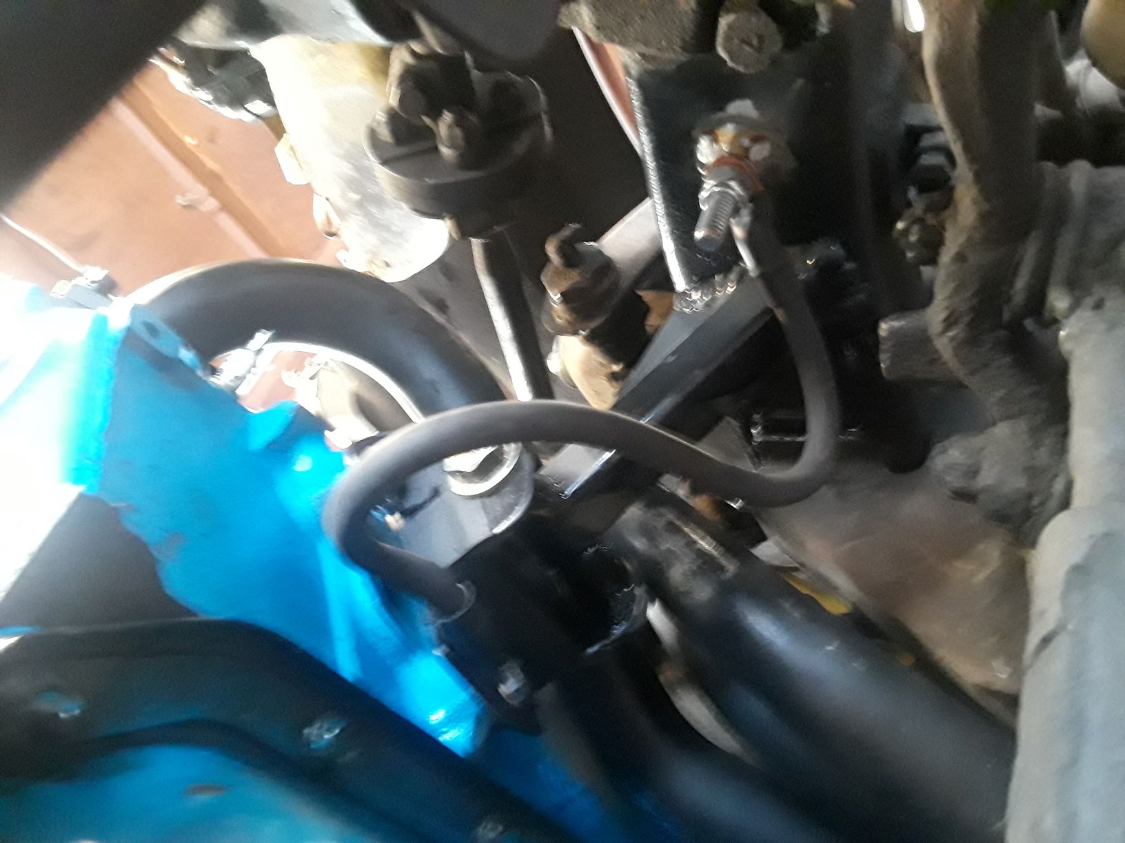

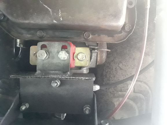

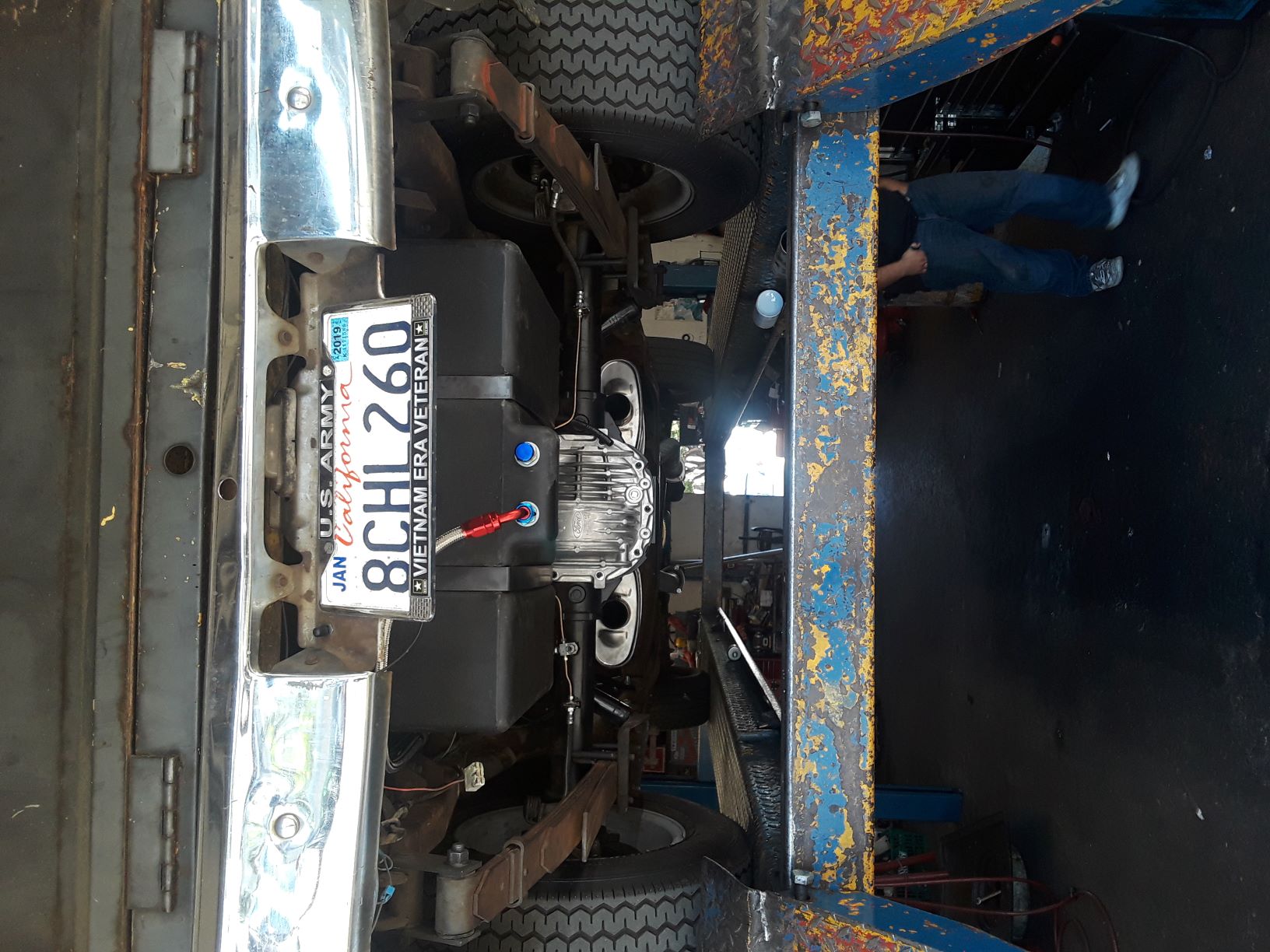

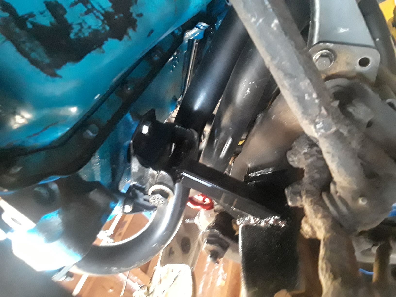

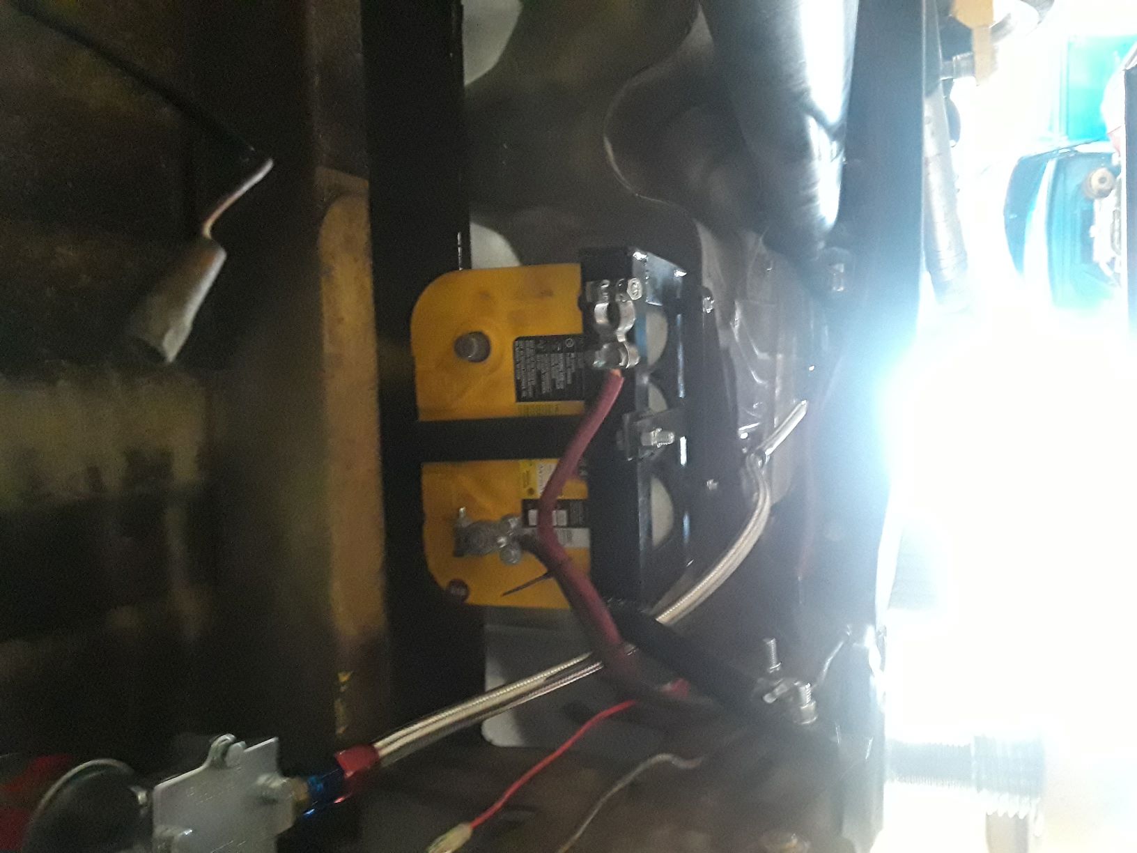

A couple pics of my fabricated tranny mount. Just a couple more pics to look at. Had to crawl underneath the truck to take them. Also a pic of my battery where fuel tank use to be. Now have fuel cell tucked up under the rear of the bed.

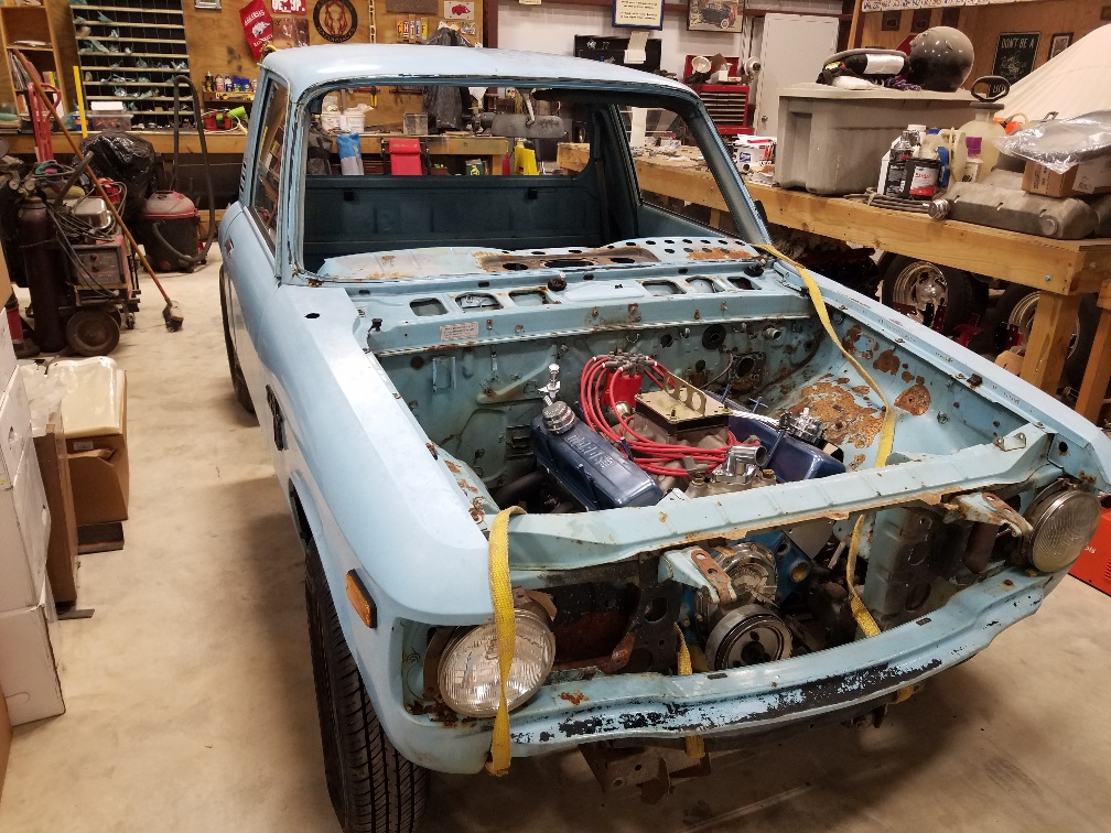

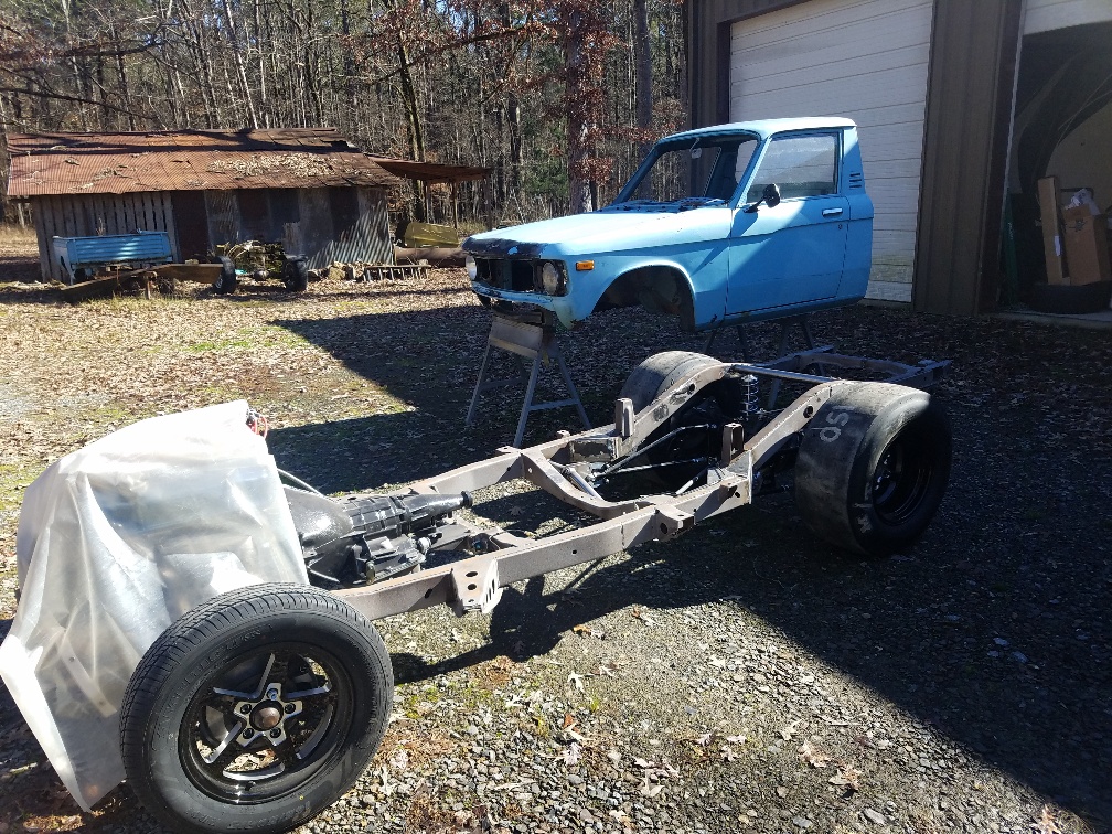

Got it looking like a truck......well almost! I still have a little bit of trimming and adjusting on the body but, it is looking way better.
