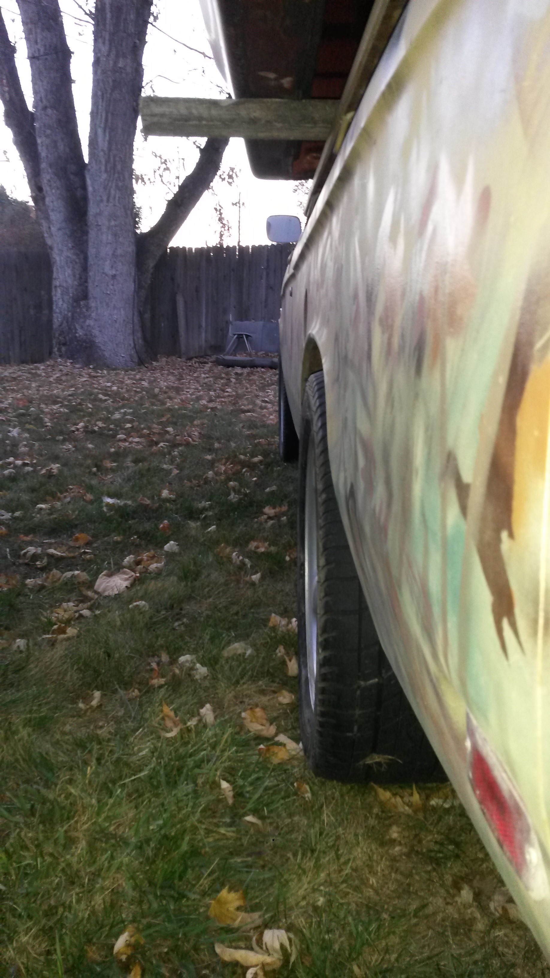

58 inches with 96 Rodeo 16x7 and 225/50s

Thanks durty,
That gives me a good visual!
