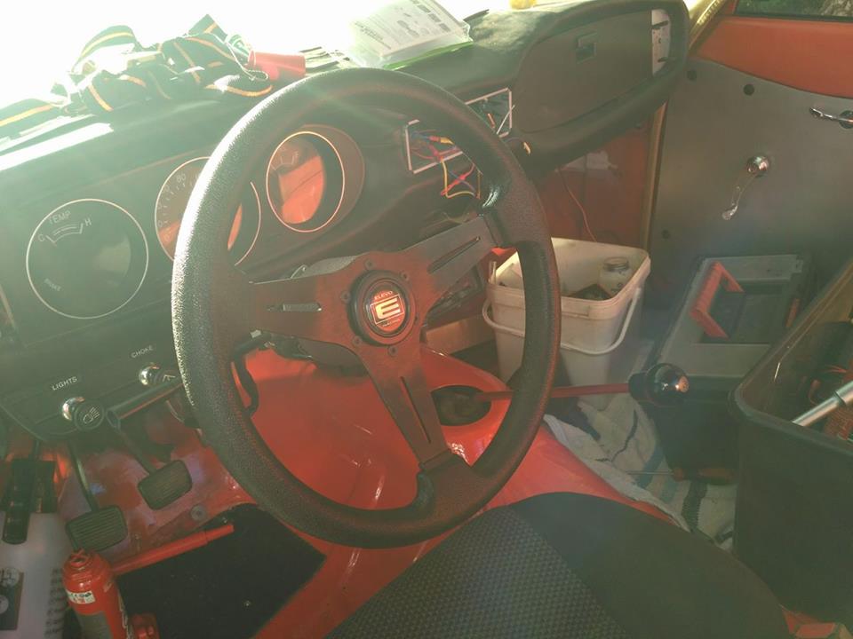

Finally i got my truck on the road
I put a weber on it and althoug it is not jetted correct it works much better than the nikki.
The disc brake swap works fine but the brake pedal makes a big travel so i will swap the master cylinder with another one from the next generation.
The brake light in the dash won't come off and i checked that the parking brake lever is missing the little plate that pushes the switch for the light.
Can anyone post some pics of the brake lever so i can figure out how it works to fix mine.
Also the speedo is not working and i believe that the speedo gear in my transmition is damaged.Is there any fix for that problem?
