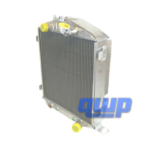

try this one if you have a body lift and motor swap with chevy v6/v8
http://www.ebay.com/itm/Aluminum-Perfor ... ~c&vxp=mtr
