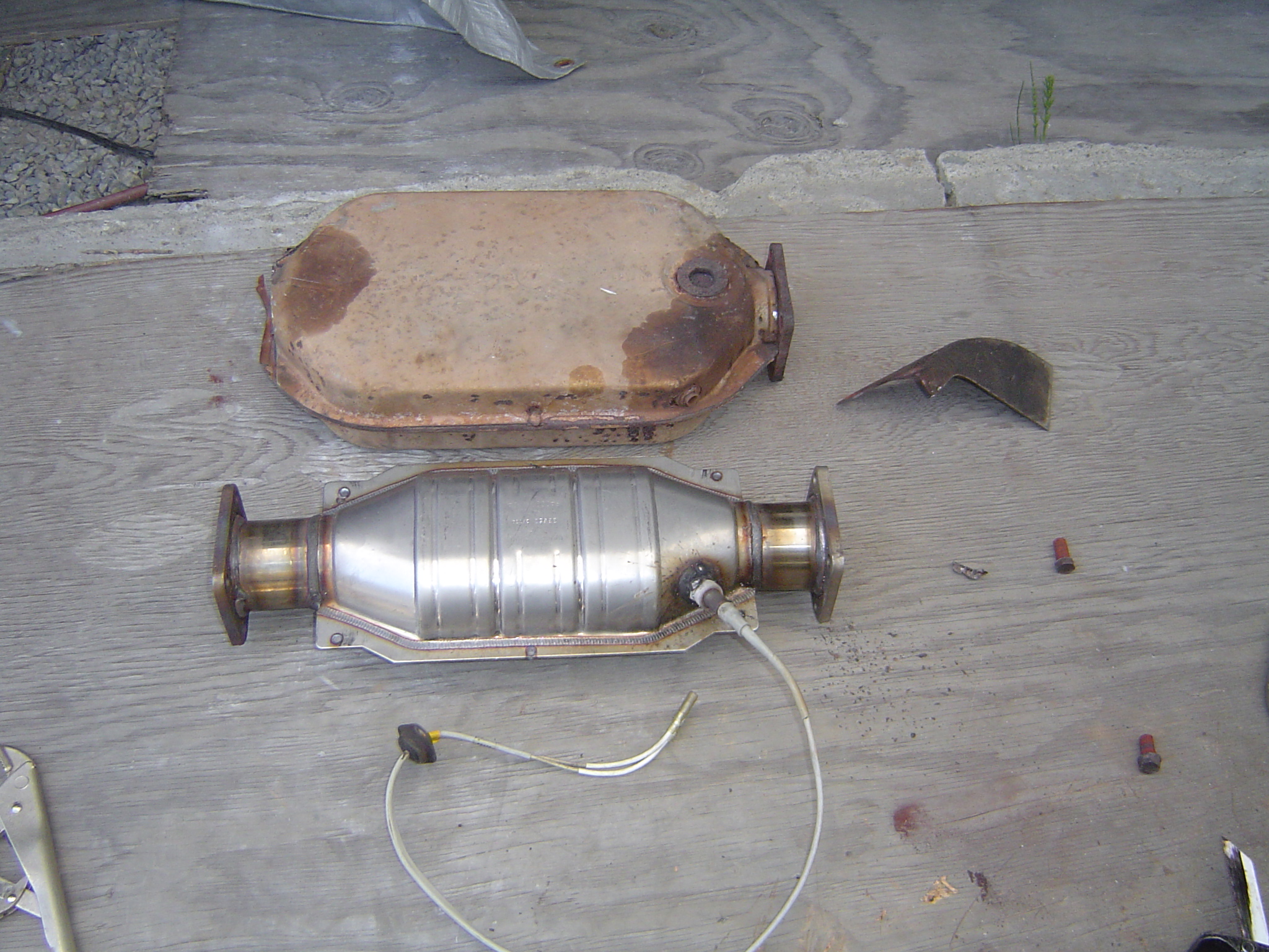

swapped out the cat w/ one i found on ebay...wanted it to pass the smog inspections so i had the muffler shop transfer the sensor in it so it at least past the visual ...no problem when it was smogged :D

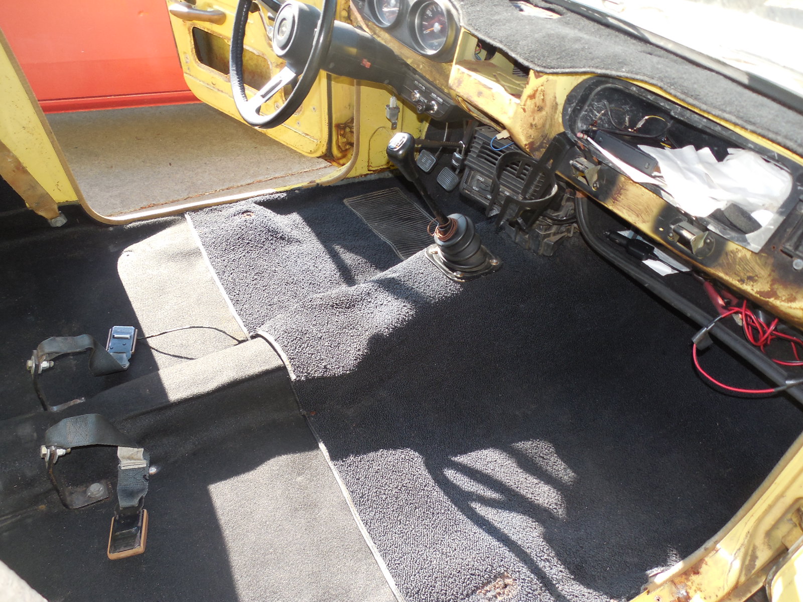

found a good deal on a new unused carpet from old chevy impala ...trimmed it so the pad was at the drivers feet and trimmed off the rest...only went 1/2 way back and used felt for the back 1/2 ...thinking i will use the back 1/2 of the carpet for the back wall of the cab

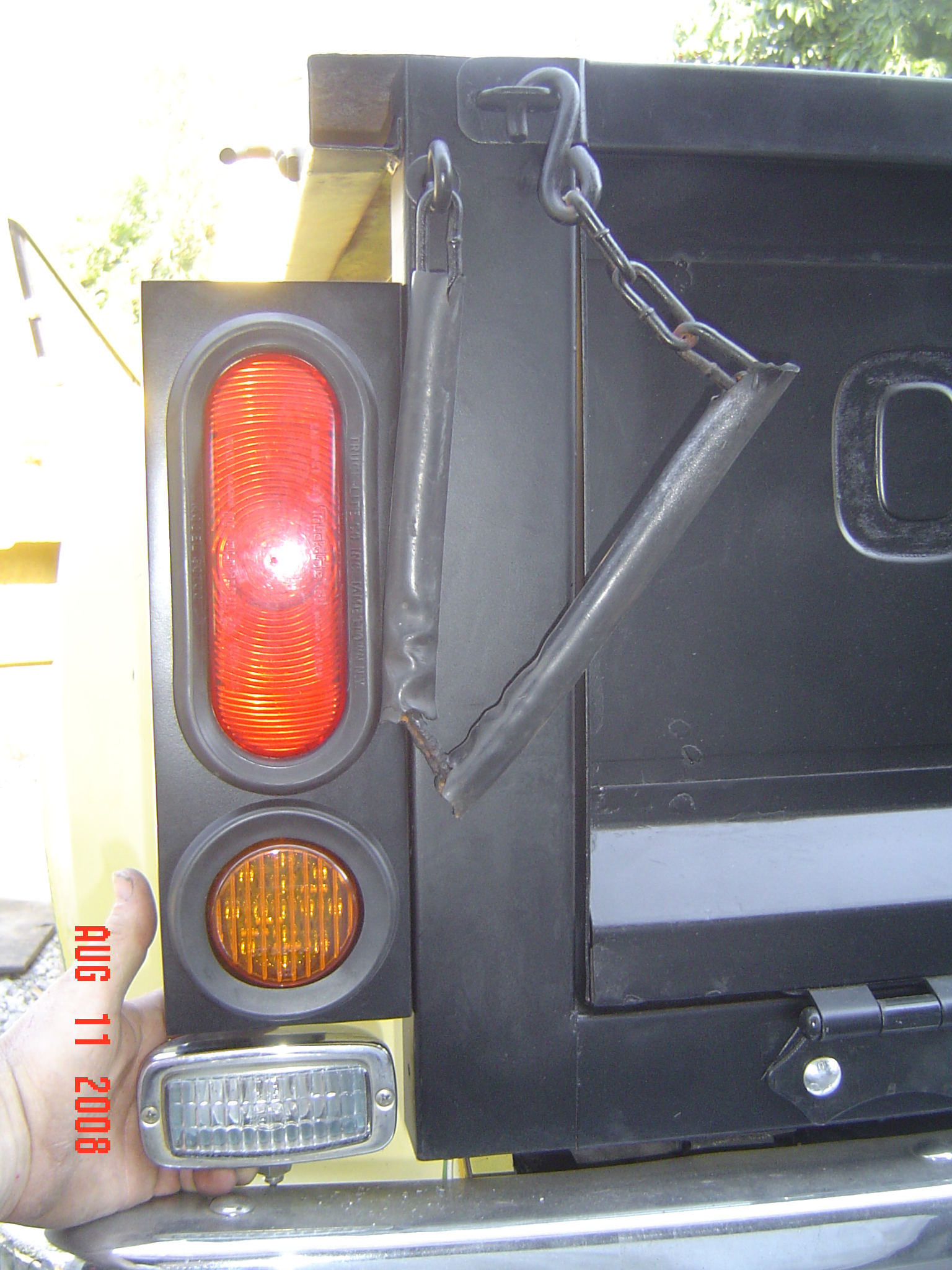

the old rear lights was brittle and all rusted up inside pretty good so to get this truck out on the road & drive-able
I made these boxes w/ some lights i had until i figure out something else.....thinking to use these vw reverse lights ...but never installed them....looking at some led lights these days ...but still not sure ...seen some stock looking lights w/ leds...so well see
I think i need to brighten up the back so i don't get rear ended & next up tailgate hinges i'm finding that they are hard to come by so probably going to make a pair fit from the hardware store.

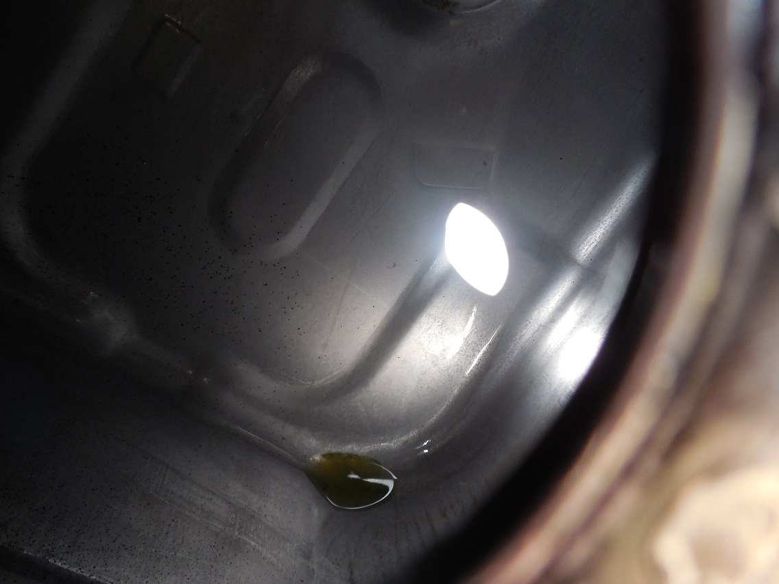

Here's what i ended up with little tuff to take pics inside but i managed a couple 3152
File comment: I decided to make it easier to drain out i added a drain plug on top corner

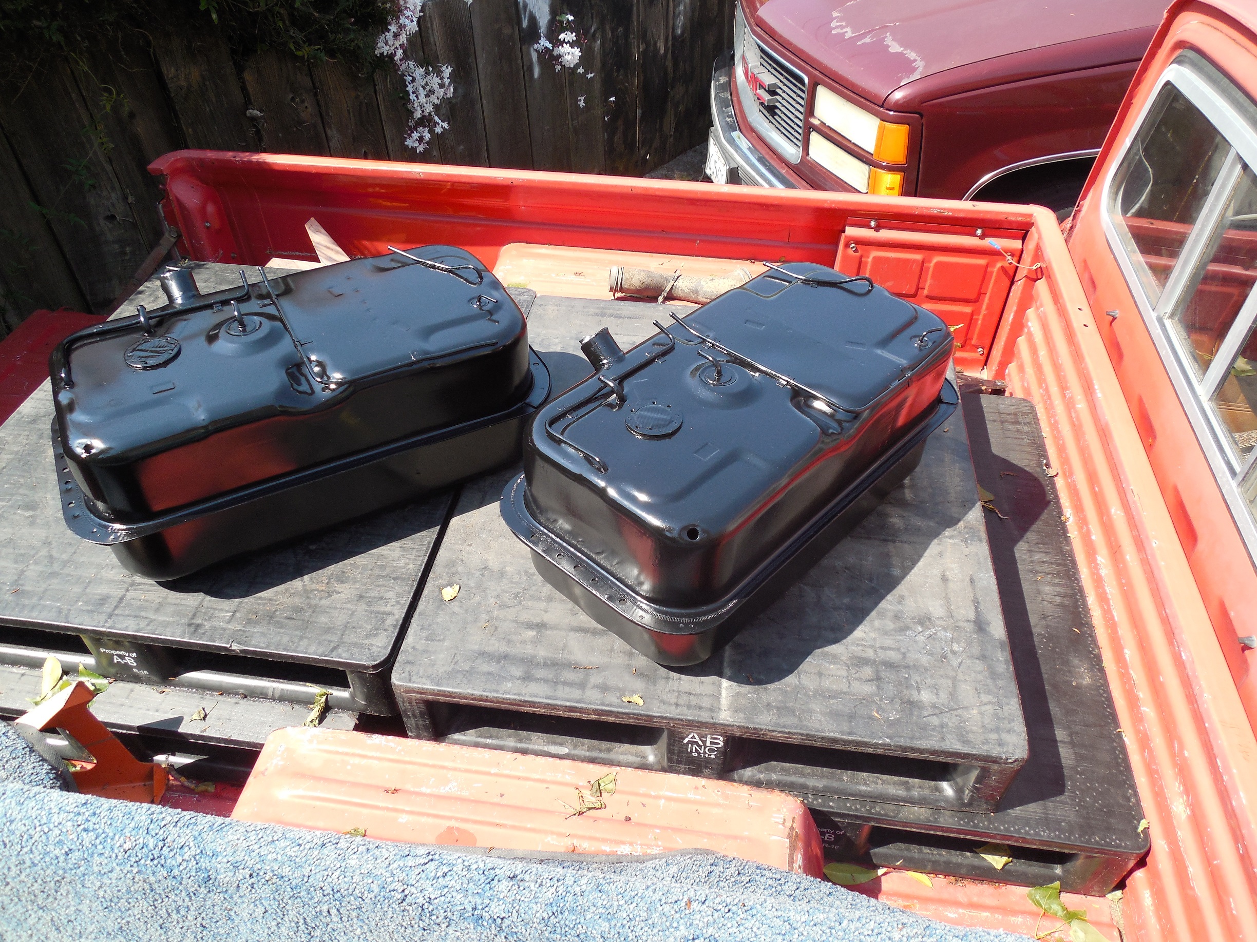

Got my 2 tanks all cleaned up L@@ing new again :D .... Ready to be installed

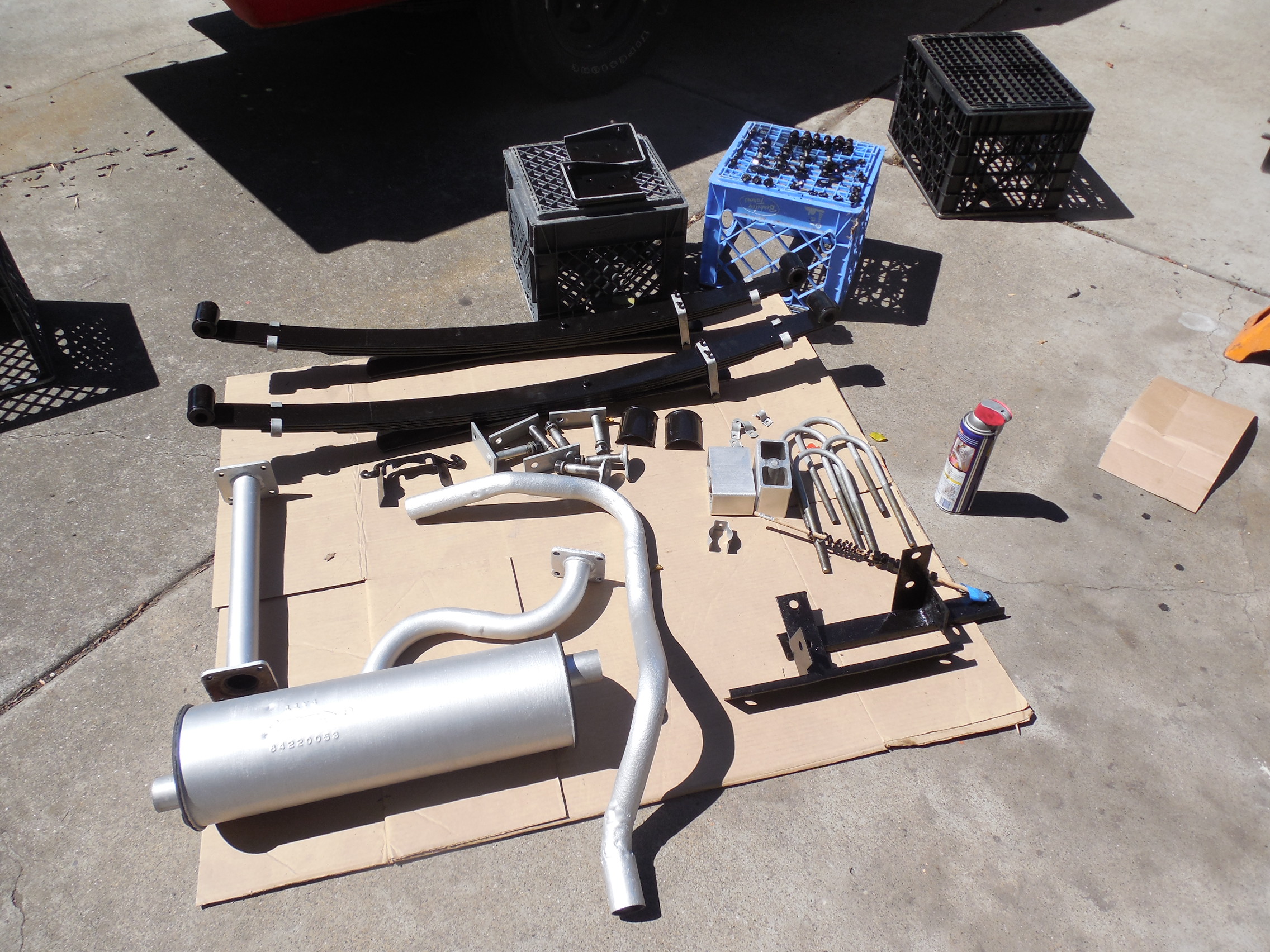

PostPosted: Tue Aug 15, 2017 11:03 am
Posts: 607
Ok its time for some LUV to the LUV
New muffler time (smog next month ) & install that sealed up gas tank & clean that rear end up & replace a few seals
File comment: bed off & time to clean all this up
swap a few things out.
File comment: rear end is looking tired, sad needs some attention & a good cleaning.
File comment: backfire split the seam last year so i sorta closed it & drove it for a while w/ the rumble.

PostPosted: Wed Aug 16, 2017 11:46 pm
Posts: 607
HELP ! I keep finding more stuff to do With ALL these parts off :lol:
It's been to LOOONG so she's getting some NEEDED LUV...coming up on 2 weeks now
4272
File comment: Ready to go back on. cleaned up, prepped & painted the bottom of the bed w/ Pot15.
File comment: Parts are collecting its time to assembly a few...to keep this project going.
File comment: starting to get her back together & while the bed is off & tank in I can adjust the sending unit manually to where i want it As she runs out of gas before i hit empty line.

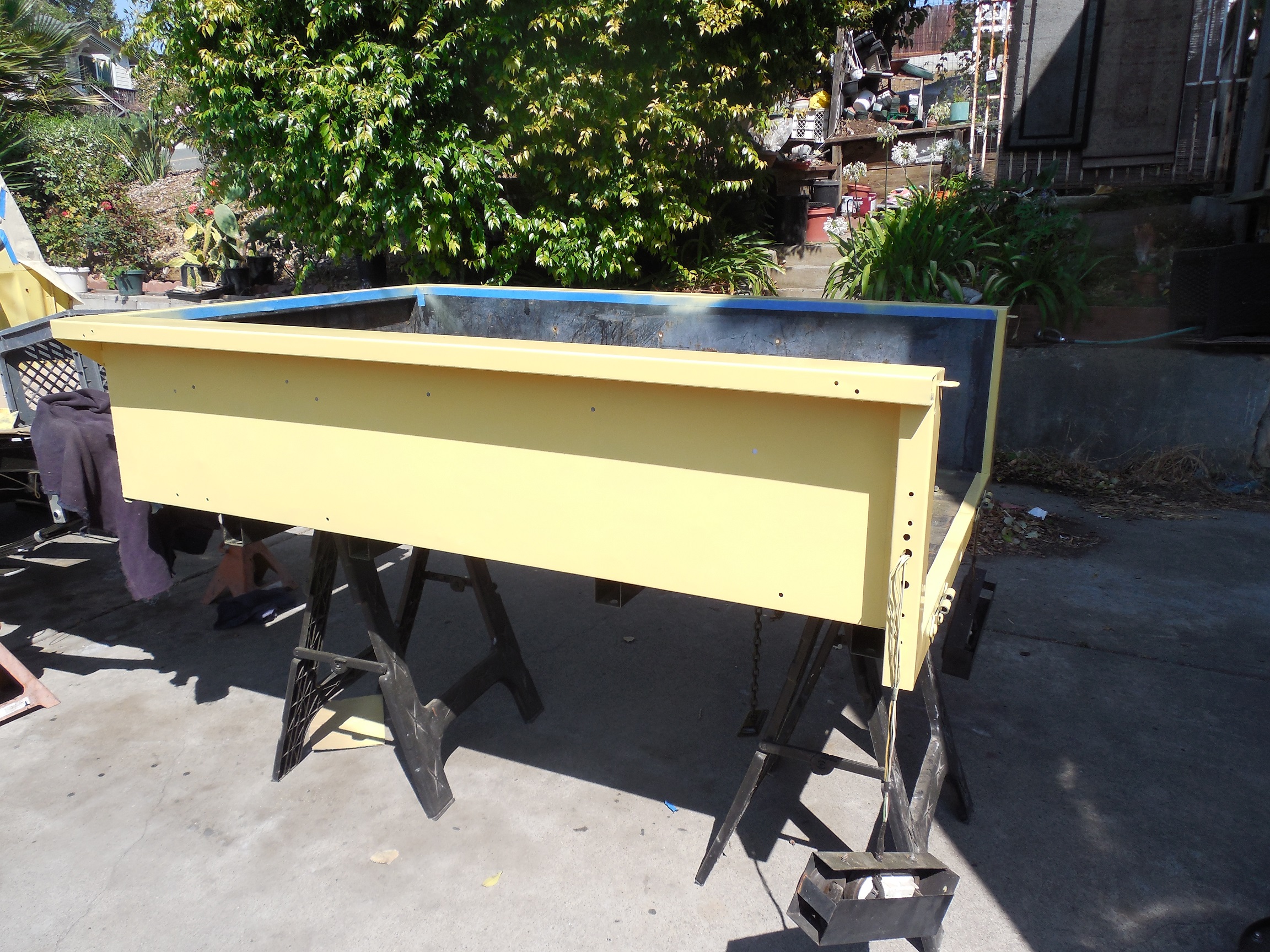

File comment: had some por15 paint open so wire wheeled the top treated it for rust and gave it a coat sanded it down another coat w/ high build primer then some spot putty before more rattle can touch up
File comment: nothing major but a little clean up & rattle can to the bed sides & top rails.
