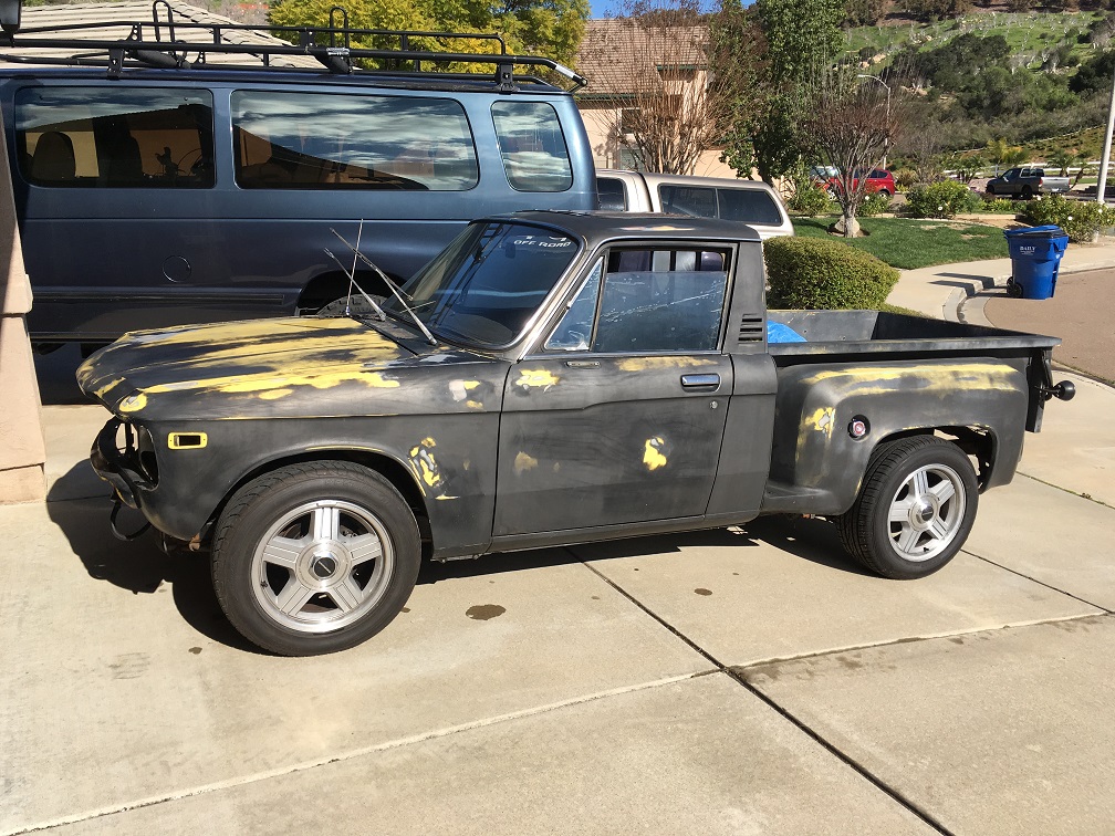

On to the body work and paint....
Body is super straight, no rust I've been sanding and filling small dings.
The hood needs work, lots of chips and small dings..
should spray some primer next week.
Haven't done any paint work in a few years but my budget is tight after the paint work on my other car.
gotta paint it myself, or at least give it a try.

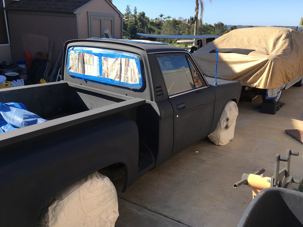

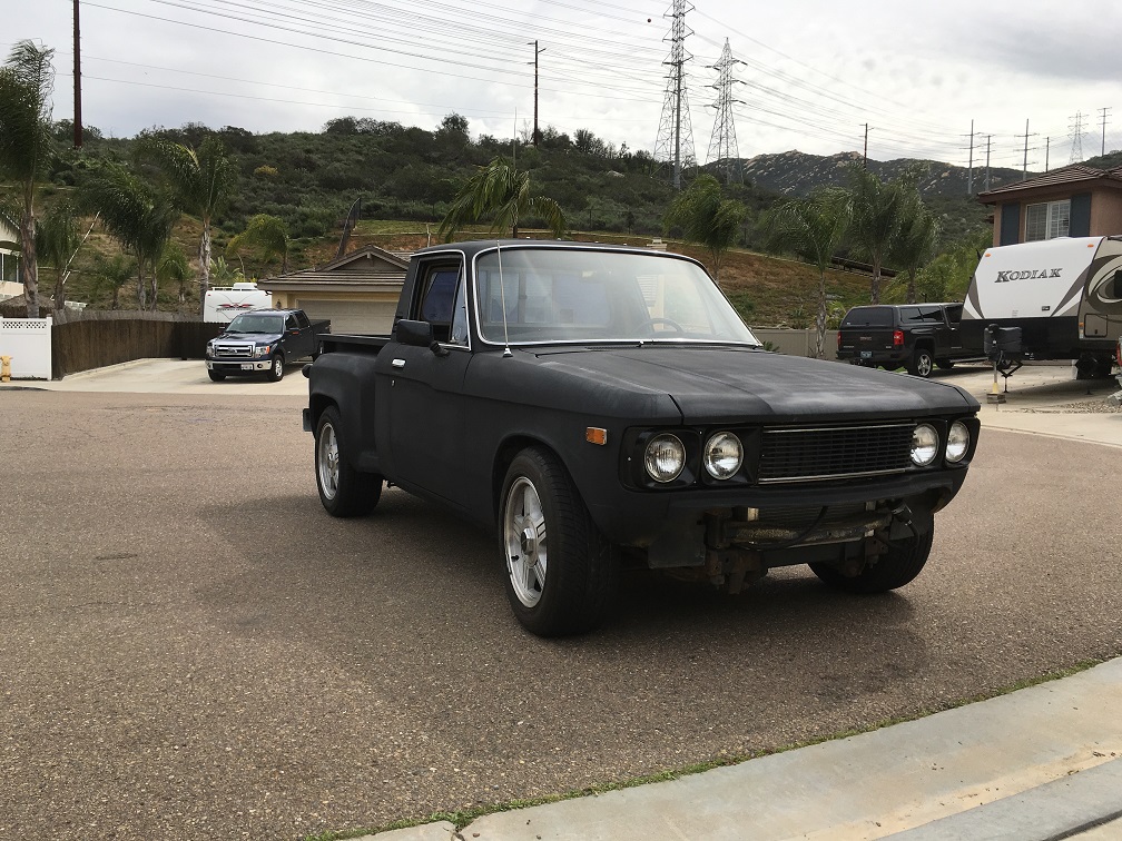

2 weeks working on and off on small dings and scratches and a hood that I thought might have to go...
it came out very straight, body is clean. I am thinking silver on the top, charcoal grey on the bottom...hmm.
Or that cool orange I saw on a new dodge dart..i'm gonna think about it.
Gonna drive it for a while this way.
PCL 903 poly primer in black...works great.
Had my local Ace Hardware guys shake it up for me.
Got an early grill, dual headlight buckets, bezels, and a fiberglass front bumper going in.
aluminum channel bumper for the back.

So I was waiting on bumper decisions...put them up for sale in classifieds...no takers so far. I'm not gonna give them away cheap, they are pretty nice as is for a 44 year old vehicle.
so I will re-chrome them and re-use them, since shipping and handling for the fiberglass one (Unlimited) is close to $200.00
I can re-chrome it for $225....makes more sense. Giving to a chrome shop for re-working and new chrome tomorrow.
Here is a current picture..
Bought a good wiring harness since the P/O cut out the original one. I'm gonna take it apart and use lighting and windshield washer circuits, the rest is already done. Truck runs and drives really well, fast and fun but a little stiff. The front end reminds me of the old 87 and 89 IROC and GTA Trans Ams I used to drive/have, ride is pretty stiff.
Anyone know how to soften it up? I have BellTec nitro drop II shocks on the front, maybe that is the problem.
I hope to let it sit in the sun this weekend and work on the window tint, thanks guys for the suggestions and ideas, it has been raining a lot here in so cal, especially on the weekends, I work a lot of hours during the week and have not had the time.
Looking good though, tried the aluminum rear bumper, not sure I like it?
your comments and opinions good or bad are welcome.

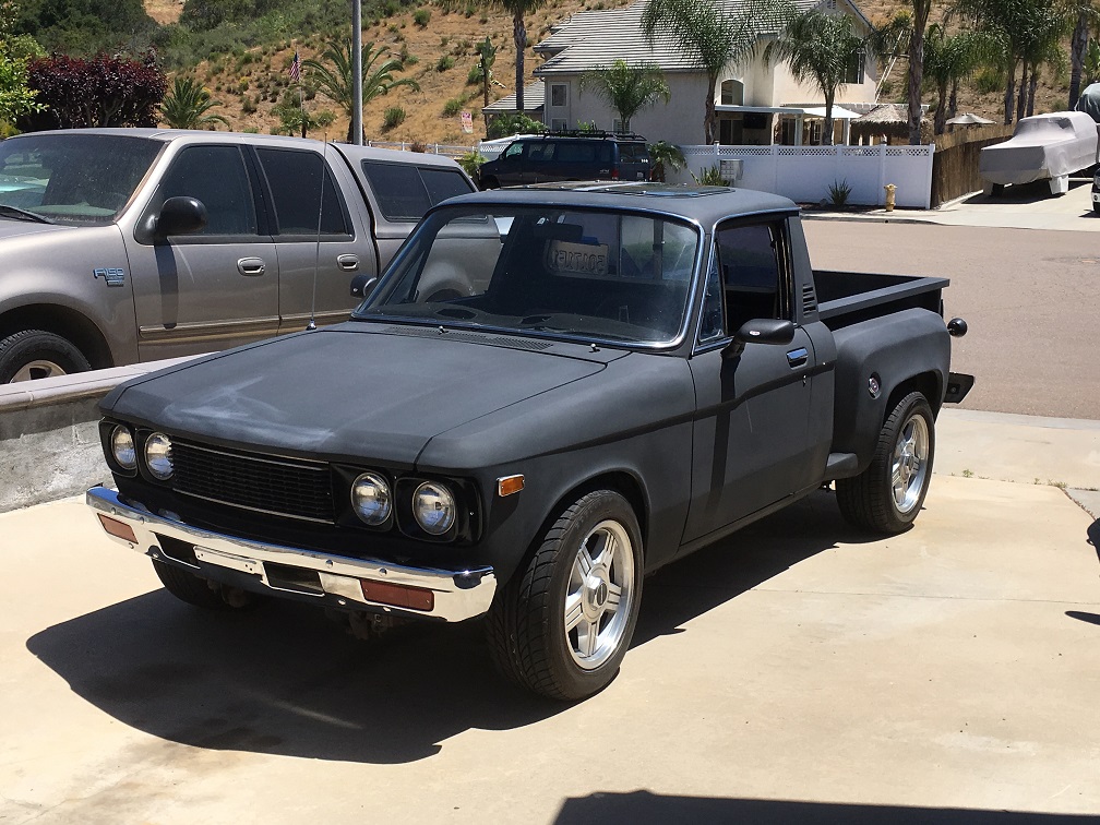

almost done, bumper came out nice!
wet sand and some finish paint for May/June

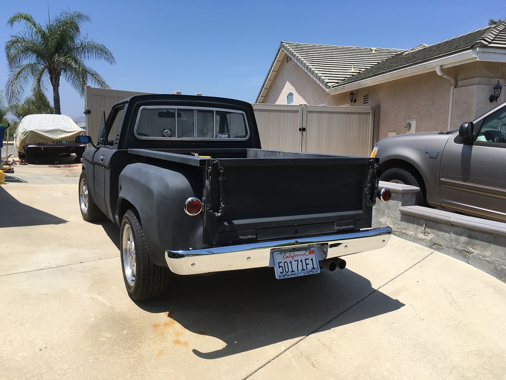

Here are some new bumper shots, got the rear bumper back a week ago, they both are super straight and like new.
I replaced the old damaged Vitaloni Torino mirrors with some newer Vitaloni mirrors from Amazon.
They are not cheap, but great quality.
Glued a new rear view mirror on the inside. threw the stocker out...(it fell apart)
Put on stock Gabriel shocks to smooth out the ride, helped a lot.
Truck drives great and is super reliable, no leaks from anywhere, no overheating issues...just a good little truck now.
Only recent problem is it makes everything else I drive seem slow...and their not!
Power steering would be nice, but smaller tires and rims on the front would help.

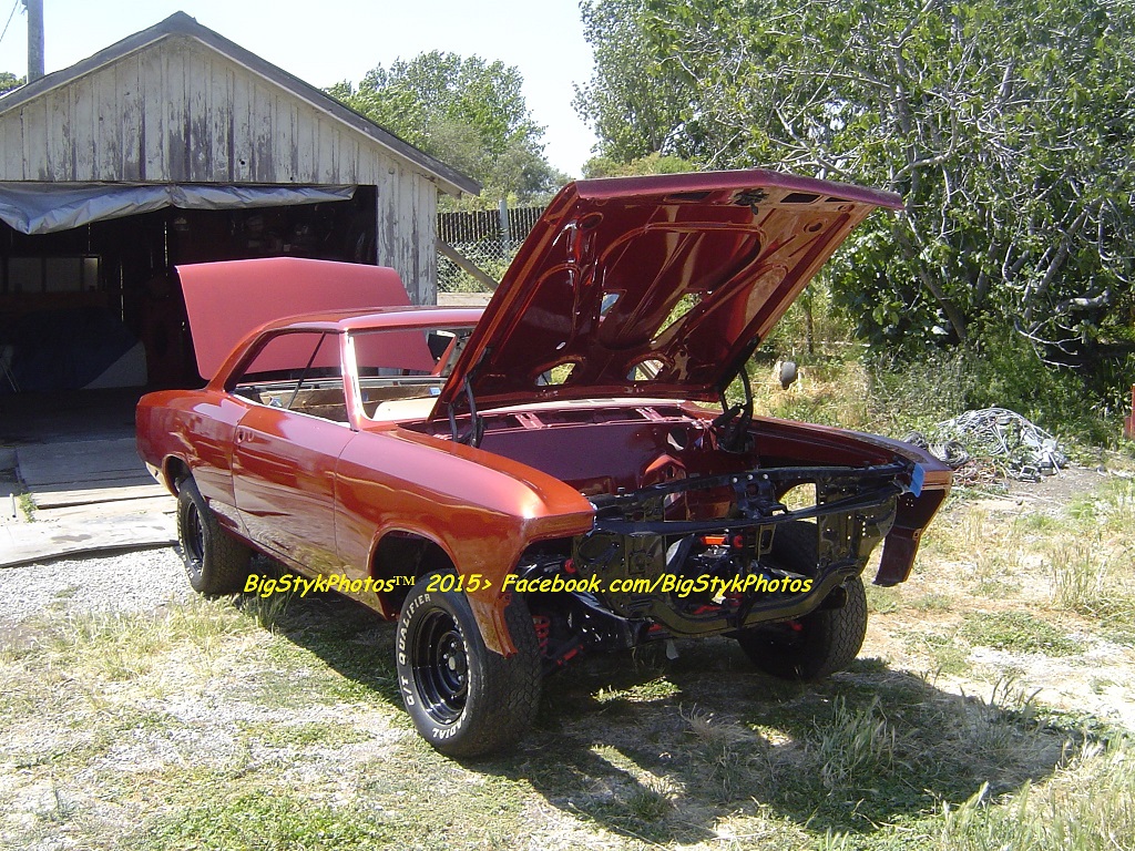

clarkeph wrote:
My other cars need to be finished and are more of a priority. My Chevelle is almost done.
sold the luv did ya .....mine has kept me sidetracked too Here's 66 Chevelle been working on for several yrs
