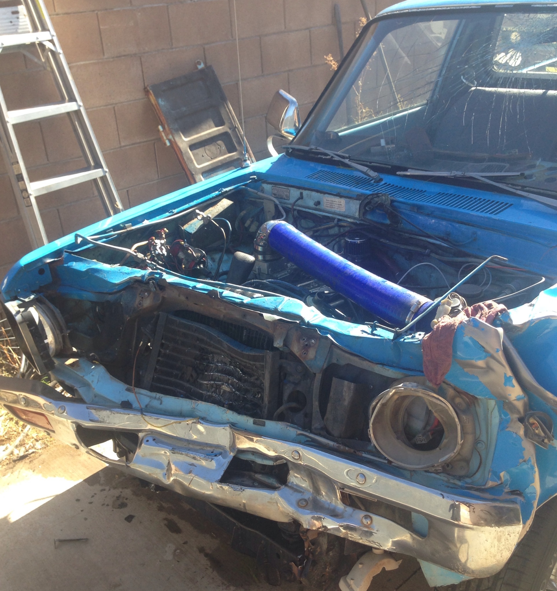

Hello everyone,
I rear ended someone on Sunday night, and wrecked up the front of my truck pretty bad. Im definitely fixing it, but its going to take a while. I have a spare parts truck that has a good cab on it, and I was wondering how much work it would actually be to swap the cabs over. Swapping cabs would be the best and cheapest option to fix her back up. Looking at my truck, the frame still looks good, and the drivetrain still looks good. I'd appreciate any help. Ill post some pictures here shortly

After. That crack in the windshield is from my head

I was thinking about just using from the firewall forward on the parts truck, but I damaged the metal that reinforces the dash with my knee. the dash in my truck is ruined, but the parts truck dash is really good plus the firewall isnt damaged at all. On my truck, the firewall is pushed back a little i believe.
