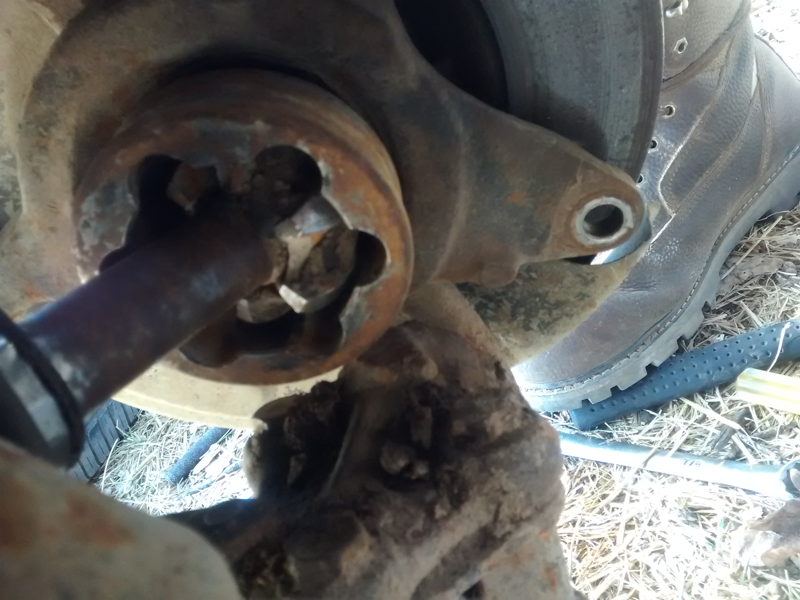

I'm having trouble finding CV axles, too, for a '79. The right outer CV joint needs a new bearing-thingy (pics below). I'd appreciate any ideas on how to get one!

File comment: missing bearing from right CV joint

Good luck on the front cv joints. I've had 6 different companies send axles listed as compatible. None were.
I've been searching for over a year. I wish I had better news.

Here's the update I got from my source:
Quote:
HI JACK, NOTHING AT ALL ON THOSE , THEY HAVE BEEN DISCONTINUED A LONG TIME AGO , AND ABOUT THE ONLY THING YOU CAN DO IS HAVE THEM REBUILT , THE ONLY PLACE THAT I KNOW THAT WILL REBUILD THOSE IS IN ALITTLE TOWN ABOUT 45 MIN FROM HERE AND THE LAST ONES I HAD DONE WAS 200.00 MY COST.
Sorry it's bad news! :(
