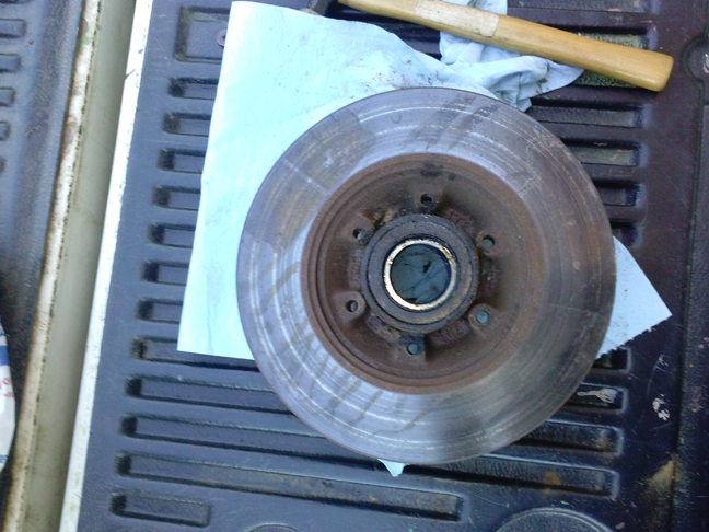

Hey guys, I have a broken wheel stud I want to replace. I have the hub and rotor off the spindle. The bolts that go through the hub to the rotor are all off as well. Is there any other part I have to take off so the hub will come free from the rotor? Here's a picture of top and bottom.

It's been awhile since I've taken mine apart, but that should be all you need to do. They may take some persuasion to separate, especially if it's been a few years. Try prying one side a little then rocking back and forth.

I ended up using a rubber mallet to hit the rotor. Making sure to pad the surface under the rotor before hand. Just tapped around the rotor and keep track of how it moved, then would tap on the side that moved less. The technique worked good.
