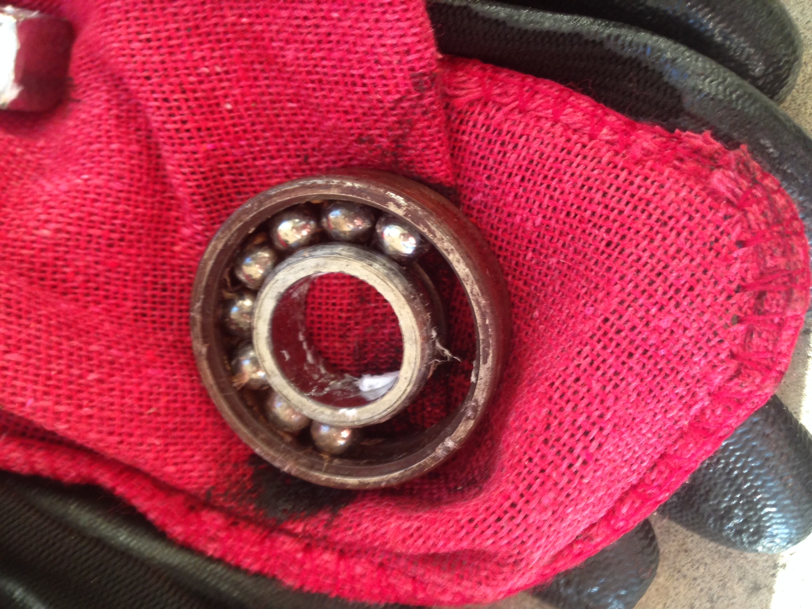

I was able to get it out with paper and water (via YouTube). Took 3-4 pieces of normal printer paper and a lot of time! Attached is a pic of the pilot bearing, missing a few ball bearings..

Cool. Got a link to the video?
You can borrow the bearing puller for free at auto zone btw.

Here is the link: https://www.youtube.com/watch?v=_nKUhb31LKM
From my experience be sure to not bang your socket/socket extension in too far. It was a pain pulling it out.
Maybe next time I'll borrow that puller haha
