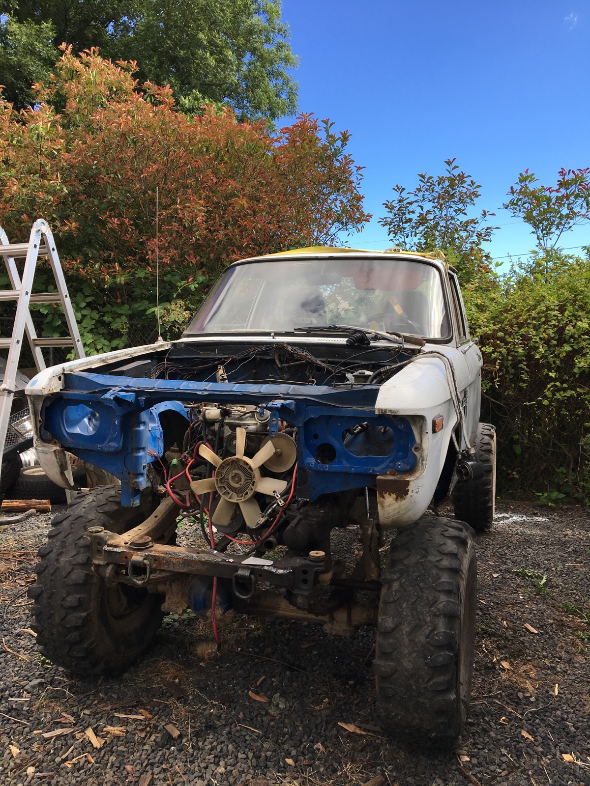

PostPosted: Sun Jul 01, 2018 10:57 pm
Sold a while back
New owner sent me a pic of how it's sitting today. On its new home on a Toyota chassis. Needs body mounts fabbed but i guess thats how its gonna sit
