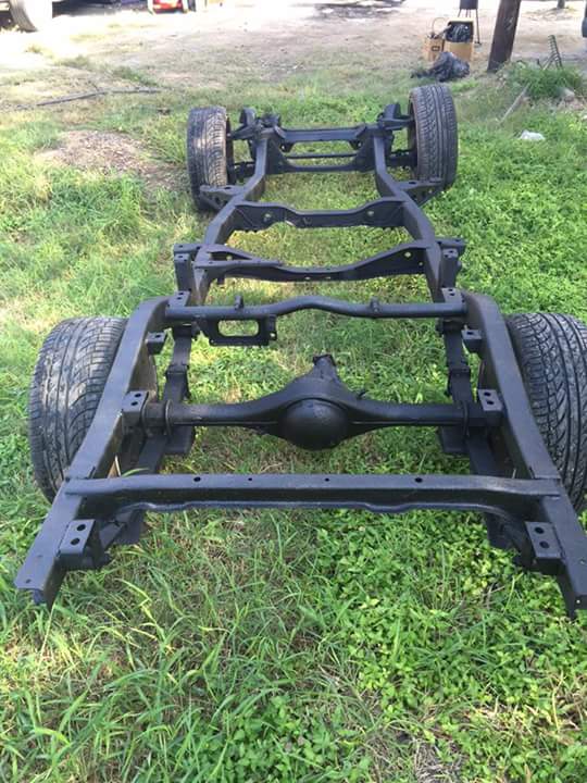

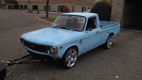

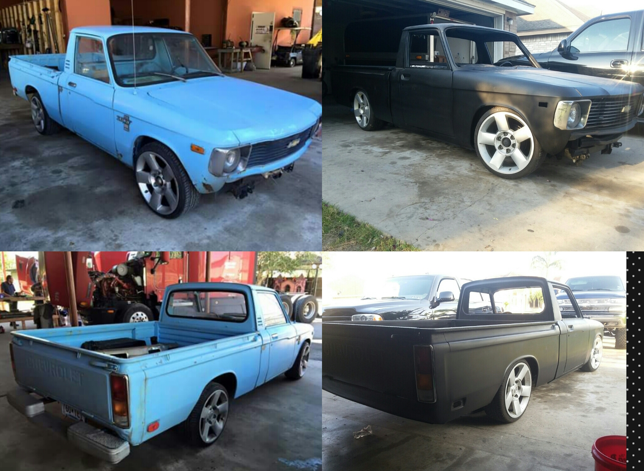

I just gonna post pictures of my project. Any questions feel free to ask.

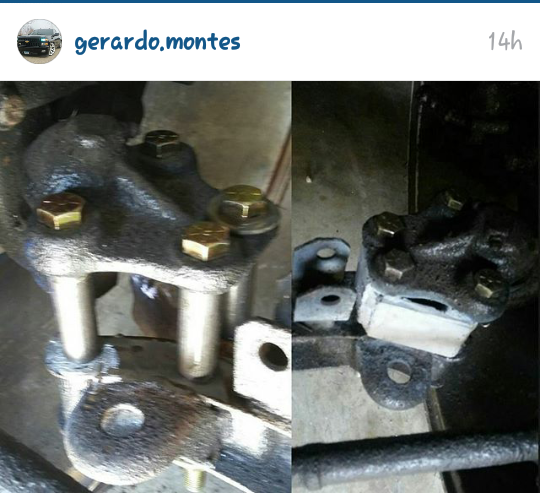

montesgerar wrote:
You did a lot of work with the body. Looks great.
Did you put a spacer under the ball joint (not sure if the pictures are displaying in the quote, but it has the name of the picture at least)?
PostPosted: Tue Mar 01, 2016 3:30 pm
Posts: 83
Location: Minnesota
Zane wrote:
yeah we took all the truck apart and we sandblasted all parts and chassis.
yes those are the lower balljoint spacers. i made them with steel tubes (2") and 5/16 steel plates. its very solid and strong, looks like it works pretty good. also i made some cuts (and welded after) on the upper arm to get a better balljoint angle. bump stop is removed. i currently making some brackets for the coilovers.
