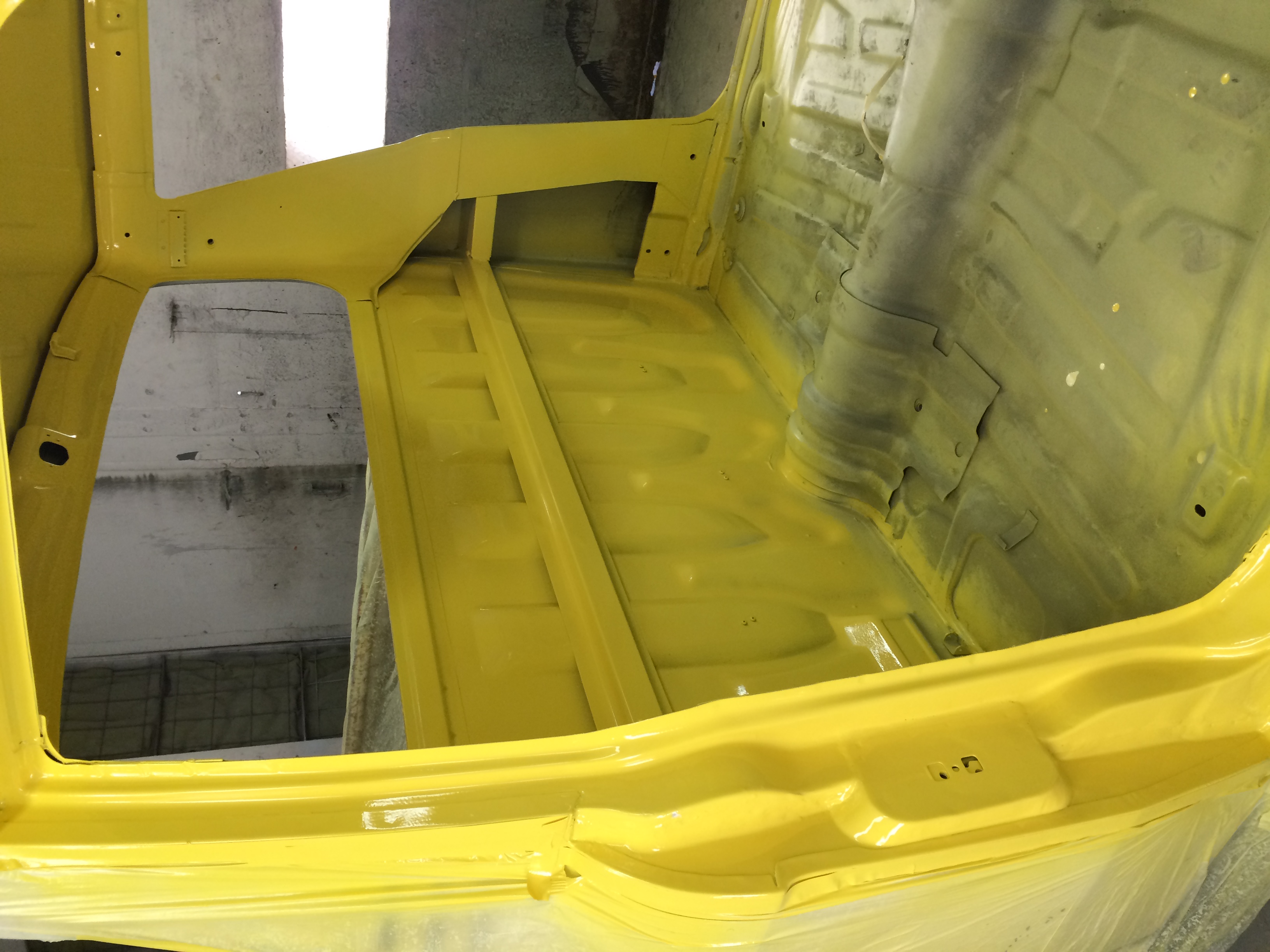

PostPosted: Wed Nov 25, 2015 6:40 pm
Posts: 262
Just got it back, not bad, good enough for me. Not the Jasmine color but close.
PostPosted: Wed Nov 25, 2015 6:41 pm
Posts: 262
2
