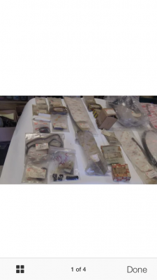

Got this lot of luv stuff also. I'll know if it was worth it once I get it. I wanted a new hood locking mechanism that I fell asleep on.

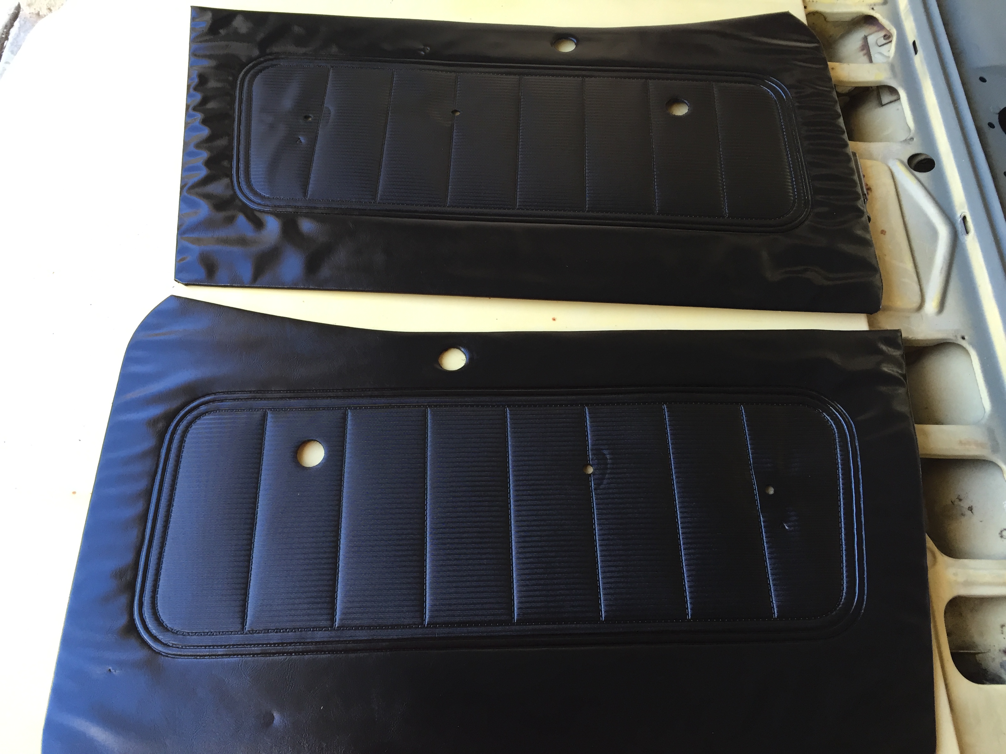

I painted the panels with vinyl paint.

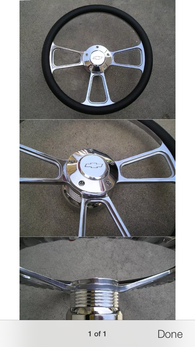

I'm looking to buy an aftermarket steering wheel but can't find the adapter kit to install it. I searched this forum, Ebay, the Internet and nothing. Does anyone know where to get one?

I did some more research, for those who need the information, the part number is grant 4164 for the aftermarket steering wheel installation kit. I bought the steering wheel above along with this kit, I was told it would fit.

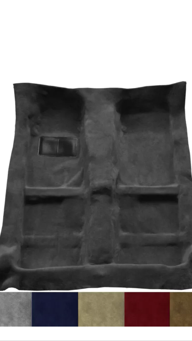

I also bought a black carpet kit, some sound deadener, and a used pair of door latches ( one of the ones I had were broken).

For those looking to change to the aftermarket steering wheels. I received the steering wheel and kit but was missing one piece. It's a 1" spacer, part Numbers g10-p from Forever Sharp. This will allow for this steering wheel to mate with the kit and steering wheel.
