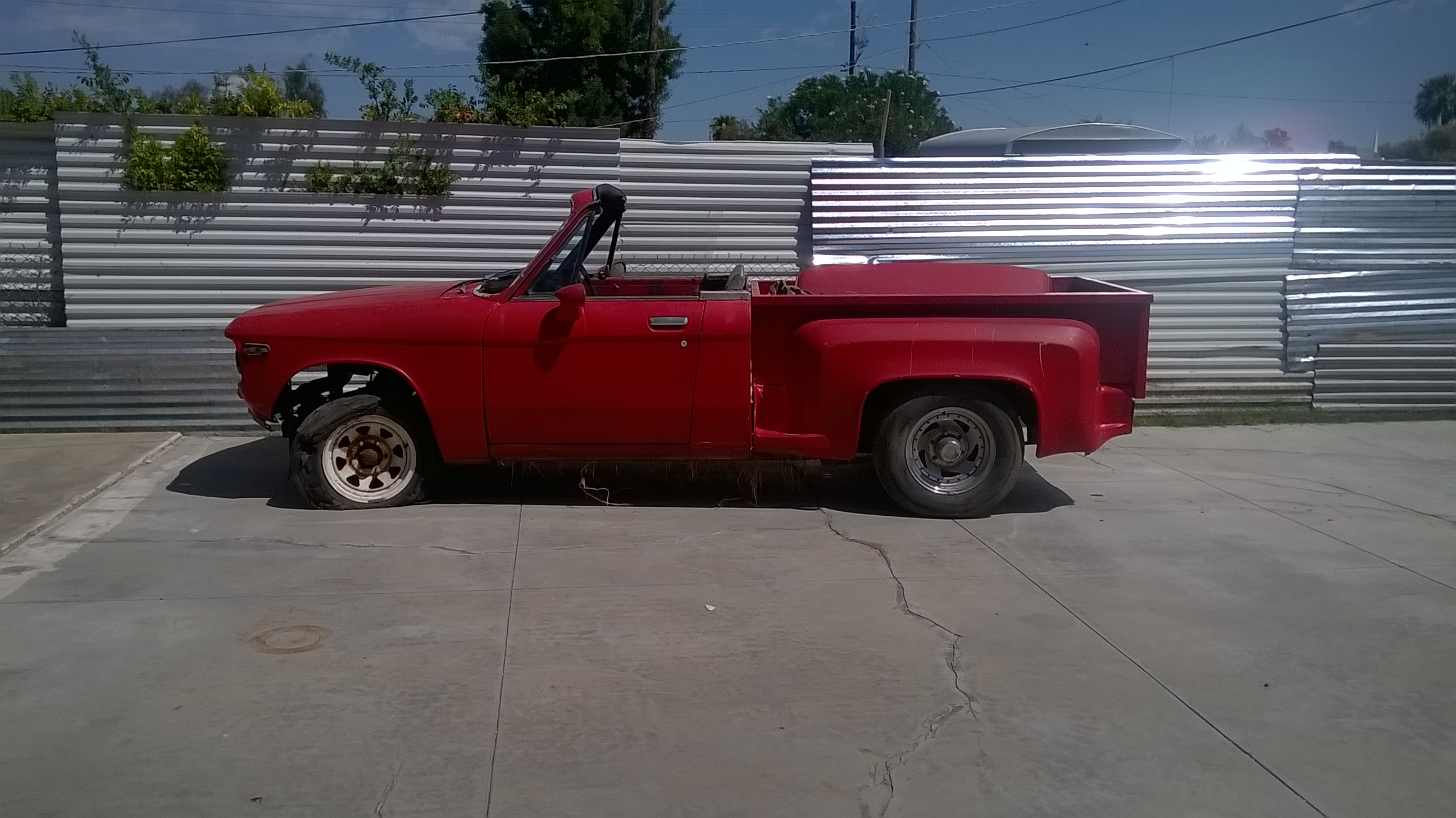

Hi I'm new to the LUV world, I just got a 1976 Chevy Luv stepside convertible project and I'm planning on putting a 5.3 V8 Vortec with a 4L60E tranny, but don't know where to start. What kind of motor mounts will I have to use. Will it be a bolt-in or weld to the frame. Any info and-or pictures would be very appreciated
File comment: 1976 Chevy luv

www.powerbyace.com has some bolt-in mounts that will work for what you have.

Well I checked powerbyace and I don't know anything about all those Motor mounts can anyone show me parts numbers or pictures of which would be the best mounts for what I want to do? Your help is much appreciated.
 Post subject: Re: My 1st luv
PostPosted: Wed Oct 07, 2015 4:40 pm
Looks like part number 10214K2 is what you need. Might want to contact the guy to make sure first. His email is tech@powerbyace.com. He s also on this site if you want to contact him via PM. Member name Old Rob.
http://www.powerbyace.com/Catalog%20pag ... onents.htm
