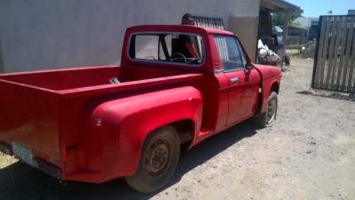

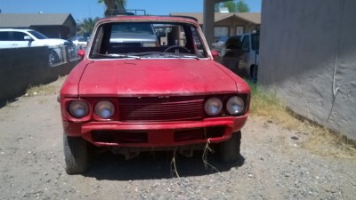

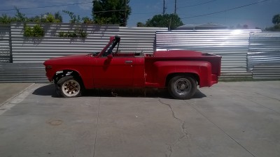

Hi I'm new to the LUV world, I just got a 1976 Chevy Luv stepside convertible project and I'm planning on putting a 5.3 V8 Vortec with a 4L60E tranny, but don't know where to start. What kind of motor mounts will I have to use. Will it be a bolt-in or weld to the frame. Any info and-or pictures would be very appreciated

www.powerbyace.com has some bolt-in mounts that will work for what you have.

Well I checked powerbyace and I don't know anything about all those Motor mounts can anyone show me parts numbers or pictures of which would be the best mounts for what I want to do? Your help is much appreciated.

Looks like part number 10214K2 is what you need. Might want to contact the guy to make sure first. His email is tech@powerbyace.com. He s also on this site if you want to contact him via PM. Member name Old Rob.
