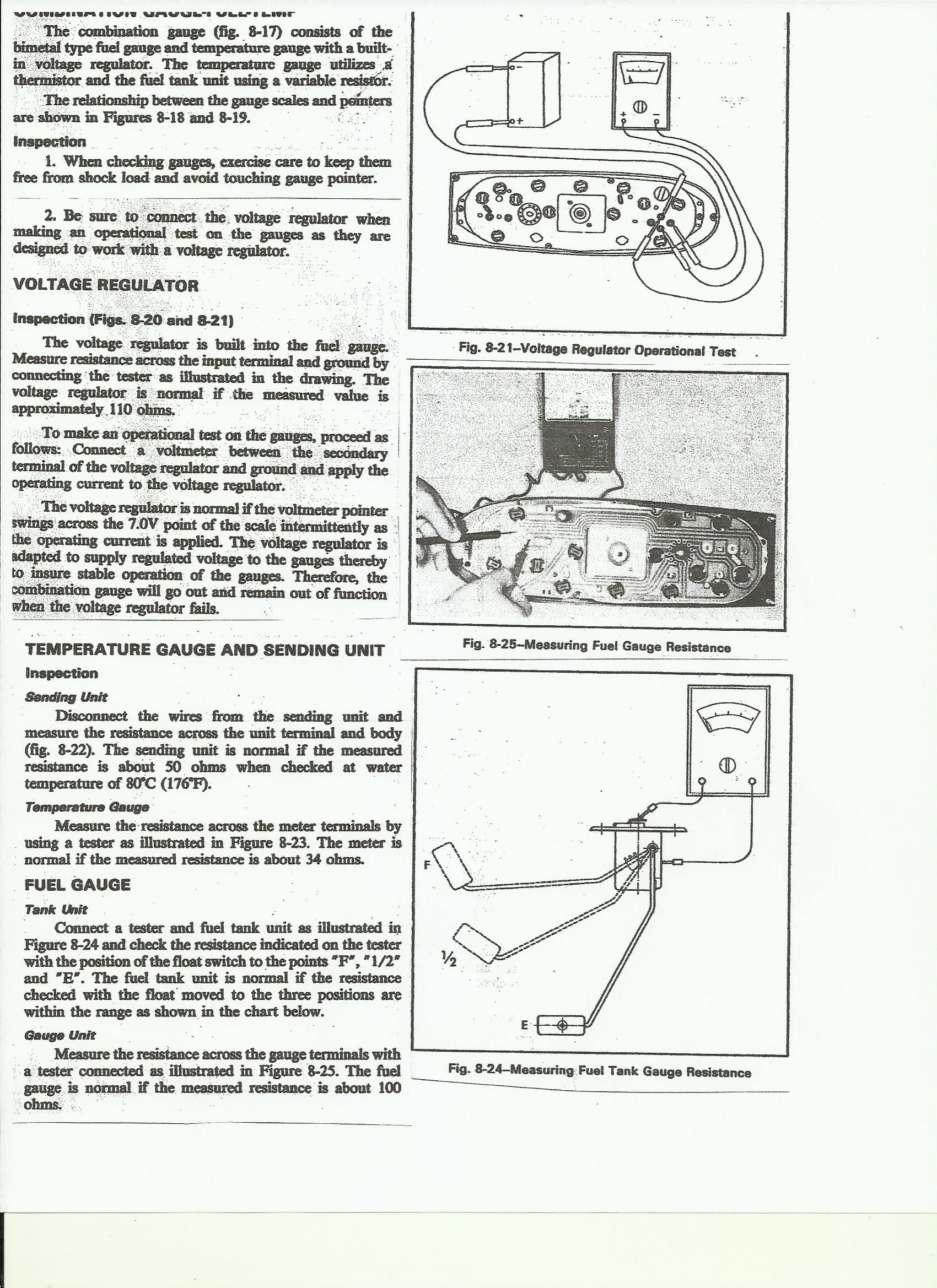

EVERYONE: Please let people know what truck/year/engine you are asking about when you want help-sometimes it makes a difference.
This is info on a 1980 gas LUV, hopefully this will give you what you need.

So ground the wire that goes to the fuel tank sender. It should pin the gauge. If t doesn't, your gauge is bad. If it does, go ground the wire near to the sender. If it doesn't pin, the wire is bad, if it pins, then your sender is bad, or the sender isn't properly grounded.

"I have a '75 Luv with the beefy 1.8L"
Different engine than a '80 LUV, maybe the electronics are the same.
