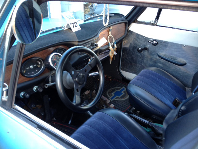

I went searching the local pick and pull some years ago looking for buckets for my LUV, and found some that work quite well, but might be hard to find. They came out of a 1988 Hyundai Excel sedan, which is not an easy car to find, but those early Korean cars were so terrible that they did not run long enough for the seats to wear out!
