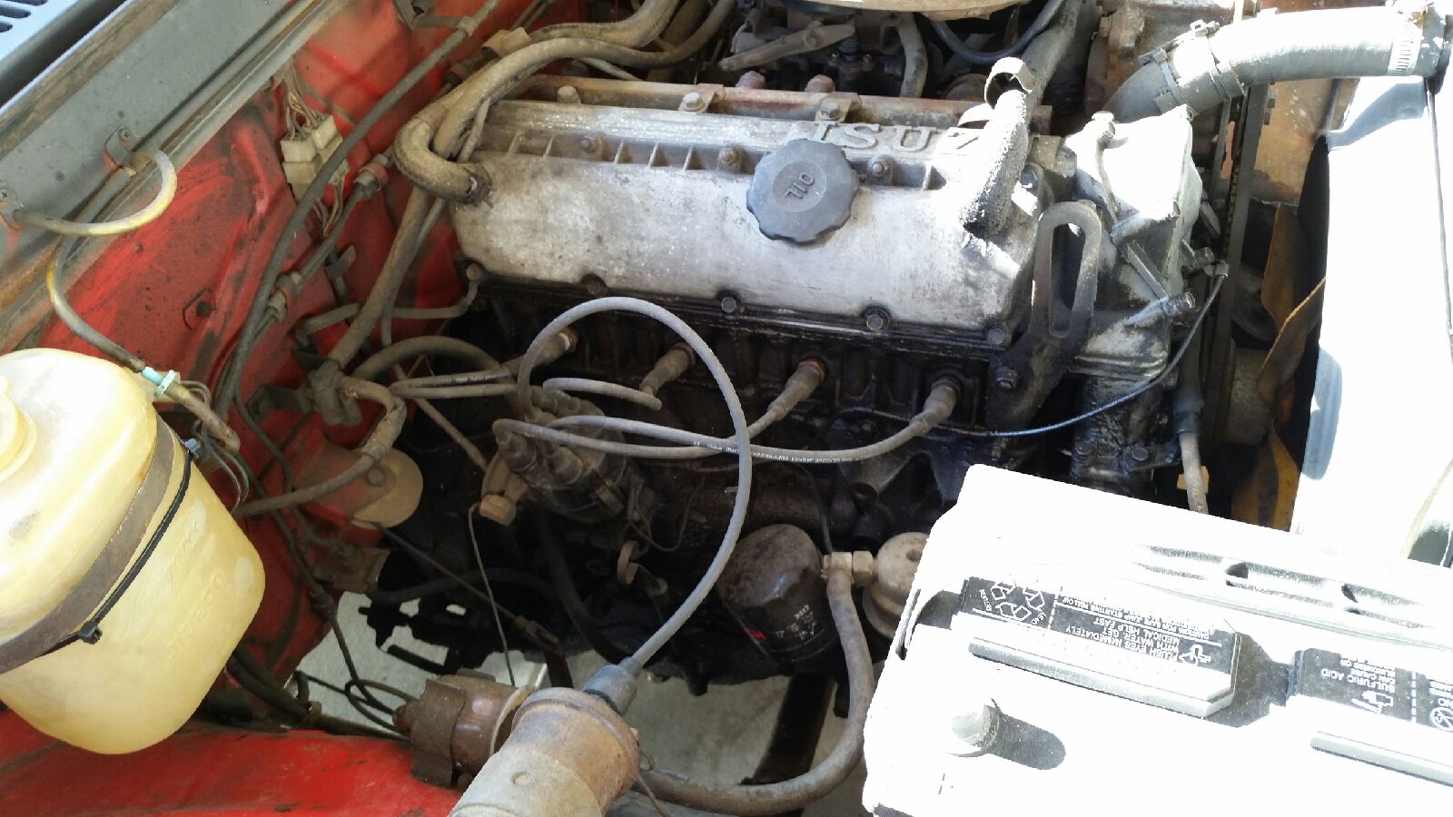

This how i looked like b4 i started to change them
 Post subject: Re: tune up
PostPosted: Fri Apr 18, 2014 11:09 am
That looks correct, 1342 going counter clockwise. Number 1 is closest to the front.

So from the front it does 1,2,3,4 ??
PostPosted: Fri Apr 18, 2014 11:35 am
yep straight and simple

I don't understand the confusion - you've got a photo showing how it went.

I didnt know where cylinder number 1 was :lol:

Yup from front to back 1,2,3,4 thanks Guys.
PostPosted: Fri Apr 18, 2014 2:11 pm
Save the picture and help out the next guy. It will come up again.
