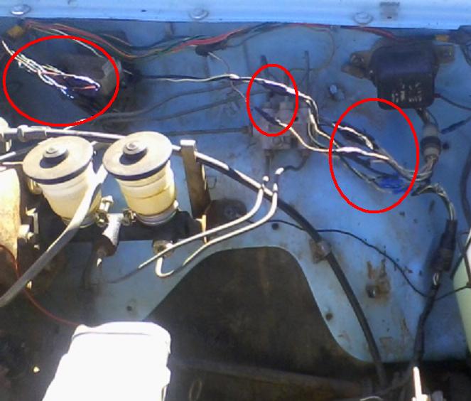

I will be replacing the fuse box with a set of 6 slot ATC type fuse blocks. Going to consist of 2 common hot feed 6 slot blocks, one block for voltage regulator, fuel pump and ignition, the other for lighting and other misc. electrical circuits.
Today the truck didn't act up at all. At first GEN light was off and alternator wasn't charging, then tapped the gas, heard the regulator click, GEN light came on and was getting 13.9-14.1 volts at battery after that, alternator charging and still nothing happening when fuses are removed. I do believe the problem does lie in either the fuse box or the hacked up wiring. Let it idle for almost 30 minutes and voltage regulator did not start clicking repeatedly and alternator was giving a good strong charge.
File comment: Circled in red are hack spots (hard to see crappy cell phone pic)
Areas circled in red are what bother me. Crimped and twisted together wiring with tape (you should've seen how much tape I took off!) Definitely a issue for me, harness is probably full of electrical resistance and corrosion, along with the fuse box needing replacement. The worst of the hacking is in the wiring that goes to the bottom of the fuse box.

Pulled apart wiring, made some patches and started hooking everything up the way its supposed to be, and removed all the temporary wiring for ignition and starting and fuel, and hooked them all up to their proper pig tails in the stock harness.
Came to notice the fuel pump relay is not working. No power to fuel pump unless I jumped power to it (BR wire) from the relay connector. Also noticed that, according to Series9&10 wiring diagrams wire B on the voltage regulator (WR) runs from the voltage regulator directly to the fuel pump relay.
How important is the fuel pump relay and resistor bypass relay to the voltage regulator? With the temporary wiring I had set up it completely bypassed both of those relays on the passenger side of the engine bay.

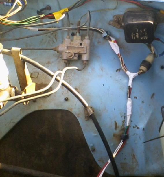

Removed the hacked up wiring for the alternator/voltage regulator and re-wired it with new wiring. Used the heat shrink type crimp connectors. I hate using crimp connectors honestly, but better than twisting and taping wires. Also, soldering iron seems to have grown legs and disappeared :(
File comment: New wiring for alternator/voltage regulator.
I figured I would have fun with it while I was going through the harness. All ignition wiring is labeled with blue, lighting is labeled with yellow (as was stock wiring?), and voltage regulator/alternator labeled with white, taped to hold it together underneath the coverings, and to aide in wiring identification if I ever have to go back through.
Removed the voltage regulator wires from the stock fuse box and ran them to a new 6 slot ATC fuse common hot feed panel. When running GEN light is no longer on constantly, and FASTEN SEAT BELTS light turns on with the key and turns off about 30 seconds after. Then turns on for another 30 seconds after engine starts, then shuts off again. (Normal?)
...and still no voltage regulator issues. Battery is charging normally with 13.9-14.1 volts.

And (above) is what remains, the mess of wires there by the fuse box will be sorted out and fixed up (thats the other area of hacked up wiring, still working on fixing it.) Perhaps the flickering HEAT light will disappear once I finish up with the harness?
Also, the black coverings you see are what I am using to cover the entire harness. All the wiring on the opposite side of the engine bay has been repaired and covered. (Will get pic in daylight tomorrow.) All that remains is the hacking that was done by the fuse box, and installation of second 6-slot ATC fuse panel for remaining electrical items.

Good job on the rewiring, looks quite professional. Not surprised that fuel pump circuit from Z car works for the Luv, as the Nissan 240 Z had the very same fuel pump as the Luv. If you ever need to order a stock Luv fuel pump and they say no listing, just order one for a Nissan 240 Z which they probably do have, same pump.
That whole pump, relay, regulator circuit was mandated for safety only. In an accident the motor should stop, alternator will then stop, fuel pump will stop, and not continue to pump gasoline on a maybe burning vehicle. All vehicles now do this and that was the way Luv decided to do it.
