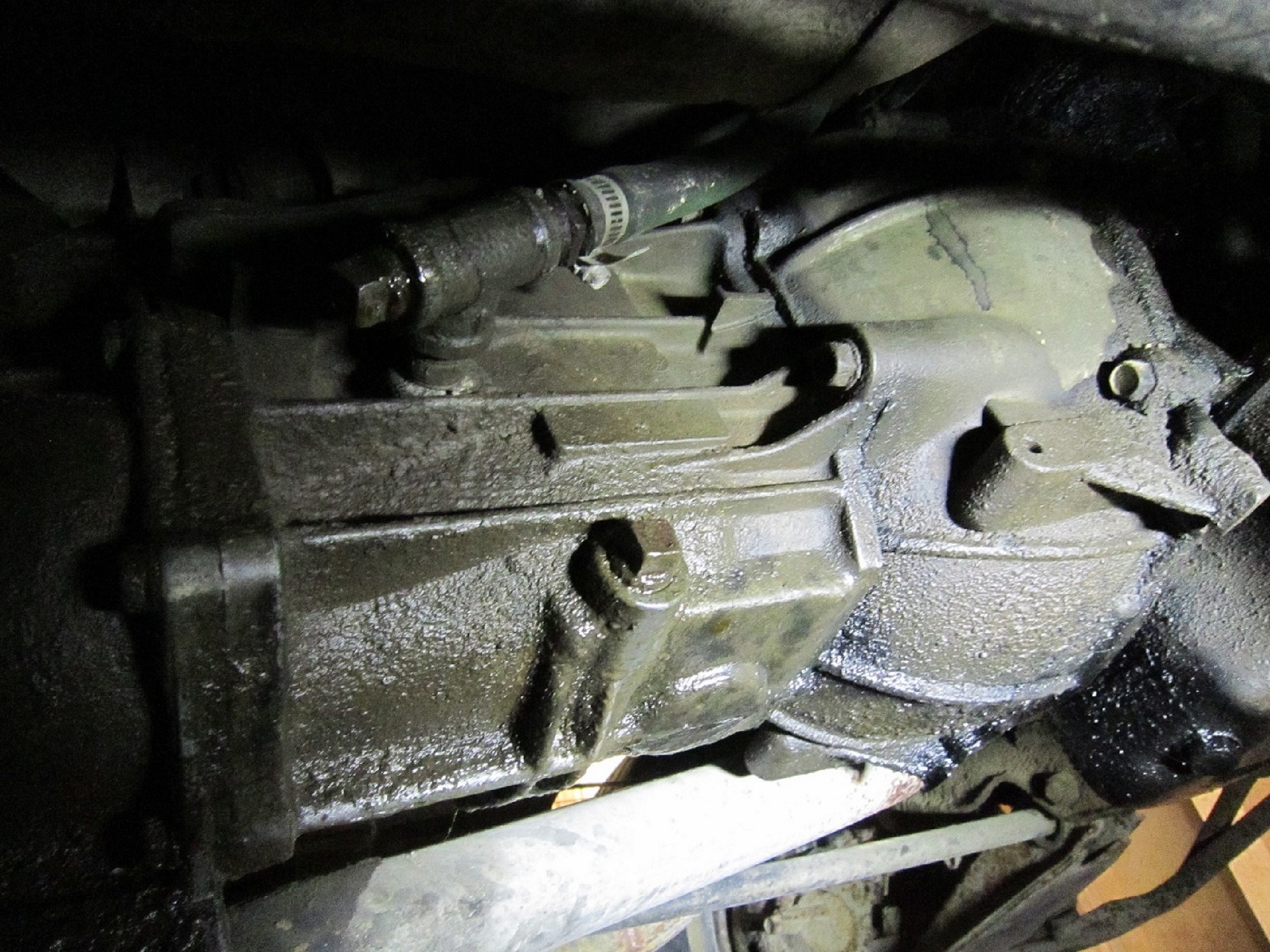

I got the truck in my shop and took some pics of it but when i try to upload them from my card it just says invalid file???what am i doing wrong? . Some things i found are water pump is leaking and vac pump does not work..

I finally figured out the pics were to big, so i resized them and it worked. So take a look at them and tell me what you think.

Yes, it's definitely the GM version of the engine, and it's pre-'84. You may have a tough time finding a water pump for it, because it's not the same water pump that the Isuzu version uses. GM used their own water pump and thermostat housing so that they could use the same radiator as their gas-powered S10.
The transmission is also GM (Borg Warner) as you said. And the vacuum pump is right out there for easy access. The turbo setup is all aftermarket.
