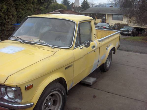

You could always make it a parts truck and save yourself a ton of time and money? There are Luv's all over the northwest to pick from.
This one already has a V6 and has been listed for quite a while so the $1200 price might be negotiable by now.
http://olympic.craigslist.org/cto/4093254250.html
