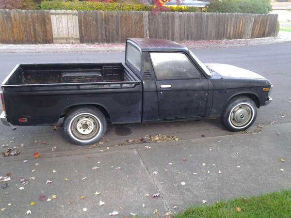

I just bought a 78 chevy luv, It is an Auto trans the truck runs and drives but needs to be shifted into nuetral while stopped at stop lights etc. If shifted into drive it will lurch forward and stall out.
Any ideas, Torque converter? if so part number?
Does it have a torque converter solenoid switch?

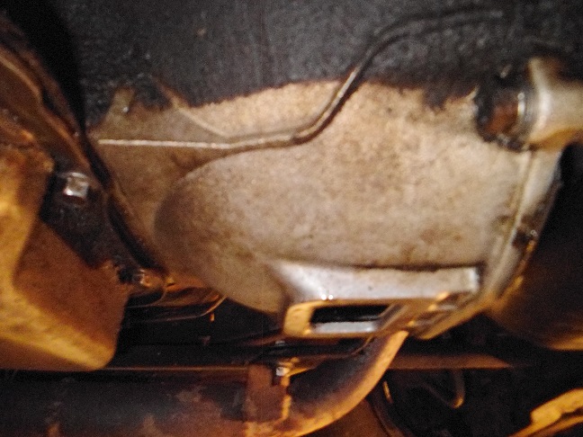

thank you for the reply, it is a 2wd automatic,
the engine is marked G180
I think the transmissions is stock, but I'm not sure. included are pictures
the transmission had a metal tag on the back that was stamped (360) not sure of relevance, maybe a rebuild tag.

UPDATE:
So I think the truck had been sitting for years when the guy I bought it from picked it up. I think the torque converter might have been seized from sitting. I bought 2 in 1 transmission repair in a bottle and put the half quart in, shifted it in gear and fixed! think all it needed was a good lube.
