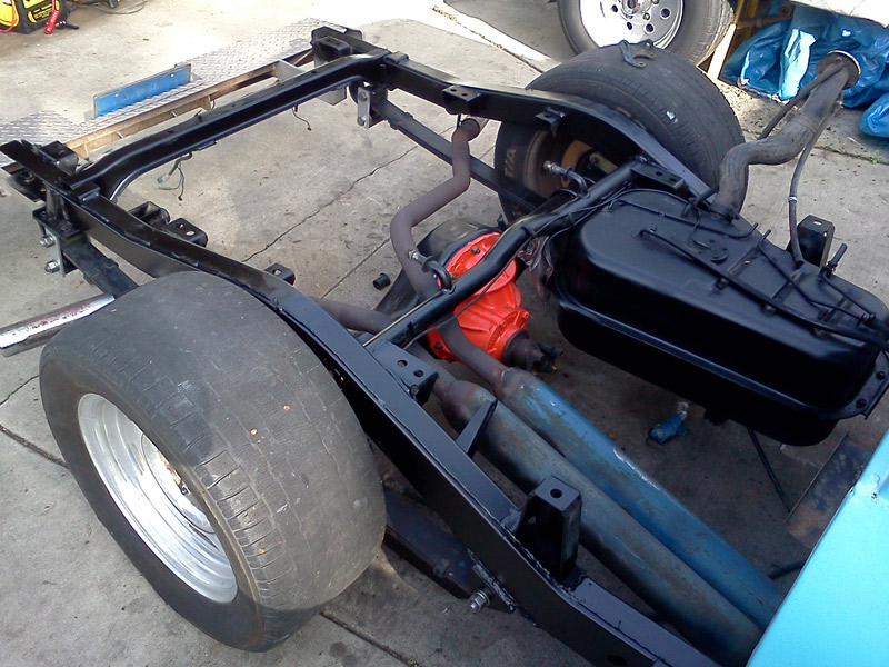

I would suggest you pull the bed off so you can do it right. I took a cup wheel to my frame and then painted it up with some rustoleum. Its a lot easier to work when the bed is off. Its not too hard if you have a cherry picker of a few strong friends.
