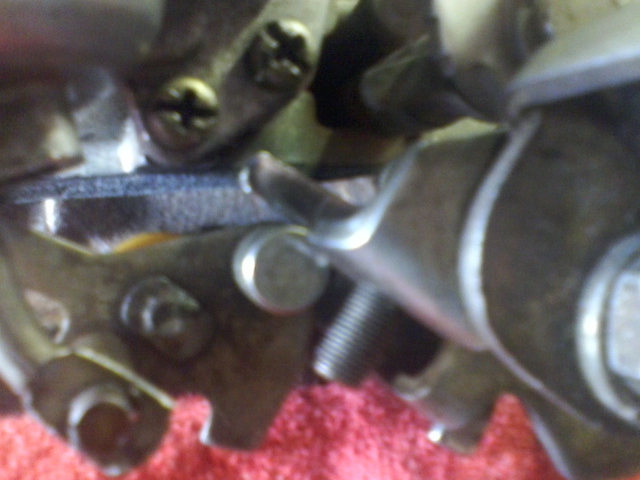

So I'll post it here instead of my carb rebuild thread since this relates to more possible missing parts?
I noticed the secondary was staying wide open, which is causing my high idle issue (I think?).
I noticed that the metal arm on the throttle linkage was dangling below the secondary linkage. It's supposed to sit on top correct? When moving the throttle only the primary valve opens, while the secondary stays open.
I took the throttle linkage apart and re-aligned the metal arm, shown in the attachments. (Circled in red in one of the two photos.) Now when moving the throttle both secondary and primary valves open, but the secondary won't close all the way and if I use my finger to push it closed all the way, the throttle won't open at all...
When on the motor the throttle seems to get stuck, if I mess with the secondary to free it up (opening it slightly) the truck lets off a loud BAAAA then dies. BUT it does idle more normally now... My problem now is the sticky throttle...
Note: when doing this I had the carb upside down on the table so that the throttle valves would not get bent up or snagged on the table.
File comment: A view, this part of the carb faces towards the fire wall. Area circled in red.
File comment: Close up of the metal arm that was dangling down below its current location...?

Here are some pics of the throttle valves "closed" and "open".
You can see in the closed pic how the secondary stays slightly open. If I push it closed it locks up the throttle and is hard to get the throttle open.
I've also notice how the primary won't open completely when I hold the throttle open. Whoever rebuilt this carb must've got some pieces backwards?
