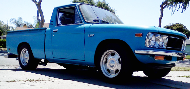

I cleaned the plugs opened the gap a bit and its running so nice right now. The 3.0 gear lets me cruise at 2500 rpm on the freeway. I polished the wheels over the last week and I am digging them even more. I hate to tear it all apart but that oil burner 307 has to go. I have the 355 pulled back out and I am ready to start on it.
I have been cruising it around quite a bit
