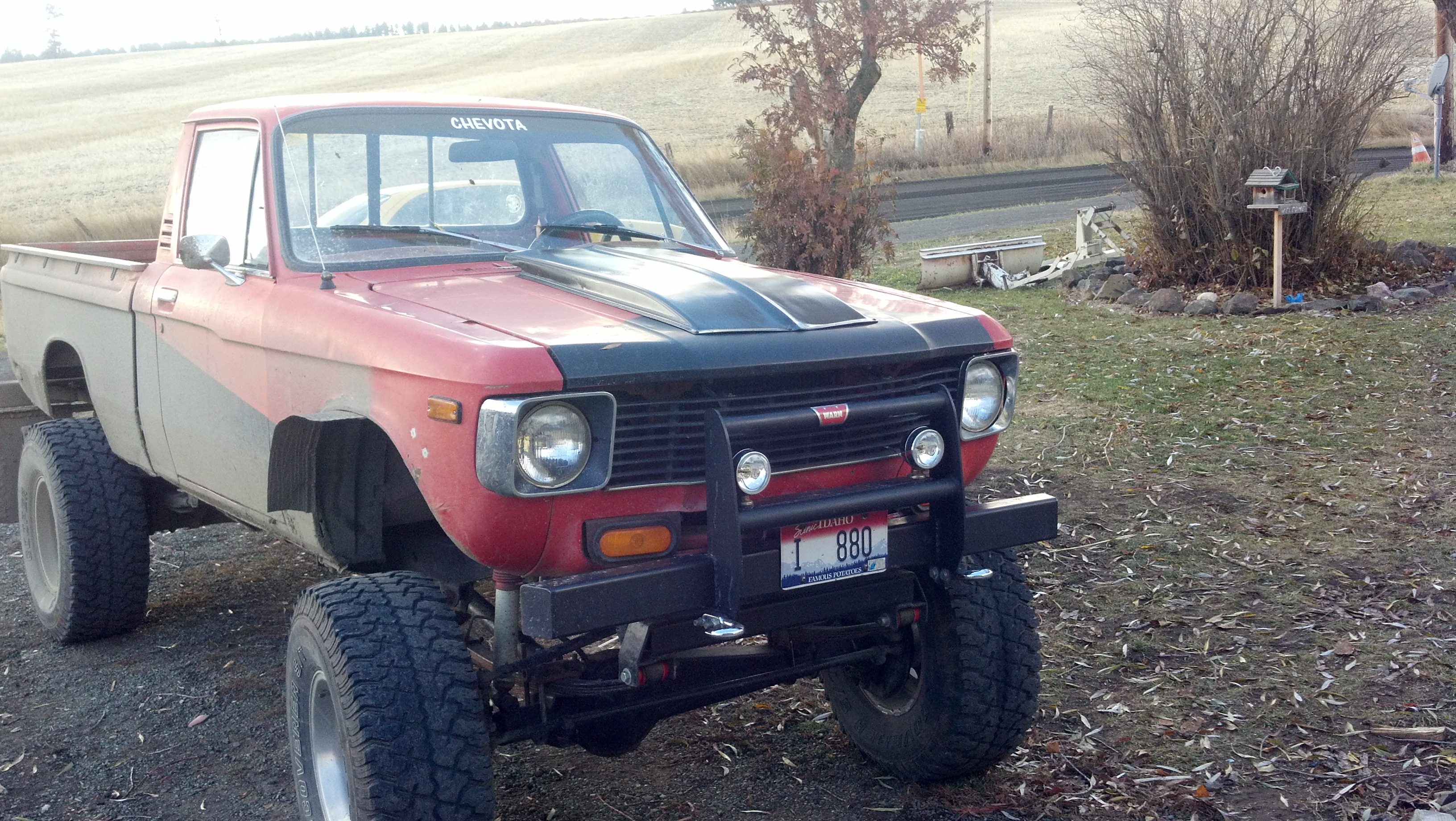

I like it very cool i did it the other way 94 rear84front with 1.5 spacers front
File comment: Here is mine
