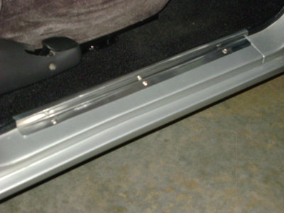

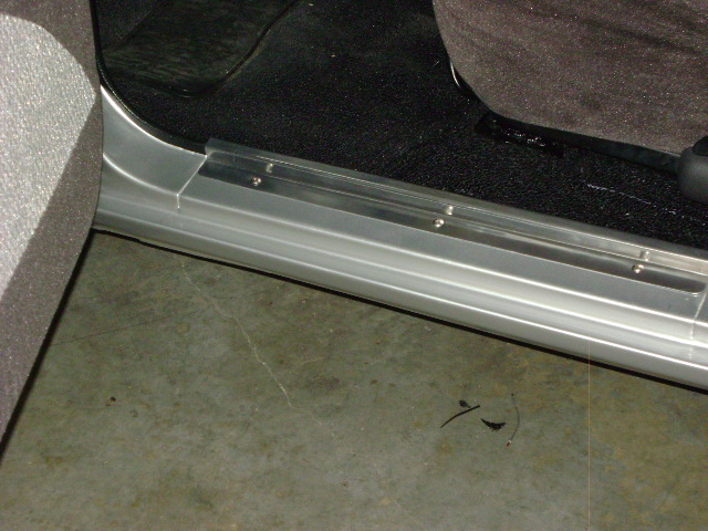

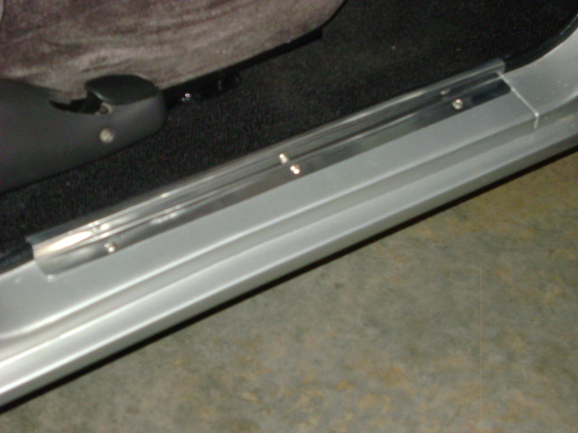

we made some new door jam plates for the luv . we made them a littel longer to cover a littel more of the door opening .its really easy just bend here fold there and try 5 more times and youll get it .

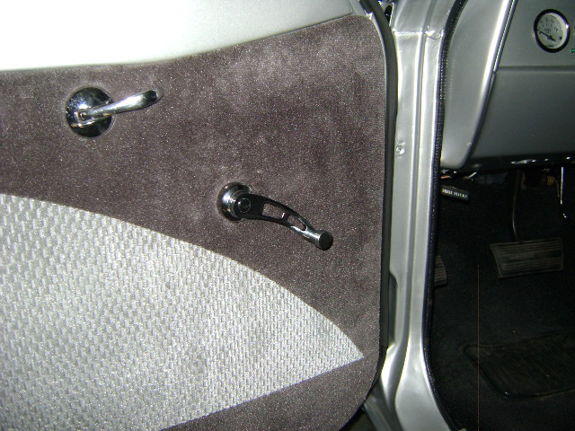

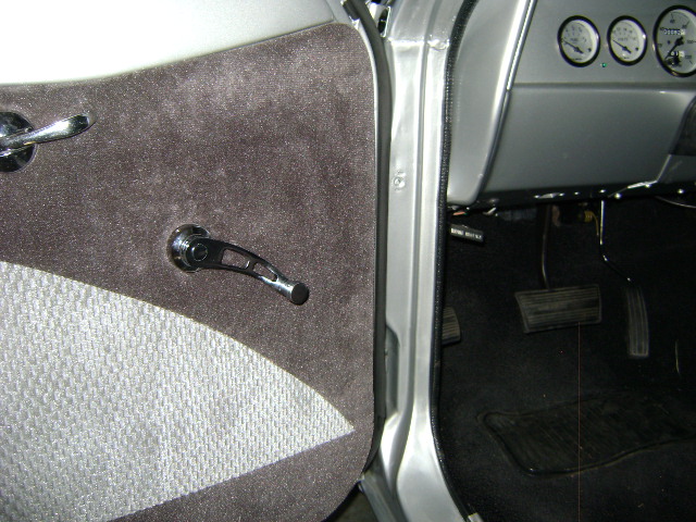

new sickspeed window crank handles .

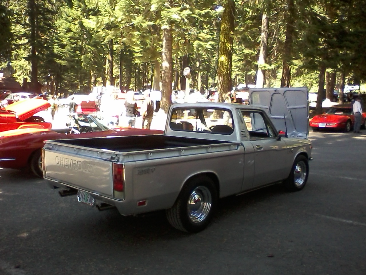

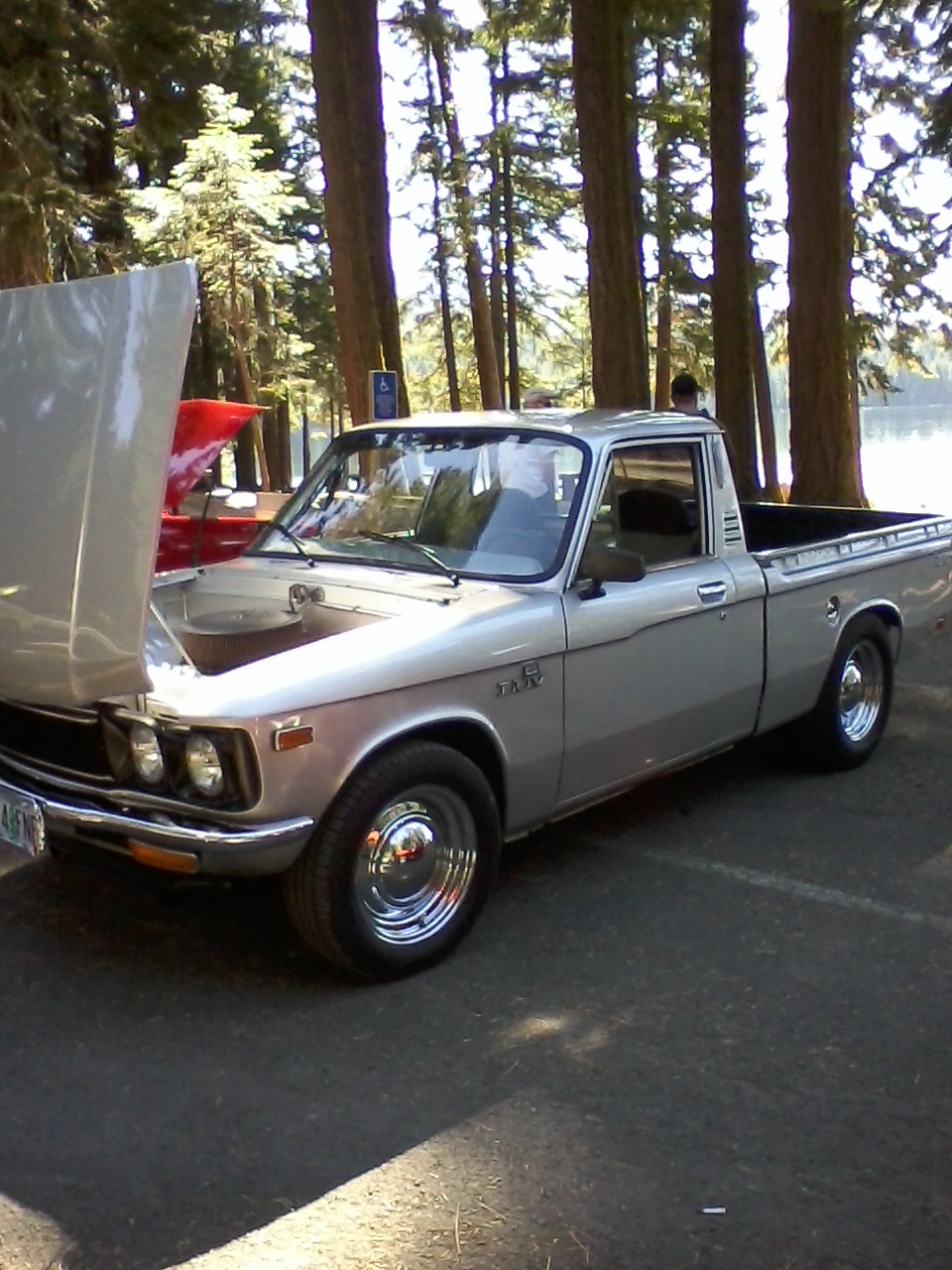

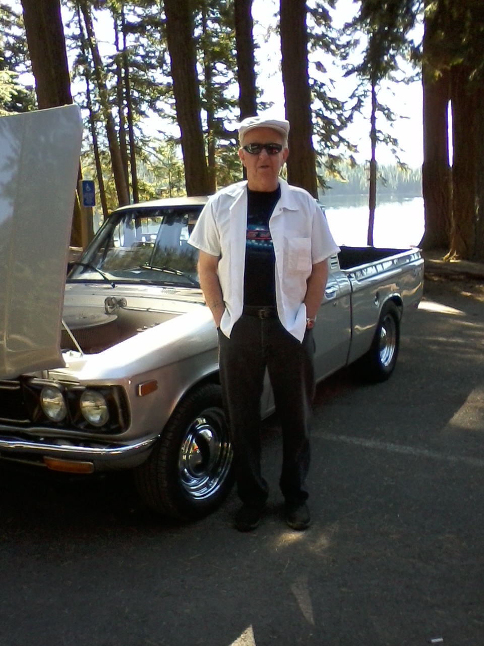

thanks luvtrkr thats about the nicest thing said about the project . again thank you . the luv with some other cars
and the owner at his first car show ever

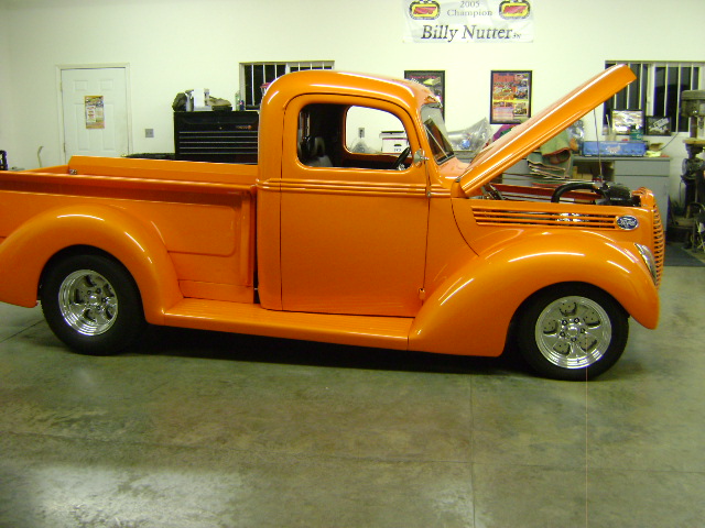

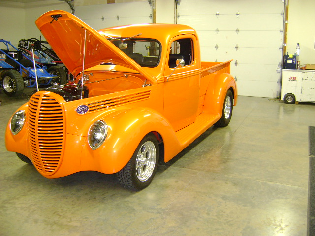

the new nutter perforamance project 1938 ford with 350 chevy and 350 trans . getting a not tired 350 vortec and a 7000r4 trnny should be fun as long as we dont scrtch it lol .

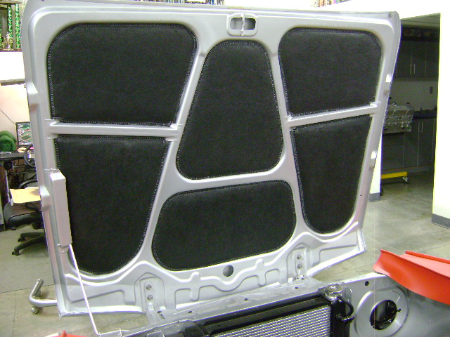

thanks mytmouz . going to put under hood insulation in before we go . the cross bars and the goop that they used to hold the hood to the inner looks like chit . well post pics of it .
 Post subject: Re: Norms 75 luv build
PostPosted: Sun Feb 03, 2013 8:46 pm
Posts: 158
Location: cental point oregon

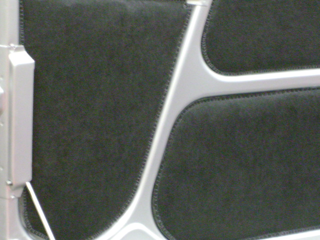

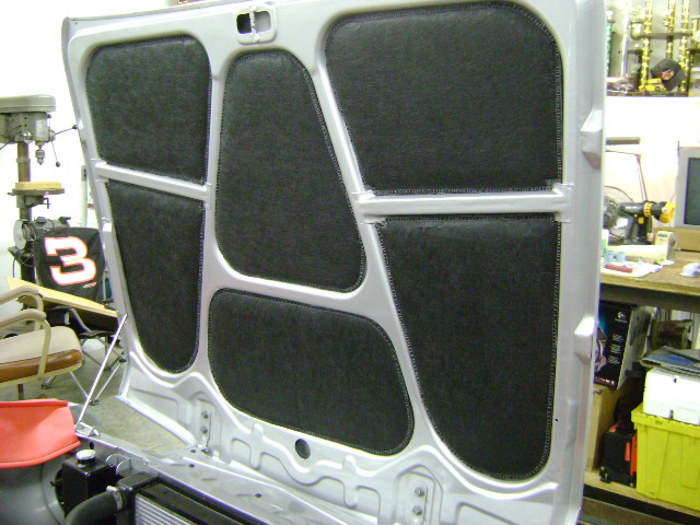

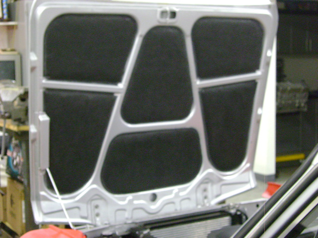

this is what we came up with as far as hood insulation . what do ya think
Loving this. Going to have to do that to mine.

hey zelda64man we got the insulation from Metro molded parts . http://www.metrommp.com/ this is aloso where we got all the rubbers and window sweeps and door seal for the doors on the luv

seeings as im explaining thinga michell told me i should explain the hood insulation to yall. what we did was get the insulation witch was one big peice , then we made templets of the pieces that we wanted to fill and cut them out and then michell sewed the edges with what she calls a blanket stitch [ a setting on her sewing machine ] and then we glued them on with 3m extra strengh heat resitant clue and there ya go .
