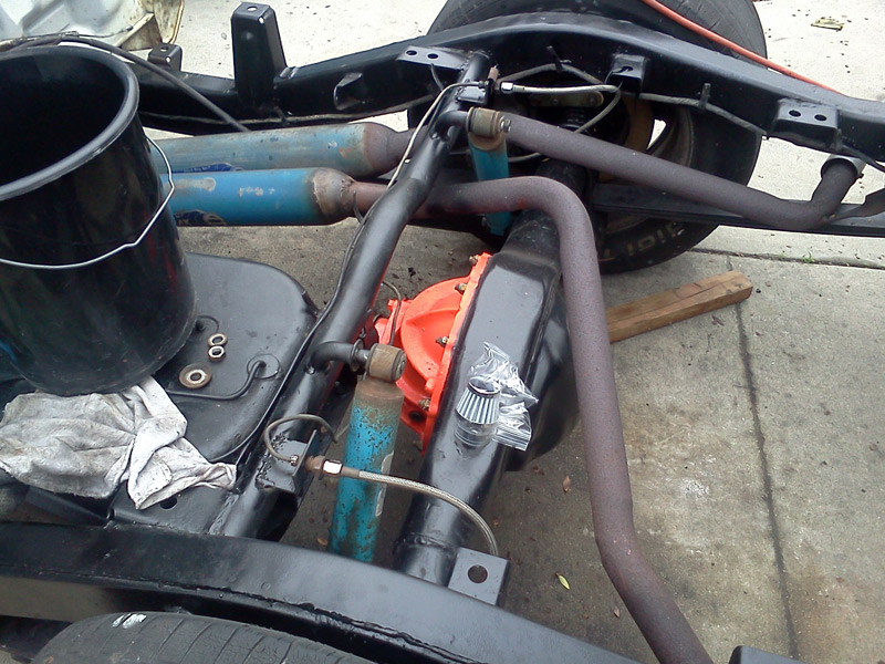

I did some franken welding today putting the brakeline brackets on. I haven't been welding long and it shows. I have to make a new brakeline for the driver side. The old one was routed where the gas tank sits. I might make a new one for the other side too since i will have the tool.
Welding next to the gas tank is a trip

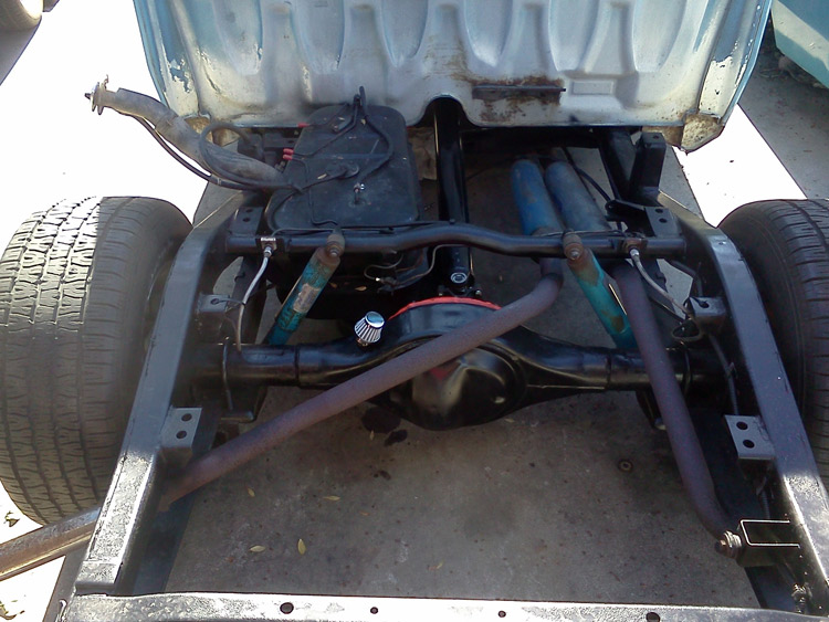

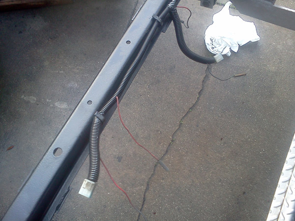

I got the brakelines in and wrapped the wiring all the way to mid cab, I will do the rest when I swap the motor. When I mocked up the driveshaft it is indeed too long and will need to be shortened about 1.5 inches. It was all set up for the 4.3 that was in the 76 which I assumed would fit but doesn't. My old driveshaft could probably work if the flange for the diff was swapped for a u-joint but the new driveshaft is a larger diameter and much beefier. I usually don't start a project in winter as they tend to drag on due to getting dark at 5 and rain. I have never had a garage to work in so its all done in the driveway. I am so ready to be finished!

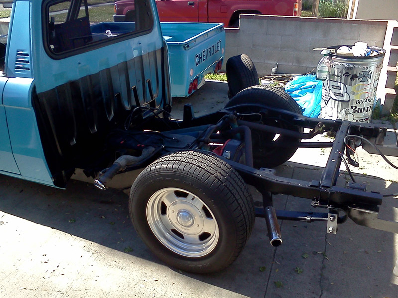

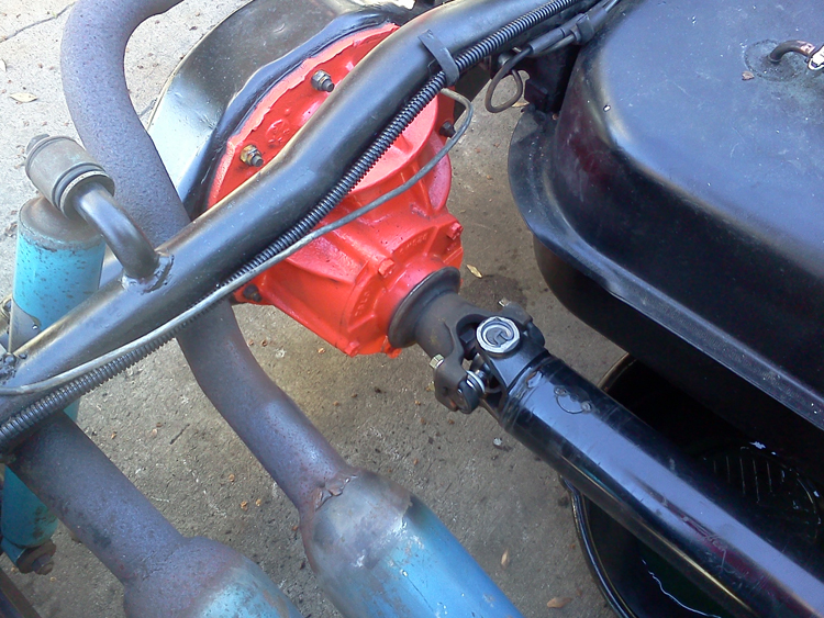

Got my driveshaft back and had the tires swapped over. The guy at the tire store told me my T/A radials are $150 a piece now. 8O I didn't have anyone home to help bleed the brakes but I am closing in on a road test.

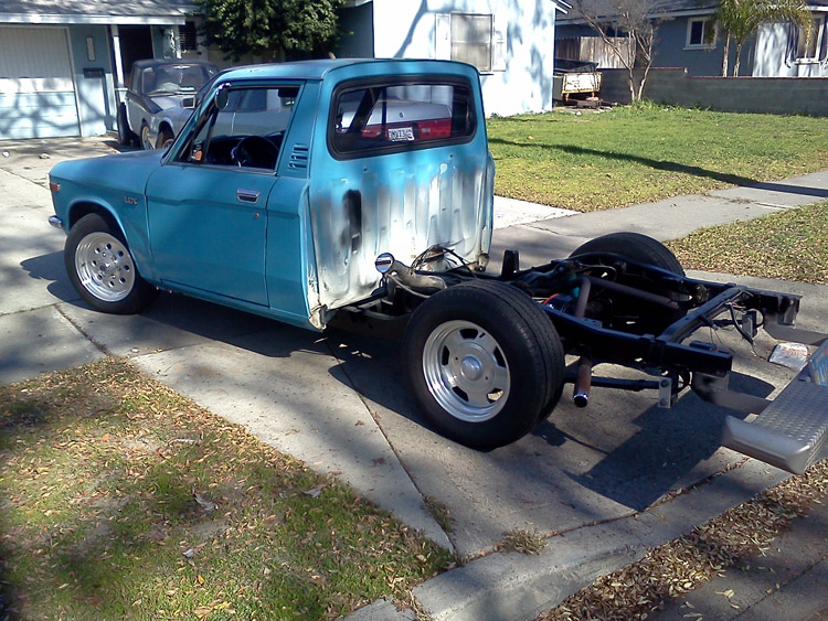

I left the 1/4" wheel spacers on and am happy with the frame clearance. it looks like the tires will tuck nicely too

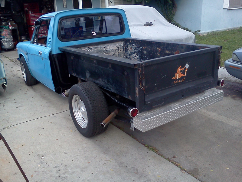

I got the stepside bed on today and the 55 Chevy tail lights. I'm going to find some c channel to put behind the diamond plate bumper cover. The fender bolts I bought were too big and the exhaust hits the bottom of the fenders. I'm going to cut the ends off and put down turn ends on. When I was mocking up the fenders it looks like I have room for 15x10s, the rear is so tucked in. The 245 60's looked small.
9 inch is looking good under there

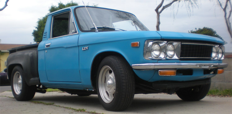

Awesome day to wrap it up. Its a running driving truck again and not a moment too soon. It was about a 3 month job for and old fart to accomplish. Now I am going to take a break and rest up for the engine swap.
