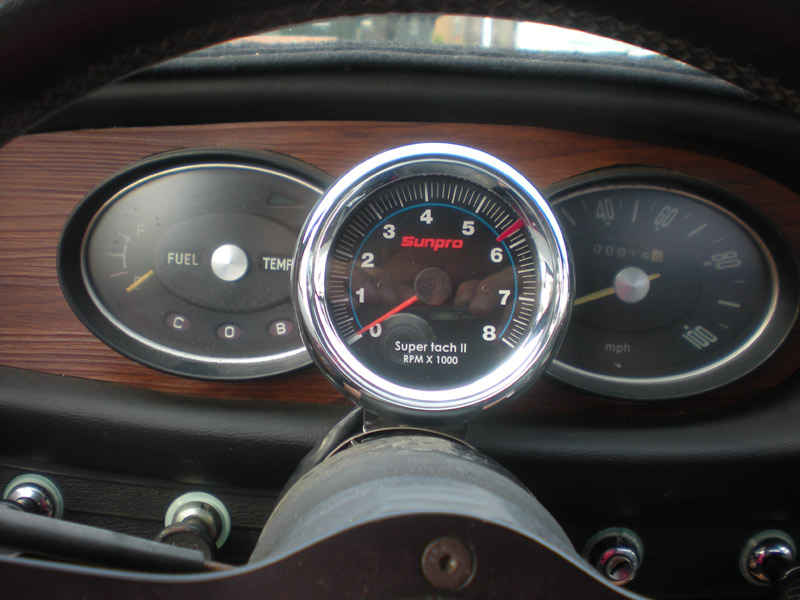

I installed the tach I got from Jonathonlo today. The wiring diagram helped, I am not good with wiring at all. I want it there for the new motor break-in, I just need a few more parts and I'll get started on the swap.

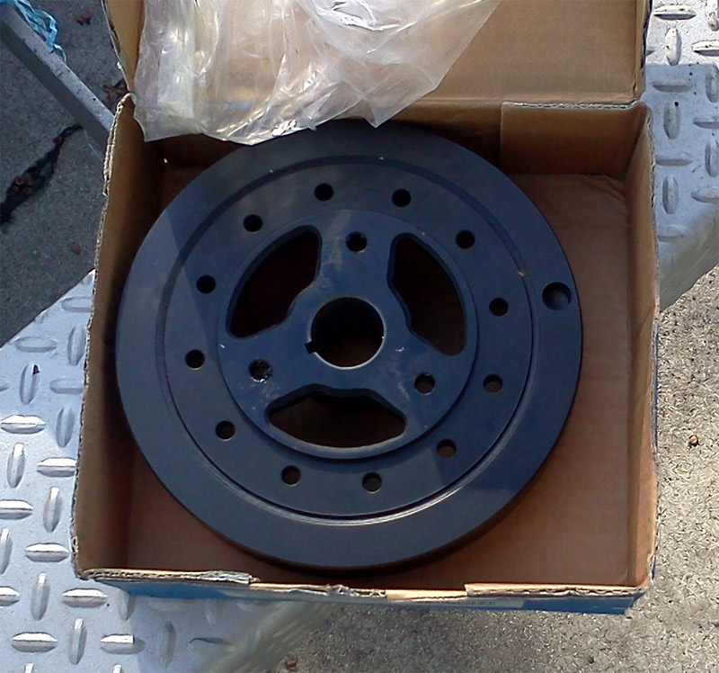

Its a great time of year for craigslist. I picked up a new harmonic balancer and a set of block huggers for next to nothing yesterday. My times being eaten up working on my companies Isuzu NPR I have to prep for sale, so not much progress this weekend.
$10 never installed

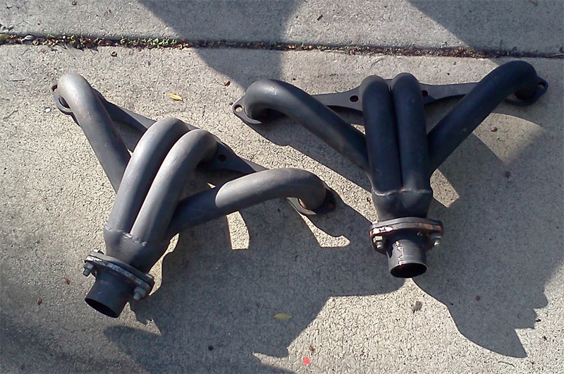

$40 mocked up on truck but never fired
