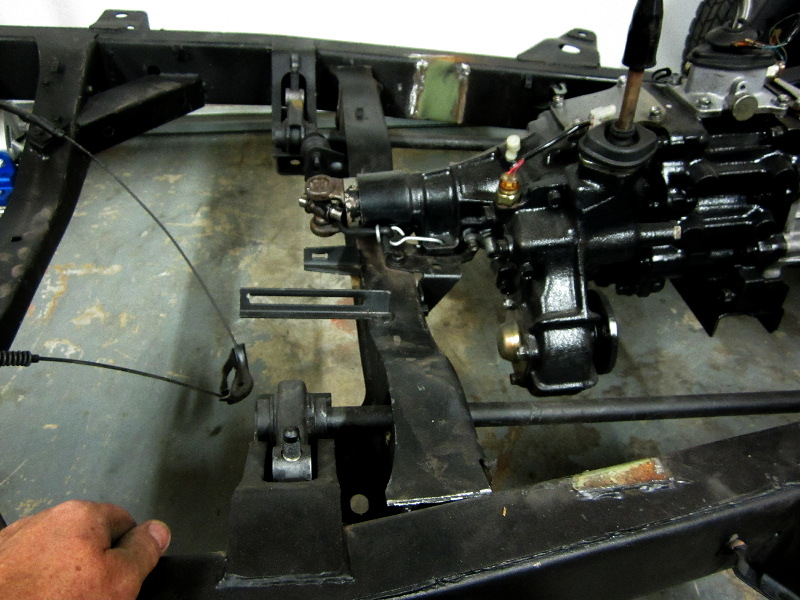

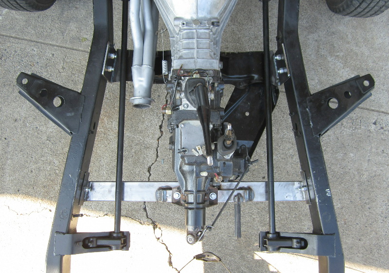

PostPosted: Sat Aug 11, 2012 6:28 pm
Posts: 157
Location: Spokane Washington
Well it's finally ready to go, the new cross member is now fabbed and welded so that it's all removable (thanks to my buddy Ron who welded them up for me - He Did a REALLY nice job!).
We went with two cross members, one in the Trooper location and one at the tail shaft as the Luv used. The forward cross member was cut and dropped a couple inches, bracket ends added to allow it to bolt in, then rewelded in a similar fasion as the example posted by TJ White earlier on this thread (thanks for that idea, worked great!). The final hieght was determined by measuring the transmission mount from the frame to the ground then adjusting to the new location while the tail shaft was on a jackstand at ride hieght. The Trooper skid plate was then cut, shortened, and welded back together so that it now fits the new location and looks stock.
The second rearward one was totally fabbed from steel rectangular tube stock, it wasn't really needed but it doesn't hurt anything and allows for a spot to hold the E-brake anchor points which were removed from the original cross member and welded to the new one, they are now a couple inches further back than original but still allow for enough of the adjuster bolt adjustment to hold the cables tight. It is also bolt in and removable. I'll be pulling it all off for fresh black paint before bolting it all in for good.
Now I can start bolting up all the drive lines and finish the running gear install. Next step will be adding the body back to the frame after paint.....Yah!

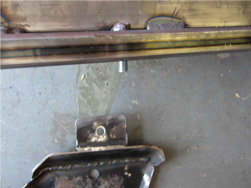

In case anyone finds this thread in the future and wants to try this I took some more photos of my cross member setup and have all the dimensions if needed.
Here is the rear cross member with the modified Trooper skidplate (before I painted them)

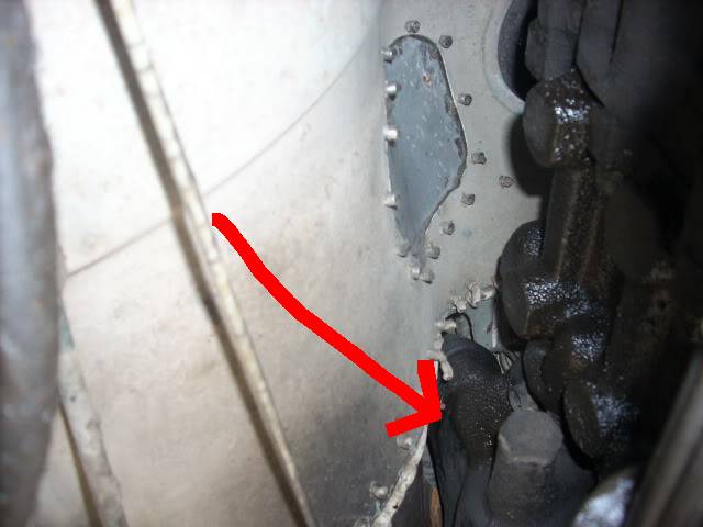

One other thing I noticed while installing the cab over the new 5 speed. If you have removed your cab as I did and you don't cut the new hole in the floor hump for the new rearward location of the 4 wheel drive shifter before installing the cab, the cab will not to sit down onto the frame. Not a huge deal, but I didn't bother looking at the underside of the floor before starting my cut, basically because I looked at the pics posted at the beginning of this thread by another member and the underside looked clean and open. However, my truck still has all of it's original fuel lines which are routed on the floor of the cab front to back (there are 3-4 of them in tandom) and you guessed it, they run right accross where you need to make the hole. First of all I didn't plan on permanantly removing them (now I need to make other plans), and second of all my sheet metal air nibbler wouldn't go through them. Red Arrow points to the area the fuel lines pass through.
Just a heads up for anyone else doing the swap.
