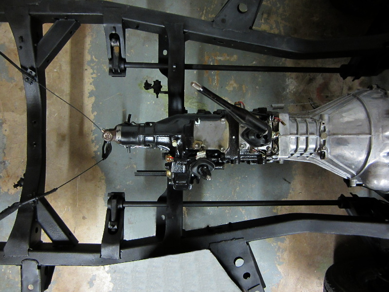

PostPosted: Mon May 30, 2011 6:07 pm
Posts: 157
Location: Spokane Washington
Here is the frame with the cab removed, I photo shopped the current cross member to show the proposed cut area. I plan to reuse the center portion for the E-brake mount as you did.
I marked the areas that I'm thinking need to be changed based on your photos and instruction. Does this look right? If so could you tell be the dimensions on your truck for "A" and "B" on my photos?

PostPosted: Wed Jun 01, 2011 8:38 pm
:esurprised Now thats cheating :ebiggrin as i did mine from under the truck but you got the plan just right but after cuting the cross member out install the trans/engine assy and bolt it in to make sure you can get the crossmember in just right. Also on the rear driveline be sure your truck is at ride hight when you start to measure and fit it.

Well I went back to the engine builder and had them swap the head for a 180 head (all fresh with new valves, etc.) and pushed the issue about the flywheel not working. They came up with a 6 bolt flywheel that accepts an 8.50" clutch (I don't know where they got it) and it all bolted up nice. Here's todays latest progress, the engine mounts are bolted up and I'm sorting out the final position of the trans before I make the mods to clear the transfer case and add the new trans mount cross member. I'm considering clearancing the current cross member without removing the center entirely (it's a tight fit, most will need to be cut away so it might not be possible without adding back some further reinforcements) and adding an extension bracket forward for the new mount location rather than an entirely new cross member in the forward location. I'll post results as soon as I have them.
