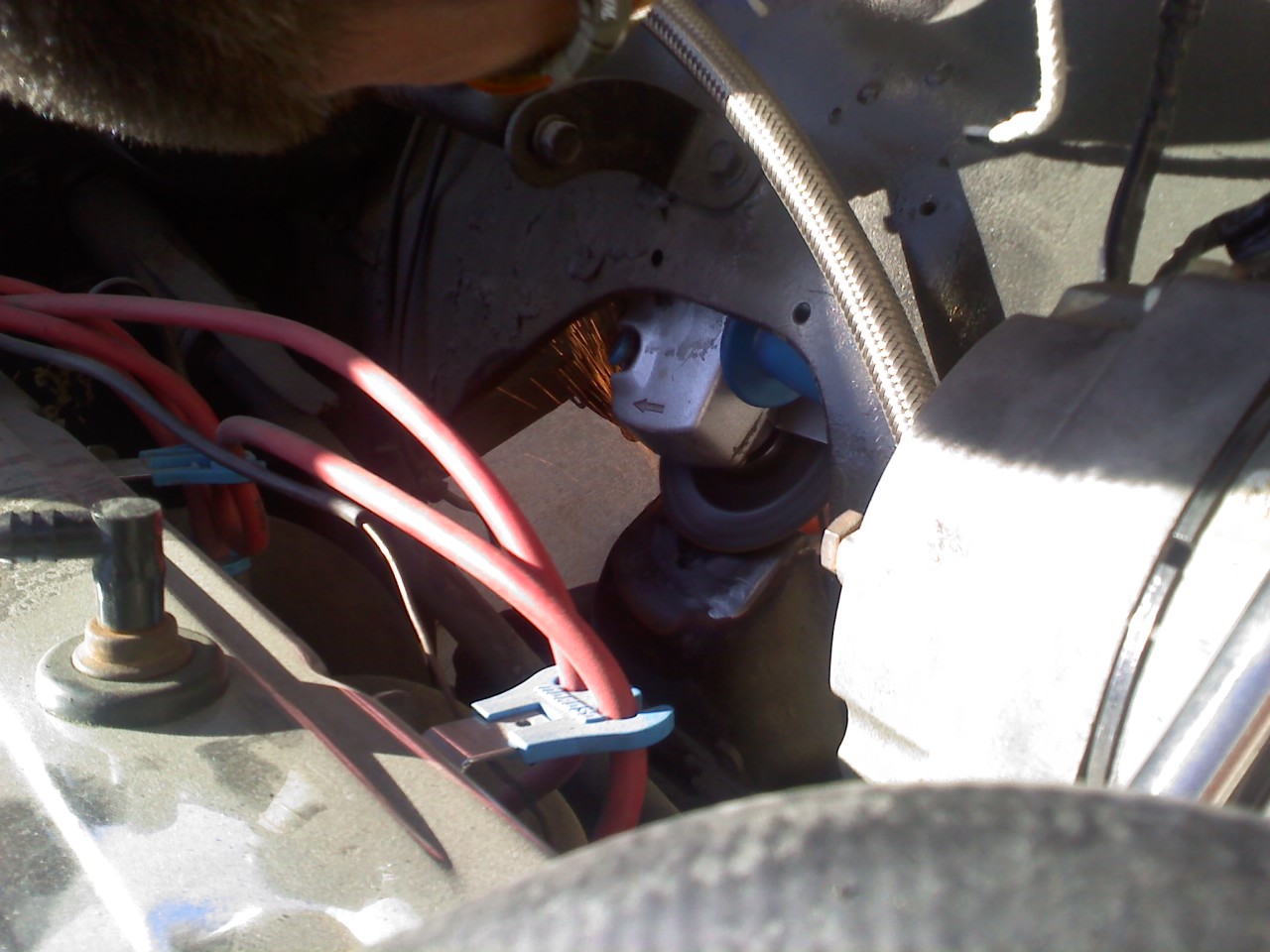

here is a start. I am going to make this as simple as poss even for the newbie.
1st put truck on jacks if you can use a lift.
you want to remove the torq bars first. there are 2 ways to remove them. The first is remove the bolt at the rear end of the bar. Make sure you soak it in some kind of penetrating spray and alot of it let it soak for a couple of days you will thank me for that. Next remove bolt it is a 22mm. You will have to use a breaker bar I did. Once you have to remove the cotter pin holding it in. From that point it is suppose to slide out yah right. If it doesnt come out there are 2 bolts a 17mm and a 14mm on the lower control arm that you can remove and the whole assembly will come out with a few hard hits with a brass hammer. Once you have it out and you had to do it the hard way make sure you remove the bar from the front mount and replace the mount back into the lower arm. That piece holds a bolt in that keeps your lower arm on.
Remove your front shocks.
Next you will need 14 inches of mild steel flat stock I used 3/8 inch. You will cut this stock into four pieces 2 will be 3 inchs long and the other 2 will be 3 1/4 inches long.
Now remove the bolt that holds the upper and lower together on the spindal ball joint top side. Use a pickle fork to seperate. From there you can start your fab work. you can see if you put your coilover in that the top stud doesnt fit in cause of the spring. So we need to relocate it. The bottom NEVER has to be touched. Now take the 4 pieces of flat stock you will need a 3 inch and a 31/4 inch for each side clean them up for welding. Tac them one on top of the original mount and one under the mount to make a sandwich of the factory mount. Once tacked in then mark where you want your stud hole to be I went 1/2 inch off the edge of the factory mount. I drilled 1/2 inch holes in my flat stock. Now go back retack them back into the spot and do a test fit of the coilover. Don't be alarmed if the spring hits the upper A Arm it will. (Once it is in and done and on the ground holding weight it will clear by 1/2 inch all the way around.) Now the fun park welding it all up I recommed a 220 mig welder not a 110 volt wont get hot enough. In my video i use a 110 volt but mine has been modified with 220 caps in it for extra power and heat. Now that you have it tacked in place and like the way she looks go ahead and weld up the flat stock to the original mount I over weld so every spot on my is welding don't forget about the bottom inside piece to weld. Do the lower piece first so you can weld up the factory hole to the lower piece for added strenght. once it is all welded together you can now paint it so no rust. Put your coilover in and set your ride height with the spring. Once you have done that you can drop your upper A arm back into its spot and rebolt it back together. Put your tires on set it down and check your ride height out and adjust if needed. I used 10 inch 250 pound springs from qa1 and my shocks are qa1's. this was the easiest mod I have done so far on my truck. Took me a weekend and a case of beer. any questions pm me there is a video coming out on this hoping by weeks end on you tube will keep you posted
File comment: weld the factory hole for added strenght
File comment: this is what i mean by sandwich
File comment: what you start with

more pics
File comment: make sure you grind the weld smooth before you add top piece
File comment: final look

another pic
File comment: as you can see spring almost hit before she is settign on the ground on her own weight. then she clears by 1/2 inch or better

Looks like you might have gotten a little carried away tightening up the top nut for the shock...to much pressure will cause that rubber to crack and bust way too soon
 Post subject: Re: coilovers
PostPosted: Tue Apr 10, 2012 11:13 pm
Posts: 190
Location: Prescott Valley Az
those are the old rubber pieces we used them to mock everything up to make sure everything went in right. we took them off and put the new ones in. the new ones are about a inch thicker.
